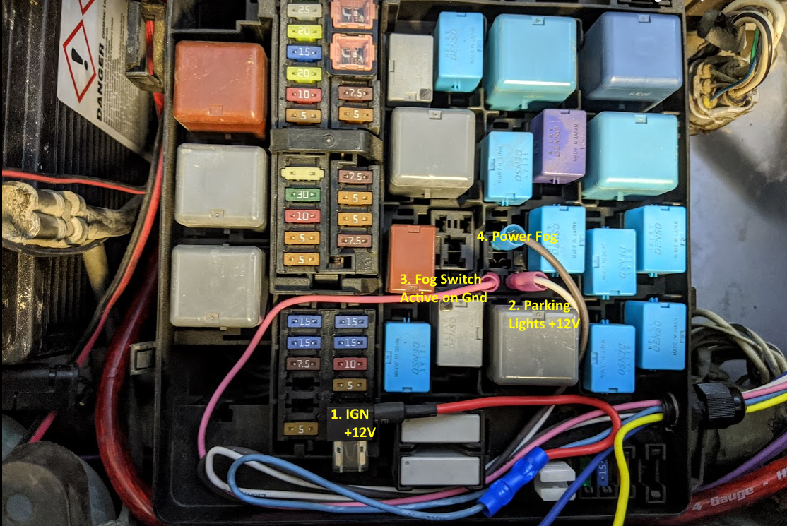

The pics in this thread might help you localize where the relay is ( was at 4. )
Lots of people have installed these but I couldn't find a good reference as to where to tap for various things underhood. Here's my attempt to document some of the more common taps and triggers. Including a much wanted stock fog light override function.
I'm using a 1/4" gland fitting to route wires into the fuse box. Working well in the location nearest to where I've mounted the Switchpros vertically on the inner fender behind this box.
I only used a few of the following tap points, and I'm happy to help consolidate points others may have used as a reference.
1) Ignition switched +12V trigger
2) Parking light switched +12V trigger
3) Fog stalk switch, active on Gnd
4) Power Fog lights directly +12V
Additional tap references
5) Backup light trigger, here, and here

In the thread referenced in my post back on #13, this picture should help. You can use some thin strands of wire and pinch it into the relay so you can reference it in action with the voltmeter. 4. Power Fog should be the pin your looking to see that comes on.
