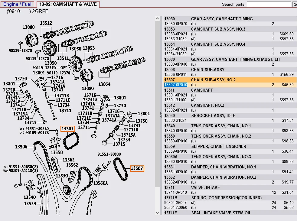

Now at week 6 of the Highlander being at the garage (they say it will done next week), we learn that it wasn't the main timing chain that broke. It was one of the two smaller chains. I assume this still means that the interference damage can still occur, but would be limited to one cam and three cylinders (6 valves out of 24).
yep, now you would just be looking at potentially 1 head, 3 pistons and up to 12 valves vs a new motor. i dont think that you would need new cams but they would both have to be assessed for damage as you would have most likely had 1 cyl open on the intake and one on the exhaust on that bank
