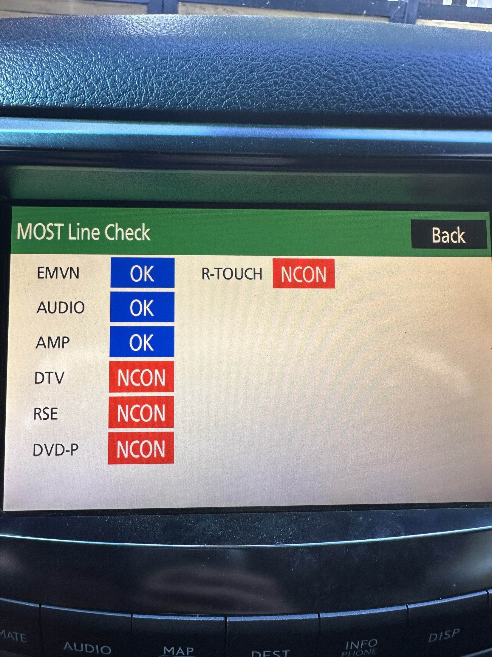

Update: the DVD monitor was indeed broken. I shipped it off first to a repair facility in Atlanta, who quoted me $1400. I asked for it to be returned. I had already received a quote from Supertech in Australia for far less. $750 AUD, which works well with the exchange rate to USD. So I shipped it to them instead. They evaluated it and contacted me while I was out on vacation saying they confirmed it was damaged internally and it was something they could fix, so when I returned I called them up and made payment, and it just arrived yesterday. Everything works as it should again. Another member here saw the discussion and sent me his remote from his 2013, which doesn't function 100% on my 2011, but does have enough crossover to get a movie going, so I now have more functionality than when I started. Thanks @mexalpix
Hi Folks, my stereo stopped working so I went into the diagnostic menu and saw that rses was ncon, I cleared the codes, checked again and now there is more output, dvd, dtv, r-touch were not there before, and rses has changed to rse, anyone have thoughts here on whether it could be isolated to the rear unit?
I sent mine to United Radio, they have lost the connector to the RES and can no longer test or repair these units.
Supertech also wants me to send the "rear module" back to them as well, i cannot find evidence of a rear module in a 2011, there is a module under the passenger seat that might be what they are after, does anyone have documentation on the components of the system?
Hey sorry, this may be too late but the rear module is just the roof mounted screen assembly. That’s what I sent to them.

Hi Folks, my stereo stopped working so I went into the diagnostic menu and saw that rses was ncon, I cleared the codes, checked again and now there is more output, dvd, dtv, r-touch were not there before, and rses has changed to rse, anyone have thoughts here on whether it could be isolated to the rear unit? View attachment 3666158
Hey, sorry to revive this old problem of yours. I had the exact same thing happen to my 200 series, has anyone figured out why this happens? Im going nuts
