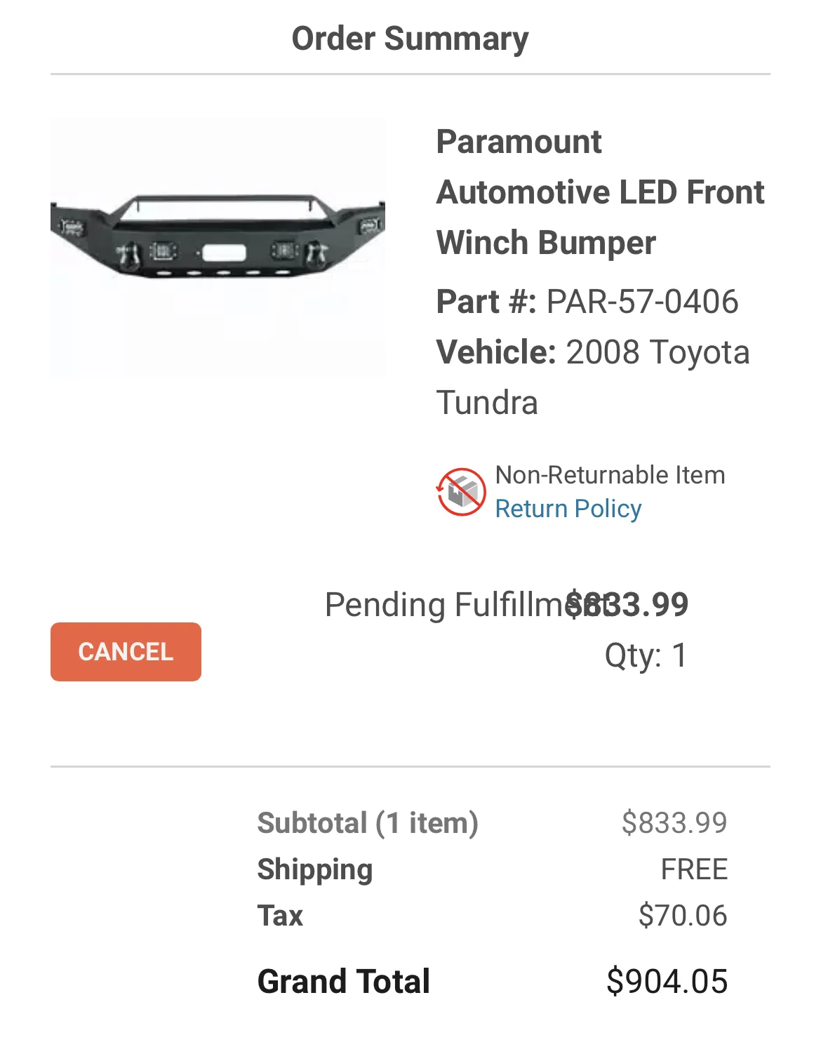

Please update if you get any aftermarket bumpers on. I would love a ranch hand style front bumper but haven't really seen one that I like (not many out there either).
The only one that I know that is Sequoia specific is Tandem. I believe all the other ones are Tundra specific but will work on the Sequoia. That said, I will most likely get the Tandem Off-road. I’d like to get the rear first as I really want to get stuff off my roof.
I just bought this, it’s Tundra specific, but it’ll fit:
