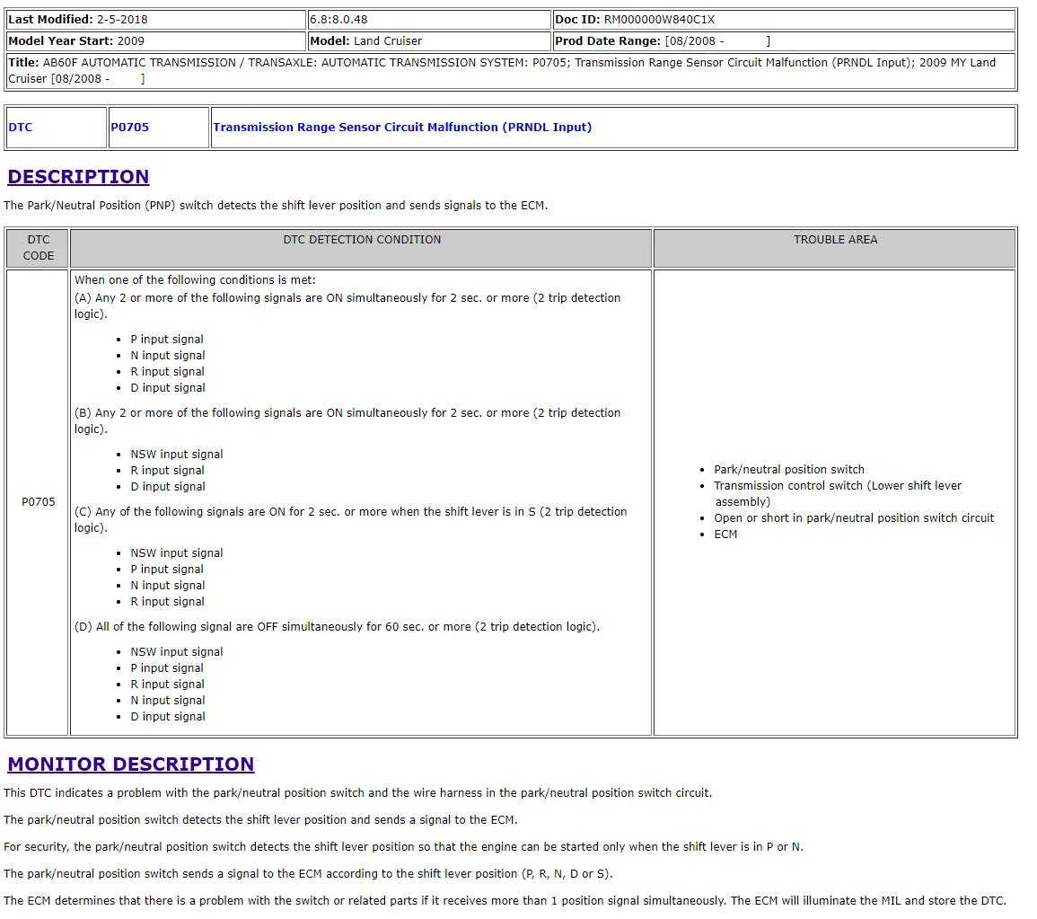

Check VSC System light intermittently came on. Toyota replaced the neutral safety switch and 30 miles later Check VSC System light came back on and was told to take it to a transmission shop. Now, transmission shop says I need a transmission overhaul/rebuild. Has anyone ever heard of a Land Cruiser transmission dying this early? The error was a P0705.

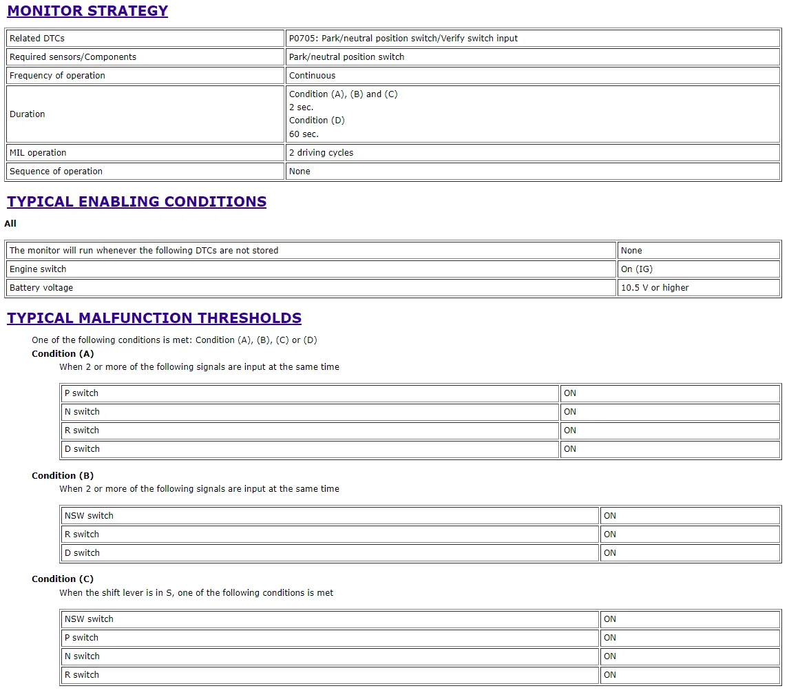

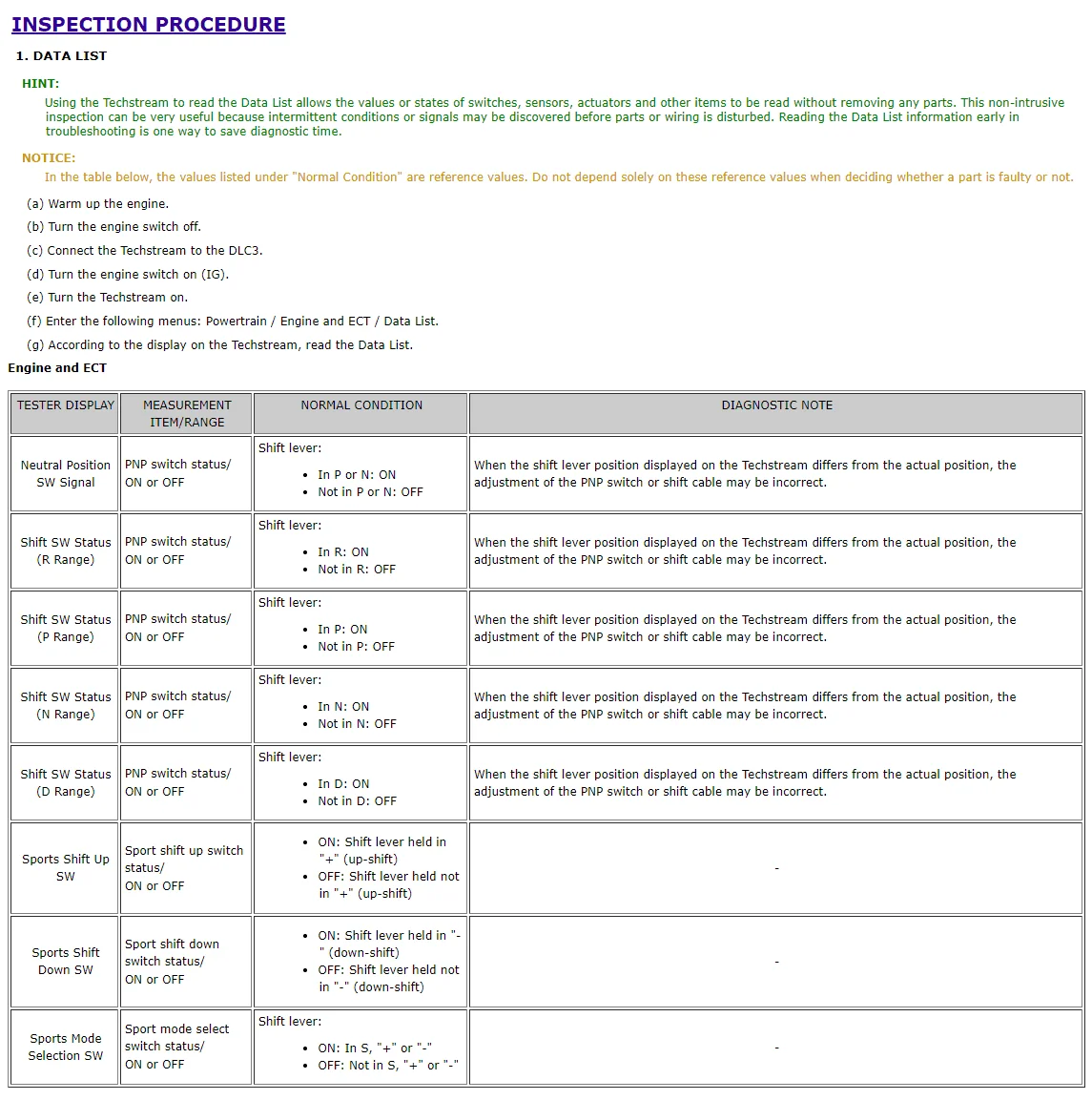

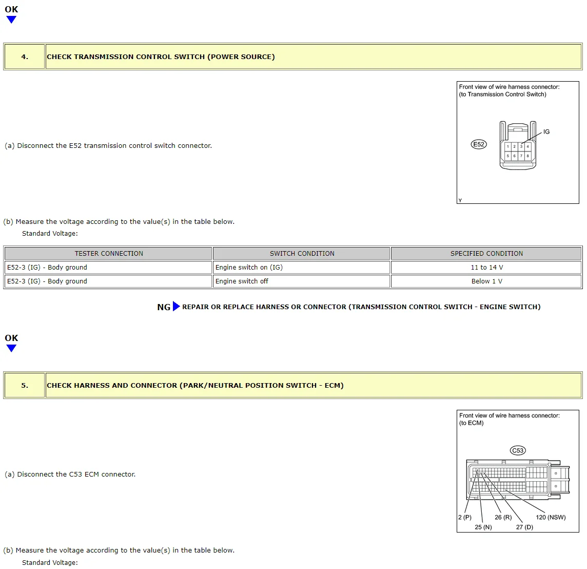

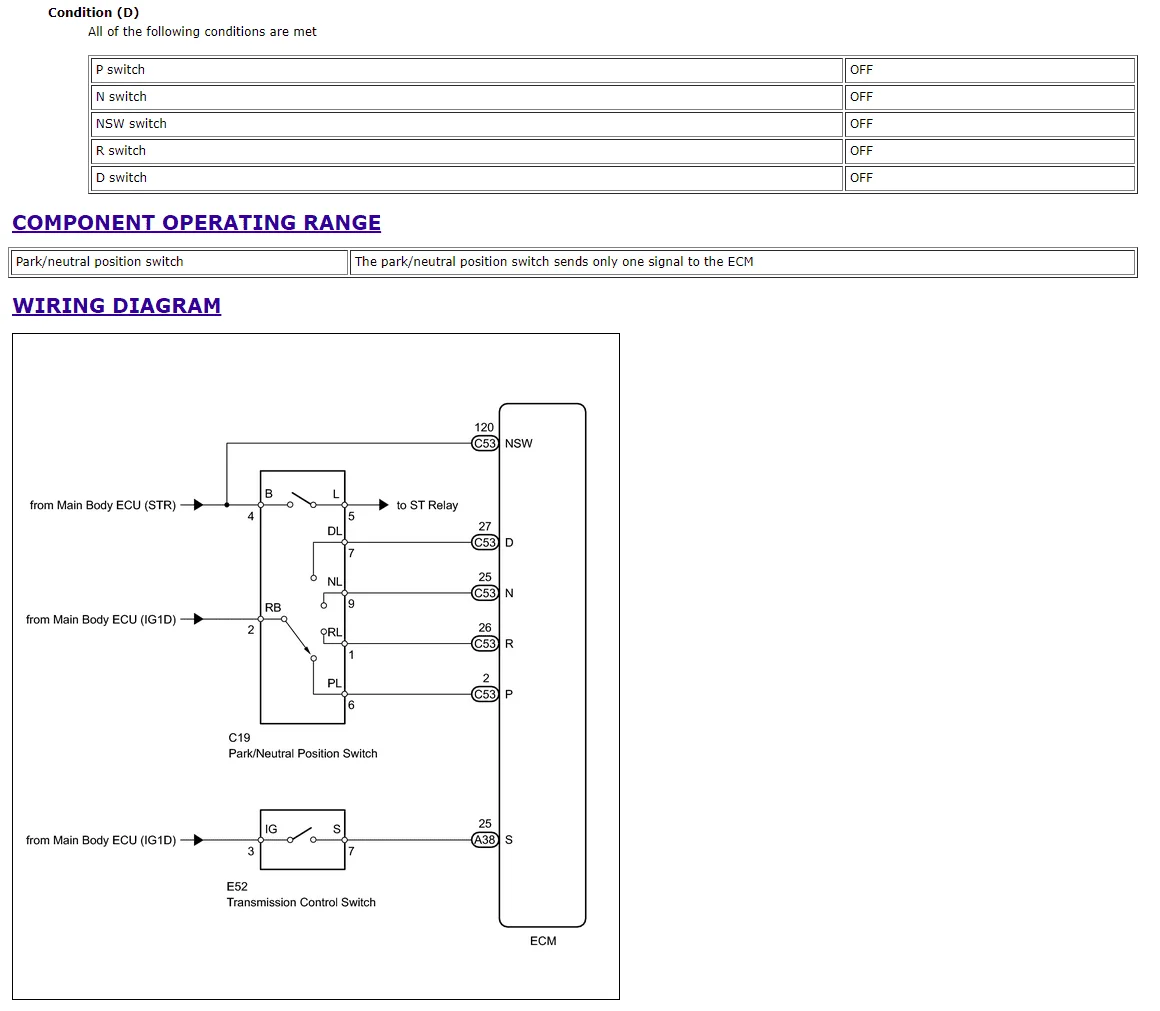

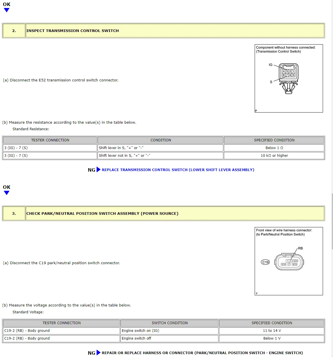

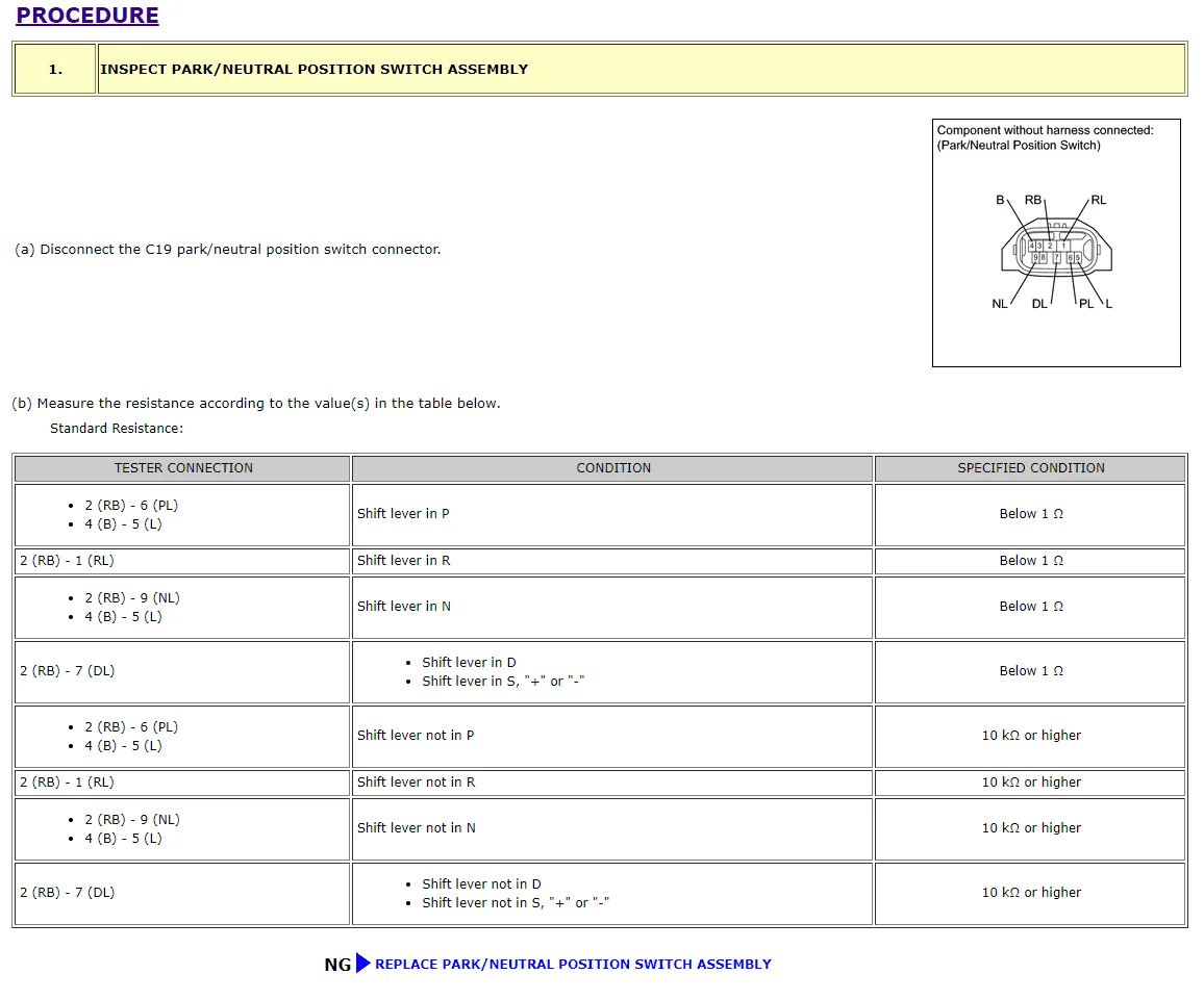

Ok so those 2 posts are from the Toyota diagnostics FSM for your 2009. I can't say that you don't need a new transmission, but IMO given the only symptom described so far is a CEL, it seems far more likely there's something else wrong. I suggest having a competent mechanic go through the above procedure before dropping five grand. The "worst case" scenario above is a new ECM, NOT a new transmission. 200-series transmission failures are pretty rare, aside from a few issues when the 8-speed was first introduced in 2016.
That said I am not a mechanic and you don't say if you've had any other issues aside from the CEL, if you're the original owner, any other repairs (accidents, windshield replacement, etc). There's a chance it's something else, like a mouse that's chewed through some wire insulation which is causing occasional shorting to ground, or water dripping inside the vehicle from a poor windshield seal that's caused corrosion on a wiring harness connector.

Shouldn't the Toyota dealer be able to go through the above procedure? And not say "take it to a transmission shop".
Was the water properly drained from under the carpets? There are harness connectors near both driver and front passenger feet that can corrode from water trapped there. Thing is, most if not all transmission wiring doesn’t go through that area.. it is in the engine harness that goes through the firewall directly into the ECU (with built-in TCM) mounted on said firewall. Still, these systems are complex and other wires could definitely contribute.
I agree with @linuxgod find a competent mechanic to go through the above procedures. It’s just too coincidental for the inside of the truck getting wet IMO, and getting all that water out should have been a priority. Btw it is very easy to pull the door sill trim and look for water. Just pull up. If water remains it’ll be toward the front with your wiring harnesses lying in it.

I would follow the FSM and dig deeper. Lots of folks shoot from the hip nowadays and its just going to cost you.
Did the shifter/center console get wet from the rain? I’ve seen spilled coffee do some stuff. Do you have access to techstream? Maybe you can take a look at Data List/Parameters if they are listed. Its been a while for me. Somewhere down the line theres a discrepancy.

I told the guy at the transmission shop to hold back while I wrap my head about a transmission rebuild. I do no have access to techstream. It's a $500 transmission diagnostic fee if I don't move forward, which is a little over 10% of the total cost. At this point, it looks like I'll eat that cost and take it to someone else for a second opinion. I could be in the 0.01 of the population of LC's with 108k miles - I can't find a single thing online that supports this anomaly - to require a rebuild and will happily eat that to know that it's the correct diagnosis.

I’ll bet that linuxgod’s posts with the factory procedure for that error code has the best chance of success.
