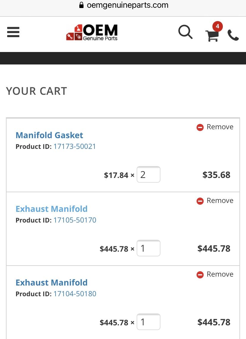

Thanks for the update. I'm getting both P0420 and P0430 appearing constantly for the last few months. Clearing the codes only lasts 20 to 40 miles.
My code reader only tells me that it's bank 1 for P0420 and bank 2 for P0430, but not which sensor.
Since I replaced the pair of downstream sensors 4 years ago, I'm going to replace the pair of original (18 year old) upstream sensors this time around with Denso ones from RockAuto.
Best case scenario, the upstream sensors fix my issue so I can pass the smog test coming up in a month or two.
Worse case scenario I need to replace the upstream cats at God-knows what price. Parts seem to range from $450 to $650 each depending on web site and if toyota or lexus brand. So, I figure pray and hope the cheap parts fix the issue.
Anyone know if these are the right part numbers?
17105-50170, Cat Converter with Integrated Manifold (Left = Drivers side in USA)
17104-50180, Cat Converter with Integrated Manifold (Right = Passenger side in USA)
Parts seem to be cheaper if I buy for Toyota 4Runner 8-cyl than Lexus GX470, but only like $40 cheaper each.

Hmmmm, my buddy's invoice shows 17150-50050 as the "left side catalyst" manifold assembly.
Also:
17198-50010 for manifold gasket
90080-43036 for exhaust pipe gasket
90080-17187 nut, lock (x8 pieces)

Thanks for posting the part numbers for the 2009 gx470. I have a 2003 and it looks like 2003-2004 use a different part number for the integrated cats than the 2006-2009
