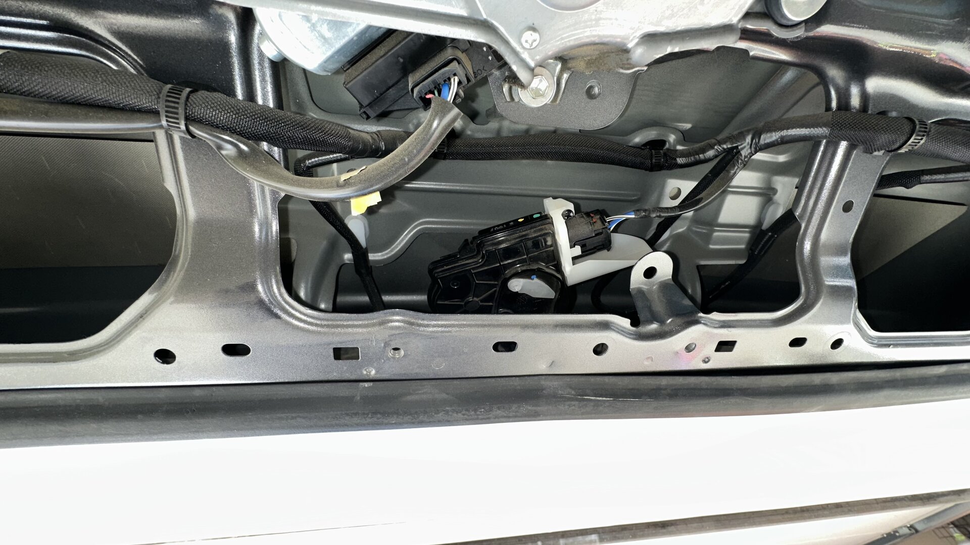

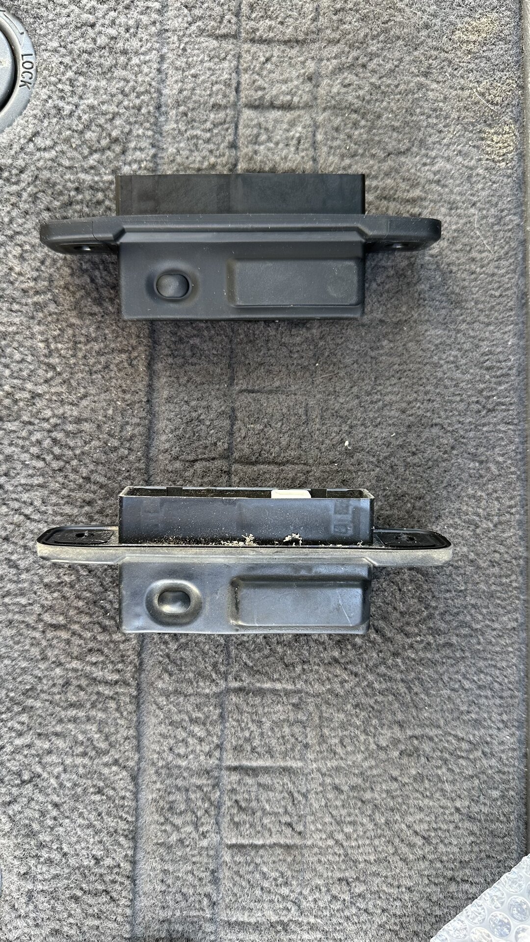

How to fix upper rear hatch not opening
Finally able to get to work on fixing the rear hatch. I ordered Back Door Switch Assy. PN 84840-28040 from my local dealership.
everything was relatively straight forward.
The rear hatch was not opening so I crawled inside. with a tiny screwdriver I pulled the plastic square cover off. inside there is a white piece of plastic that is being held on with a screw. I removed the being gentle to not drop the screw. I stuck my small screw driver in pushed to the right unlocking the rear hatch and pushing it forward to open it up. I used a vt-30 torques to unscrew the 2 bolts that are holding the switch. pulled out the switch unplugging the wire gently. replaced the new one. I immediately heard the switch make a sound.
The process to put everything was a little different since I kept dropping the small screw that holds the white plastic piece in the inside of the hatch. What I ended up doing is remove the plastic trimming around the hatch. Used and small screw driver since I couldn't find my plastic prying tools. Pulled all around the outer edge until all the plastic trimming came off. Using a small screwdriver I pushed through one of the holes that's on the hatch and it was a near perfect spot to reach in and screw in the screw. Pushed all the plastic trimmings back in. Closed everything up and crossed my fingers. To my satisfaction everything worked again. Such a nice relief.
I will post pictures for anyone that has to go through this, now that these land cruisers are getting up there in age. The problem might start becoming more frequent.
This was for my 2008 Land Cruiser.

Sounds to me like the switch is dying. Mine worked always, then mostly, then sometimes, then none.
FIXED!! You were right @Goldbug. It was indeed the switch. Worked, mostly, sometimes, partially, then nothing. Had ordered a new switch assembly last week; arrived yesterday. as @dualcabhj75 mentioned and pictured above ($62; free ship); followed the great instructions and pictures, and in just under 20 minutes, we are back in action! (minus one broken panel clip). This is what this forum is all about. People helping people. @dualcabhj75 Thank you again for your thorough explanation and pics.
