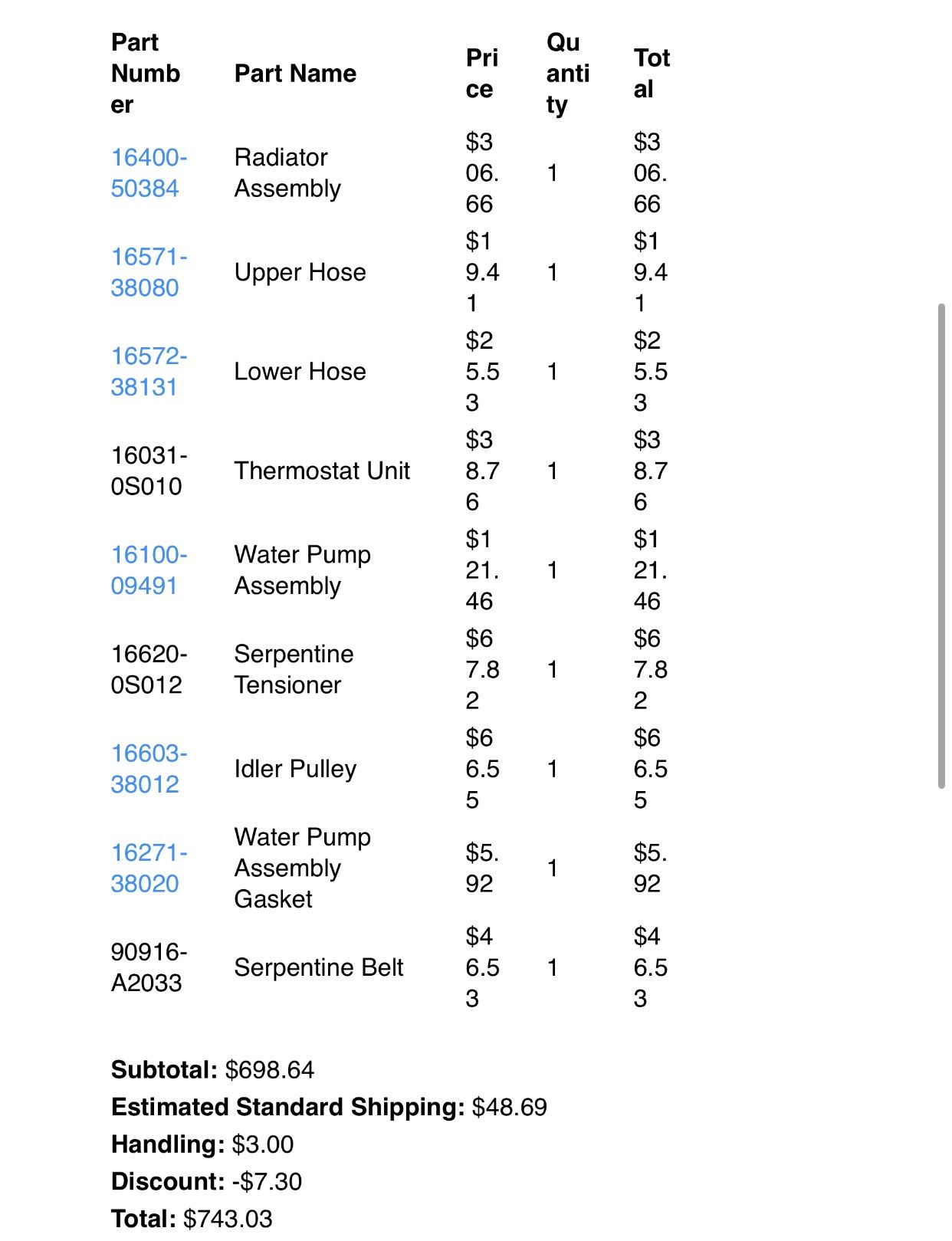

Quick install tip:
I used camelback toyota and ordered online. I wanted to use all oem parts. There prices are decent and have quick shipping to CA. Here’s my order list minus the thermostat housing gasket.
Compiling a parts list for future replacement... anyone have the Thermostat housing gasket part number?
Or... is that not being replaced when doing the water pump/thermostat?
Here's a table you can copy/paste from...
ItemPN
Radiator16400-50384
Upper hose16571-38080
Lower hose16572-38131
Thermostat16031-0S010
Water pump16100-09491
Serp tensioner16620-0S012
Idler pulley16603-38012
Water P Gasket (Apparently not needed... WP comes with a gasket...)16271-38020 (Comes w WP)
Serp belt90916-A2033
Thermostat housing gasketComes with T-Stat
Fan support bearing16380-0S010
Fan Clutch - 16210-38071
Pulley, Fan - 16371-38010
In addition to this list I'd suggest adding #1 and #3 water by-pass hoses.
#1 - 16261-0S030 (removed to replace water pump and access thermostat)
#3 - 16267-0S030 (removed to replace water pump, technically just 'detached', but it's way easier to loosen the heater T hard pipe to get slack and just pull this little elbow off)
Updated the list as I just found out the WP comes with a WP gasket... Anyone need a WP gasket, let me know
