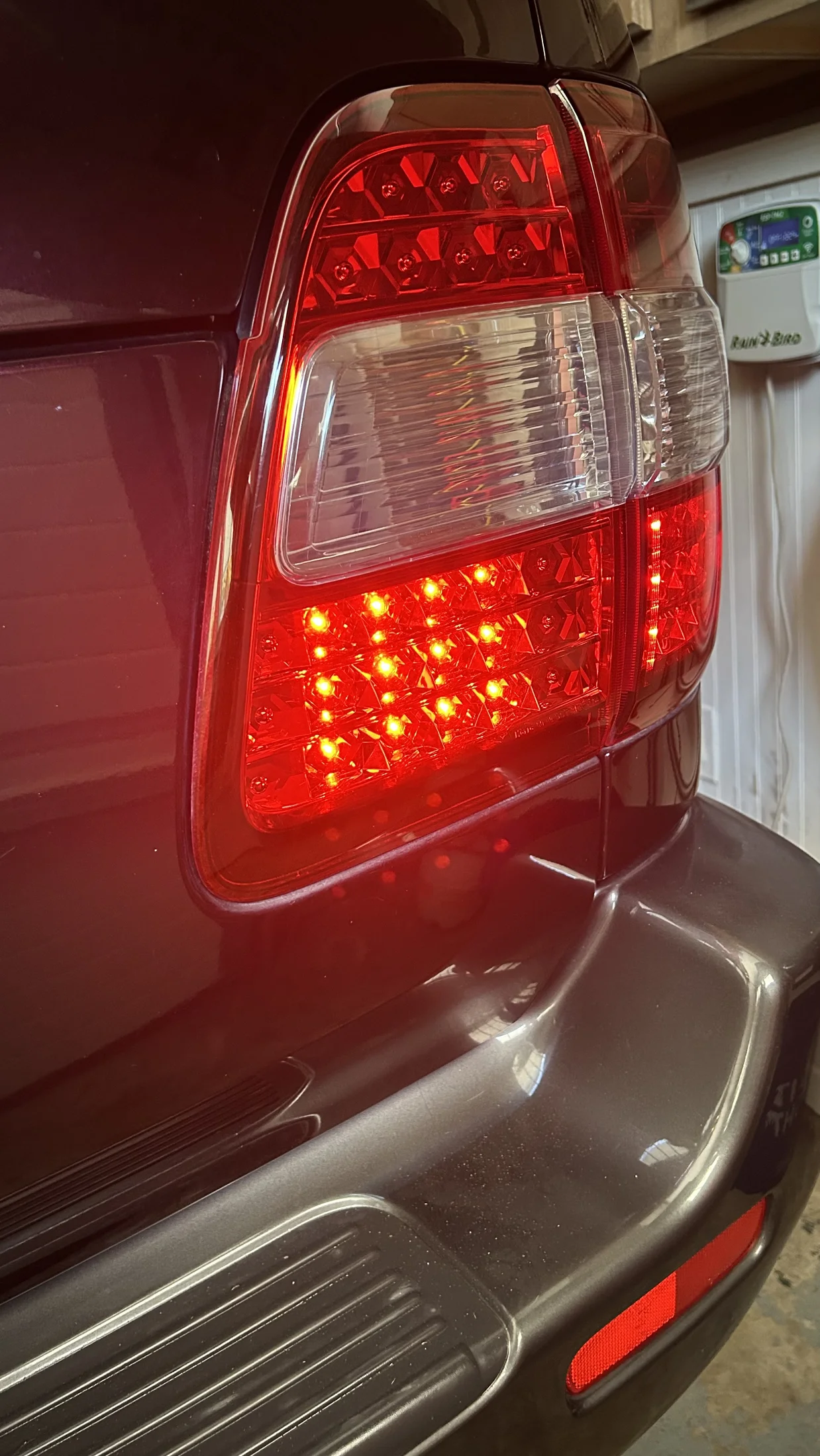

With headlights on:
Also, why would Toyota engineers use only the small corner light for the brake lights?

The brake lights only being in the small corner is what got me thinking. The other night, I let my wife drive the cruiser home while I followed in another car. I thought it was odd how little of the taillight was in use. The next morning I looked at it up close in the daylight and that led me to here. I'm glad that I'm not the only one seeing this behavior and so maybe it is factory. Or we have bad luck and its time for new taillights.
The only thing I didn't try was reverse, so I just did it now while I'm out here in the garage and still nothing. Hopefully someone else can tell us whether or not we owe more money to partsouq/toyotapartsdeal. Fingers crossed we don't!
It's just that inside / upper section that seems "dead." The outside / upper is the hazards... exclusively
Yes, mine behave the same. And that inside / upper section appears to have LEDs in there like the two bottom sections, which is why I'm even more confused.

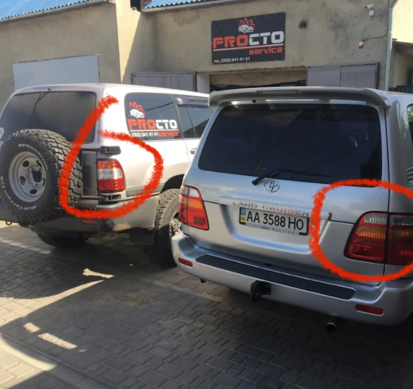

The upper part does not illuminate at all. Also remember that models with ambulance doors or factory rear-mounted spare tires don’t have the tailgate lamps.
So, the entirety of required rear lighting is handled by the corner lamps.

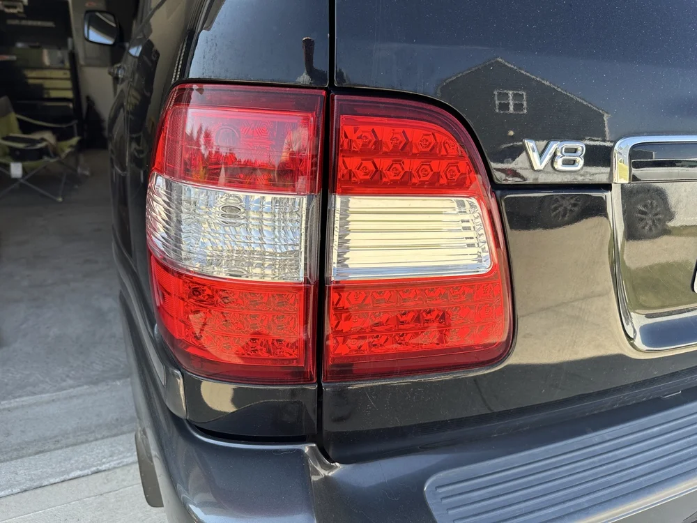

Can confirm the tailgate upper sections do not have LEDs in 06/07. Just for aesthetics. Definitely odd but both mine are the same.

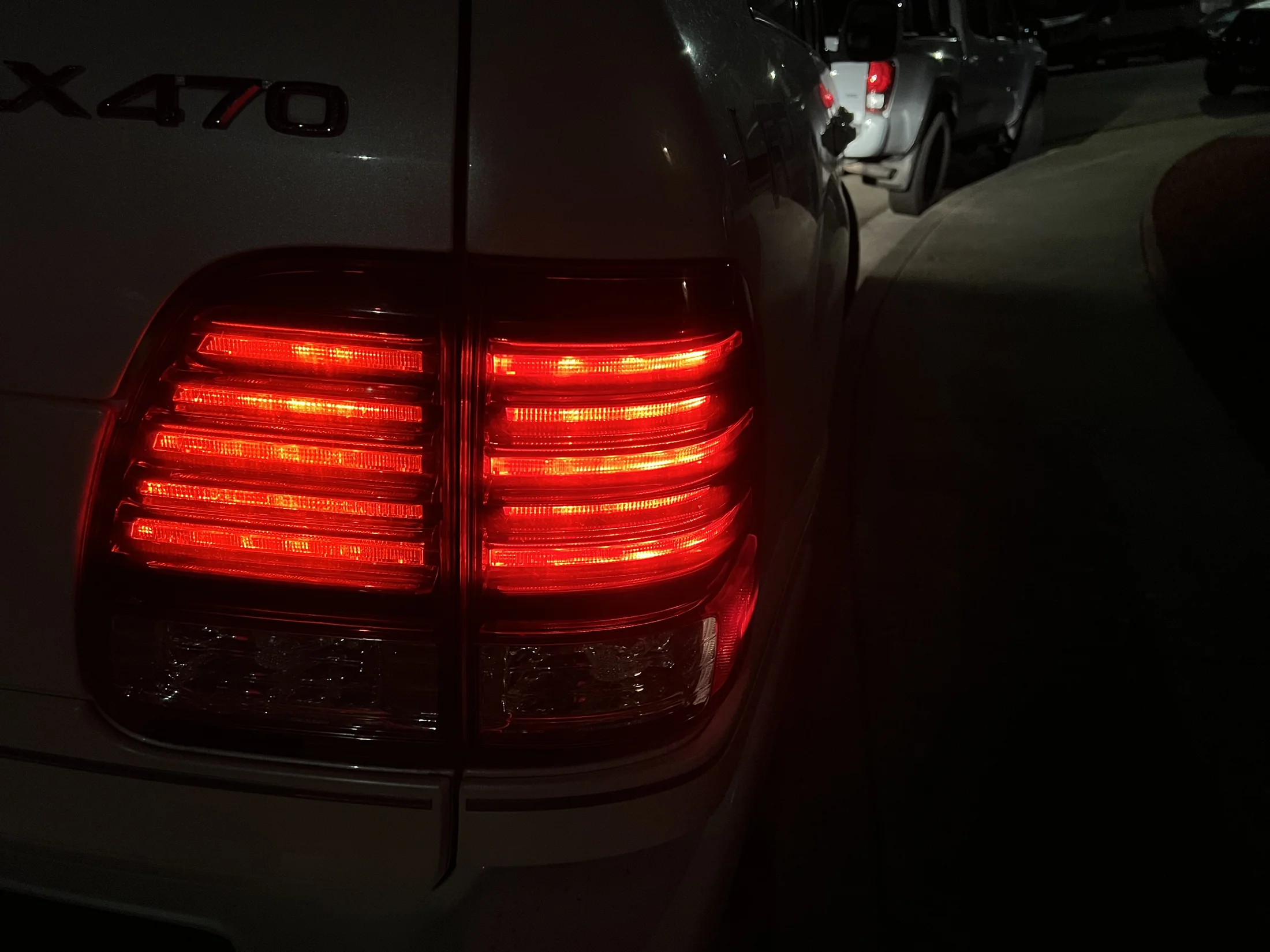

I must be getting old. Never realized that LC and LX tails were different. LX's tails use an entire light:
