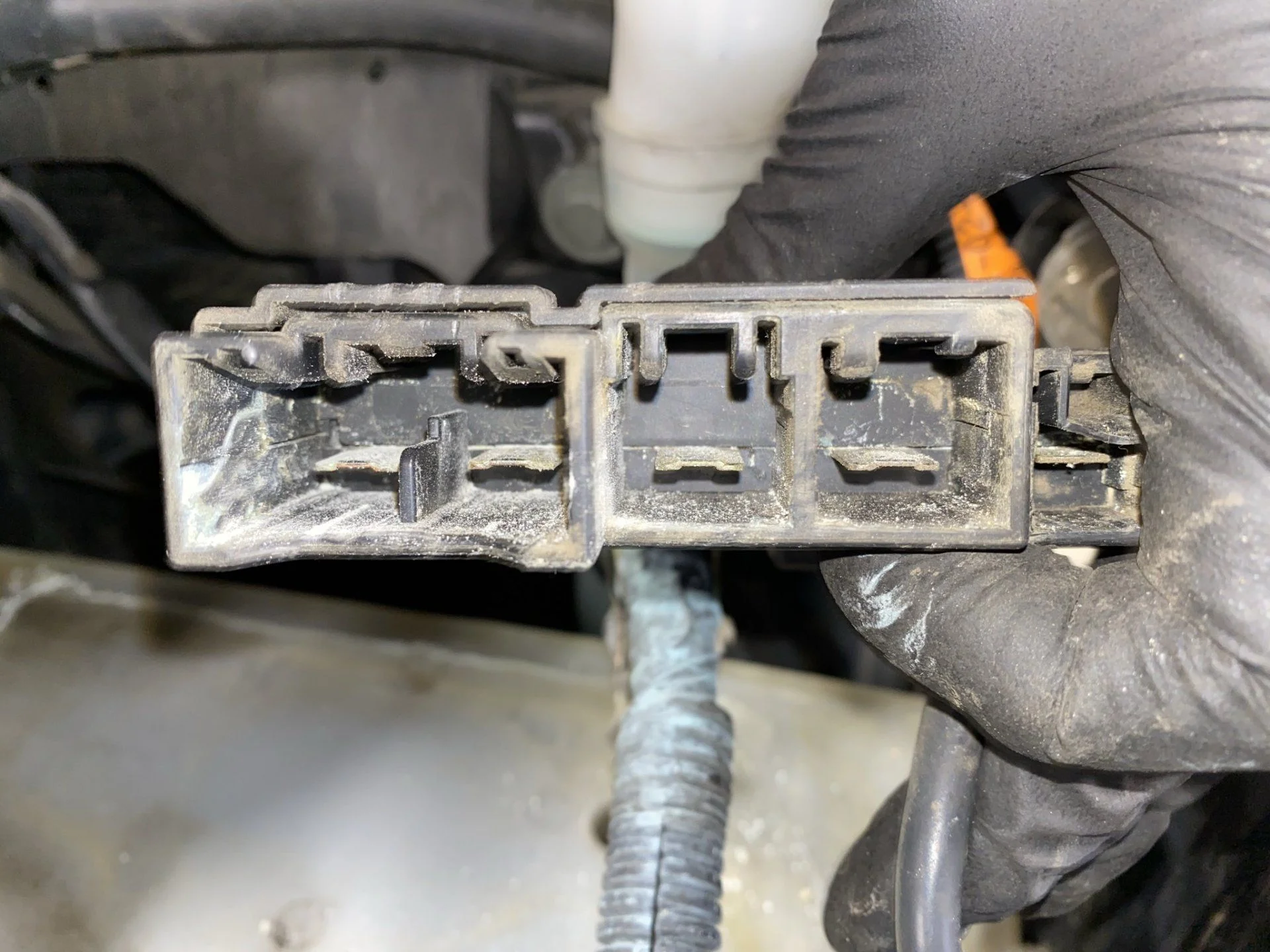

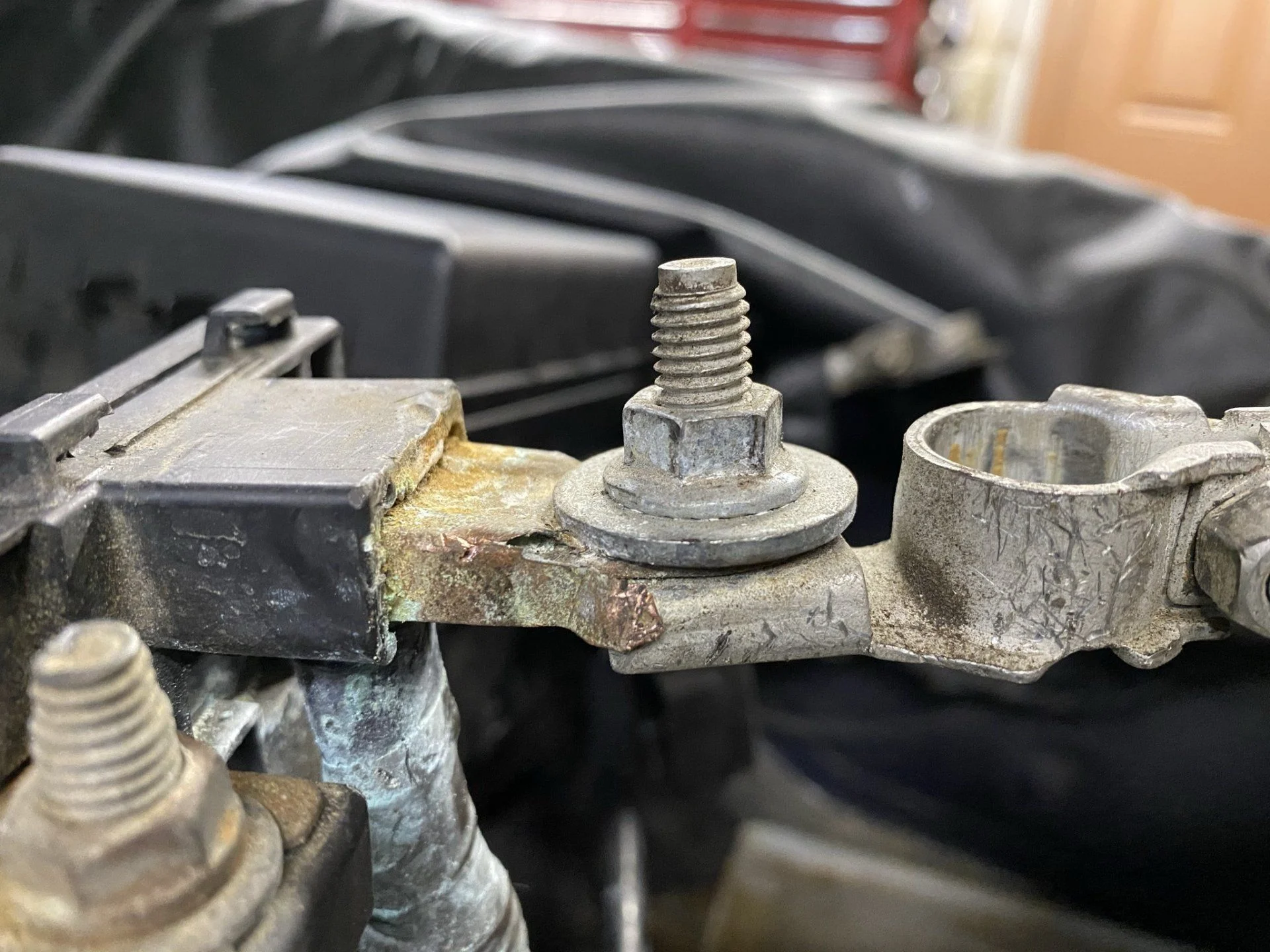

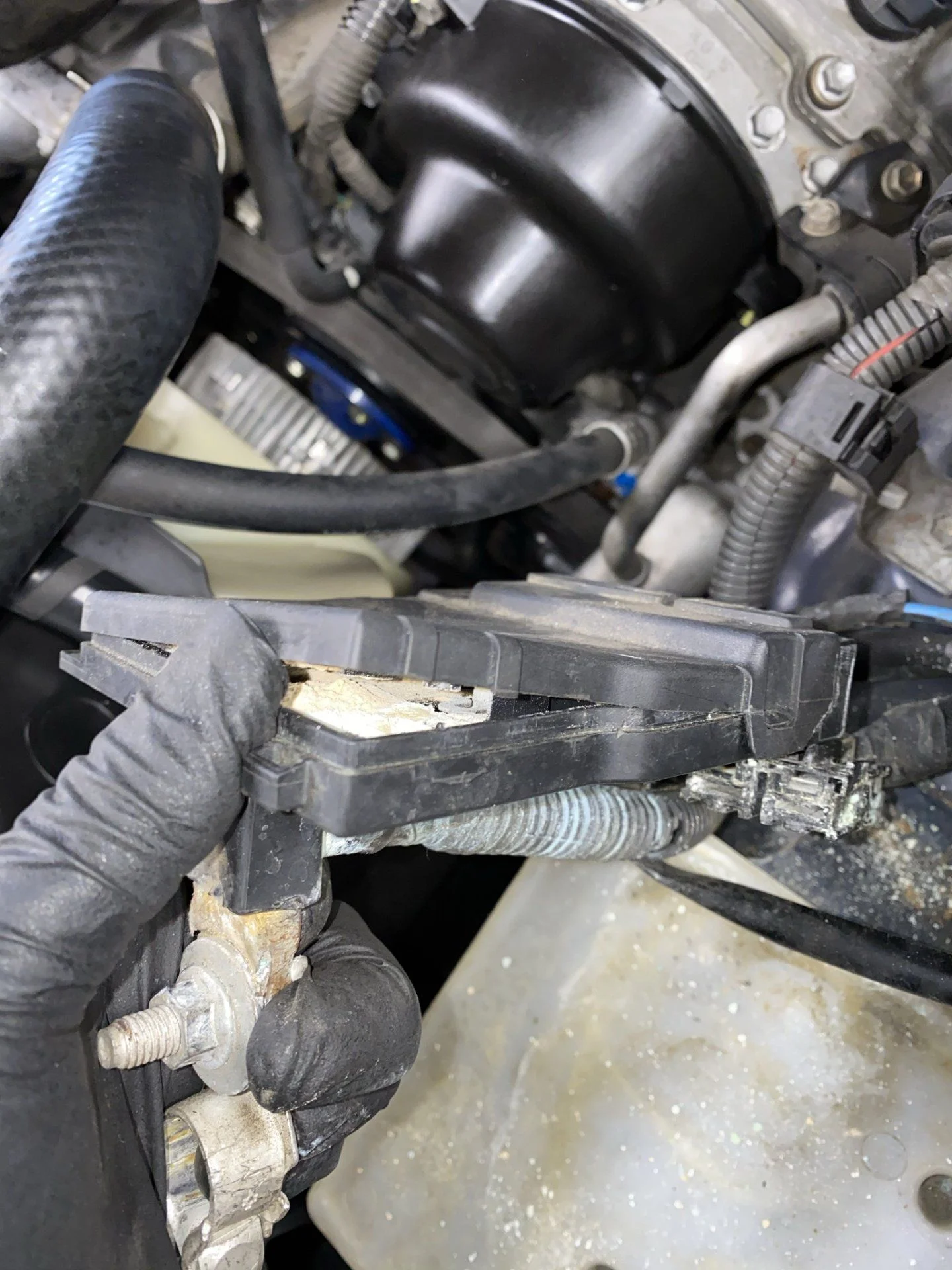

Battery, have limited useful life.
As vehicle sits, battery lose charge. Also if headlight switch left in auto, it draws power/charge from battery. (see owners manual)
Batteries need regular servicing:
Batteries post and clamps need cleaning. I use baking soda and water to first clean white crusty (acid). Baking soda neutralizer acid. I also clean post along with clamp and grease with white lithium grease.
The battery terminal block may also need clean or replacing.
Years of neglect damaged below terminal & block. Someone replace positive terminal clamp, but stop short of replacing terminal block or properly cleaning. Now resistance has built-up in terminals, inhibiting alternators ability to charge. If battery not fully charged or keep stored at full charge, they sulfate. Then they will not accept a full charge.
Someone added a large washer with new terminal, trying to make-up surface area of copper that acid ate away. Now 3 battery in a row have gone bad in 2 years.
Terminal block is full of acid, from years of not service battery. Damage is now to far along for cleaning. Replacement is needed

Thank you for this info! The battery is new but cleaning the terminals and replacing if damaged is something I’ll look at when I get home.
