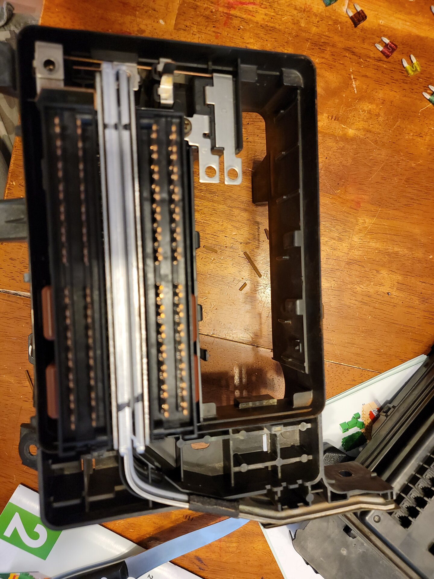

Plan is to carefully cut off the relay without stressing the board/contacts under it.
It's off.
Tough little guy. Cutting the pins from inside the relay hoping to free it from the board.
More struggling... seems like post limit is 5 pics. Hopefully I can make consecutive posts without issues.
It's out.

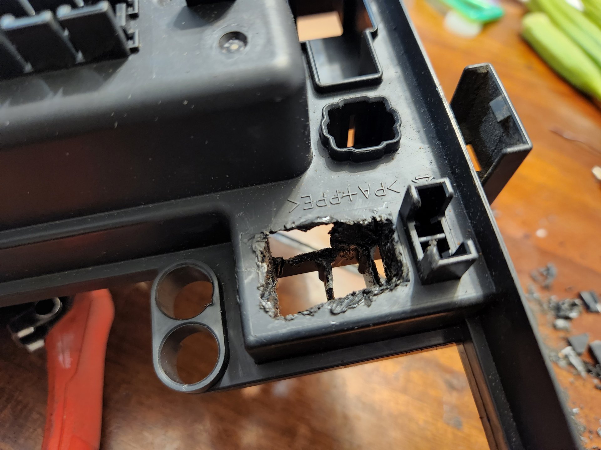

And... couldn't find an attachment narrow enough to make clean cuts. Resorted to heating a small knife and melting out a hole.

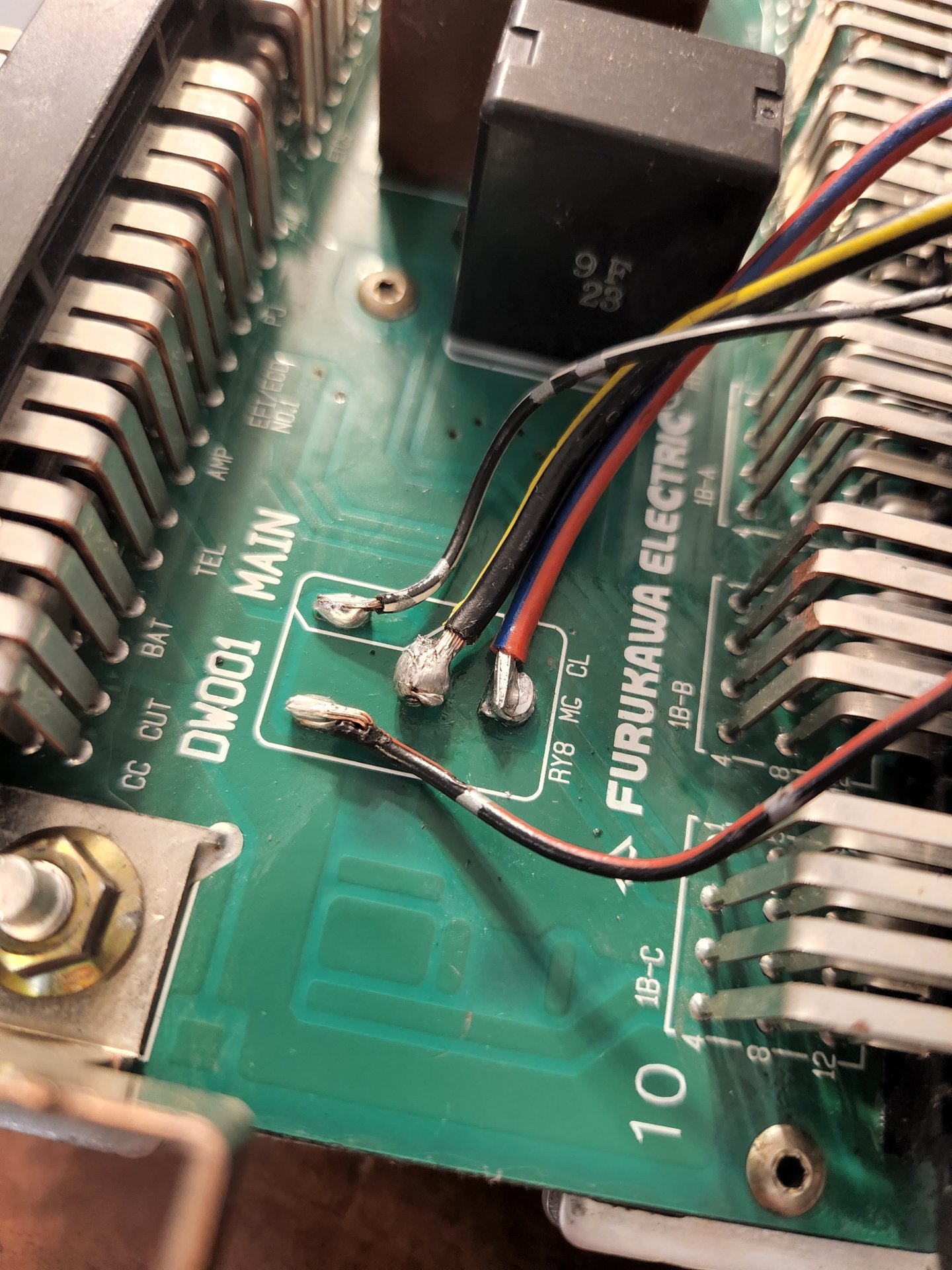

Adding some flux and solder to the contacts on the board.
Soldering the pigtail wires from the relay holder, matching each pin to the relay's orientation. Cleaned up the flux after with alcohol and an old toothbrush. Not the best soldering skills. Having a weak soldering iron didn't help.
More hot knife welding...ugly but it'll have to do.
Routing wires through here.

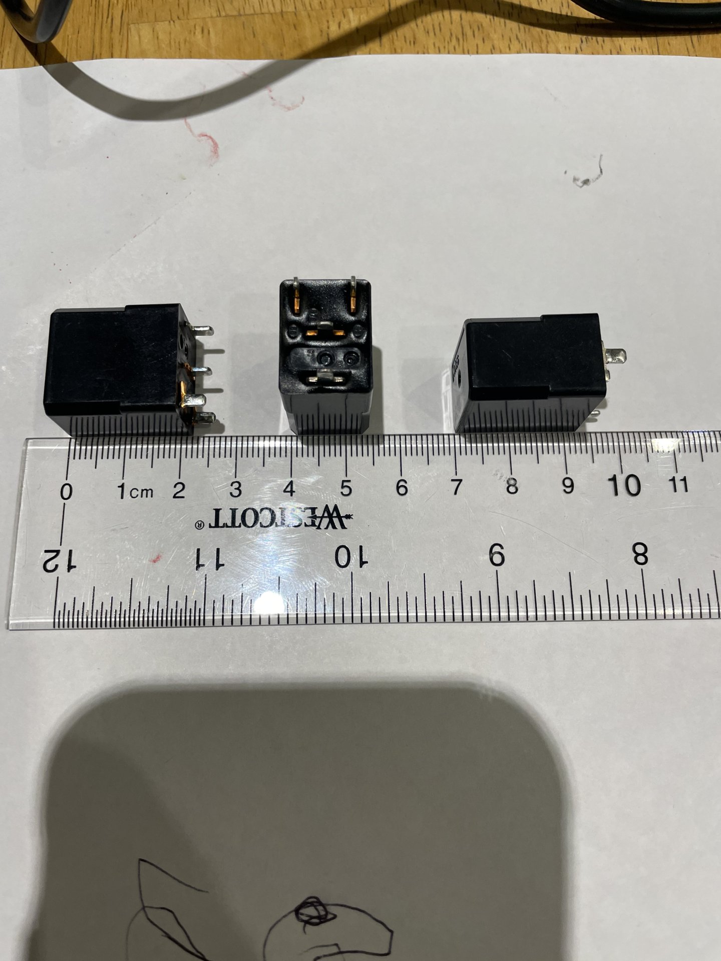

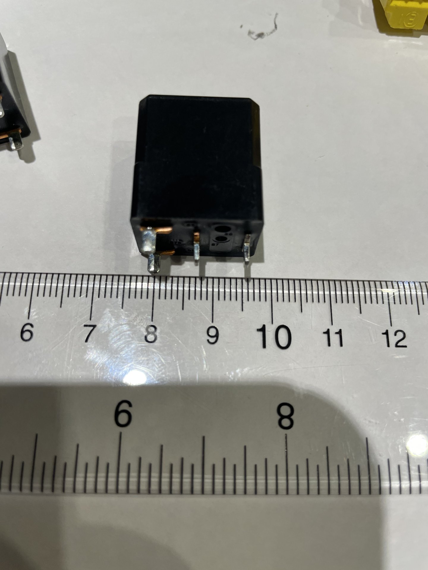

I believe I identified the relay and found a suitable solder in replacement. (Made in Japan, but not Denso)
Anyone have a spare fuse box sitting around after replacing? Would like to figure out if the relays I sourced will work. Happy to pay for fuse box/shipping.
I have one that's still good, so I don't want to part with it. If you show me the relays I'll buy some and check them... in maybe a month.
I'll take a box apart and check it if you send one. I'll send it back after the fact also. Or I can buy some.
I won't be home till Nov though.
