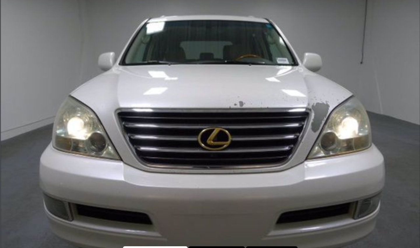

Hi everyone, I just purchased a 2005 GX 470 with the intent to build it into an overland truck for my wife and I. I am brand new to the community and was introduced to the GX/LX and IH8MUD by a friend who is also a member here (u/Brauski). I plan on tracking the whole build here so keep up with the thread and feel free to offer advice.
Who Am I: Raised in Hampton Roads, Virginia, then went to college and worked on the east coast of Florida. I am a mechanical engineer and did some racing design work in college so I have a pretty decent grasp of the technical aspects of vehicle design/build. However, that was primarily all custom built so I am somewhat lacking in knowledge of model/brand specific information so I am always looking for advice in those areas. I am currently in Northern VA, but will be headed to Pensacola, FL in about 2 months.
The Truck: A 2005 Lexus GX 470 with about 158,000mi on it. I bought it for $12k from Atlanta Toyota unseen. They are shipping it to me now and it will be here by Tuesday of next week. It has an impeccable service record and is non-nav. Of note, It had the 90k service right on time and also saw a radiator replacement at 73k and then a new rear air suspension and shock absorbers at about 149k. I have not checked the diff lock yet, so my fingers are crossed... standby for that test result. It is a "Blizzard Pearl" exterior with a bit of paint coming off on the front of the hood. The interior is Ivory.

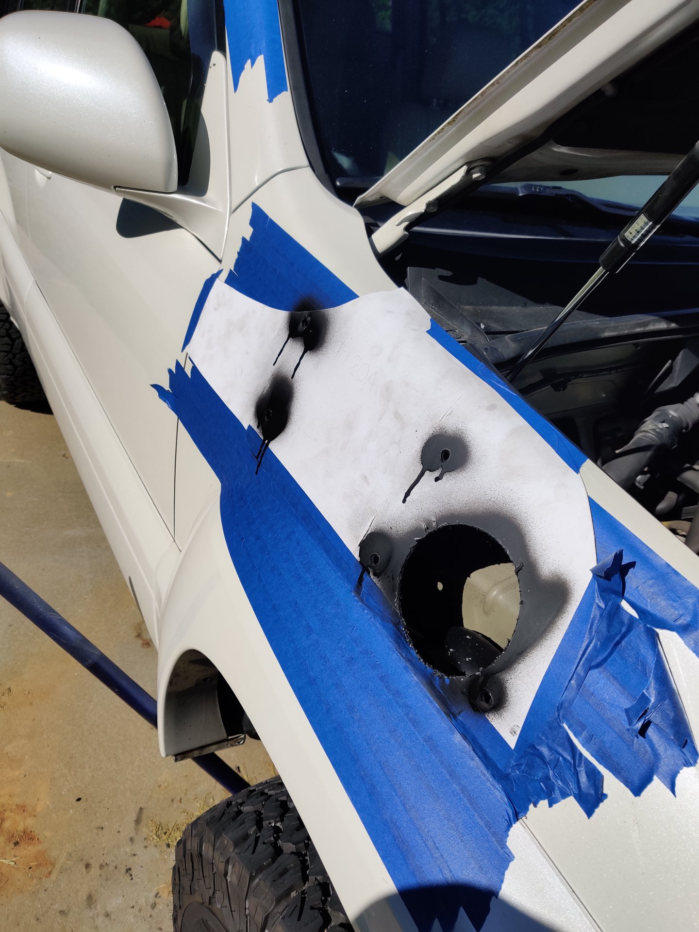

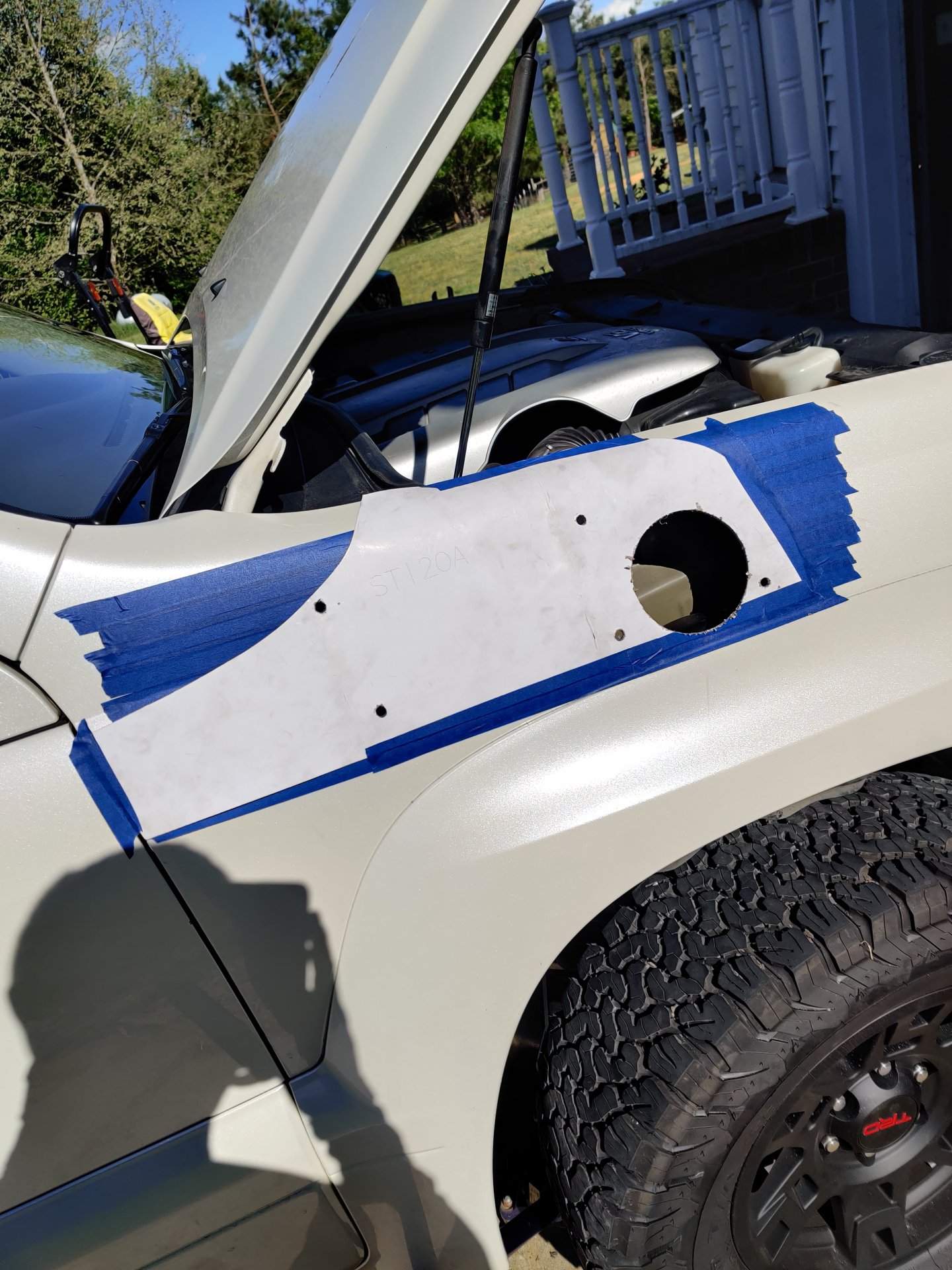

Just installed the Wotefusi snorkel over the weekend. I expected this to take 2-3 hours and it turned into an 8 hour ordeal. A couple lessons learned and instructions for installation (I could not find any for this specific kit).
1. Remove wheel well fenders. There are a few Torx screws and retaining snaps. The snaps on mine were dry cracking so about halfway through I committed to just replacing them all. See link below for replacement snaps.
Amazon product ASIN B07GWRD72G

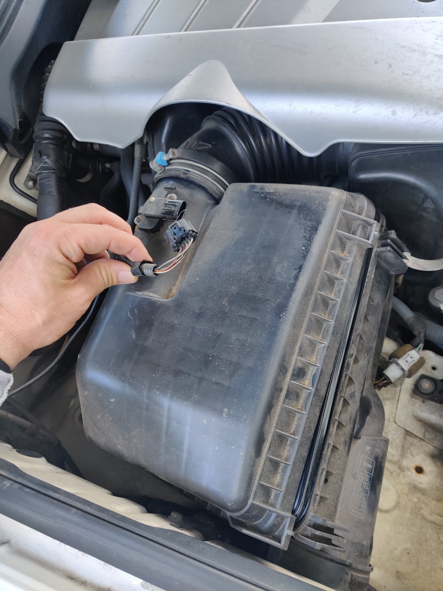

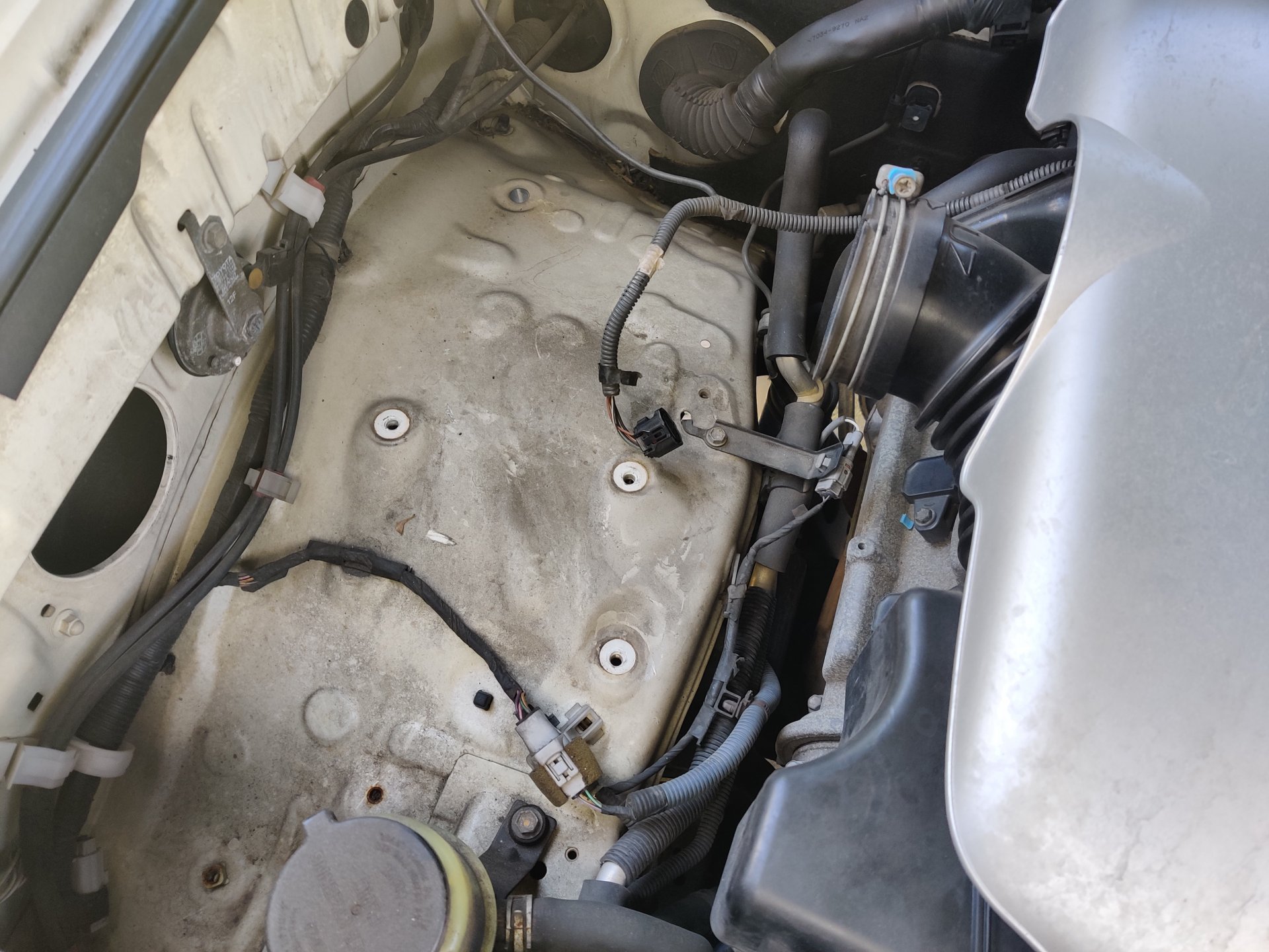

2. Unplug senor on the air intake box, then remove the cover, filter and unscrew and pull out the rest of the box. Removing all this may not be necessary but I appreciated having room to work and it was easy enough to pull it all out.
3. Lay out the template and align the left edge with the door panel edge and the top with the top edge. Then drill out the holes on the template and coat the bare edges with a primer/sealer. I strongly advise you check the template against the actual bolts screwed into the snorkel for fitment issues. My top 2 holes became slots because the template was not perfect. Also the 4in hole became 4.25" but that one is harder to verify because fitment requires partially installing the internal channel.

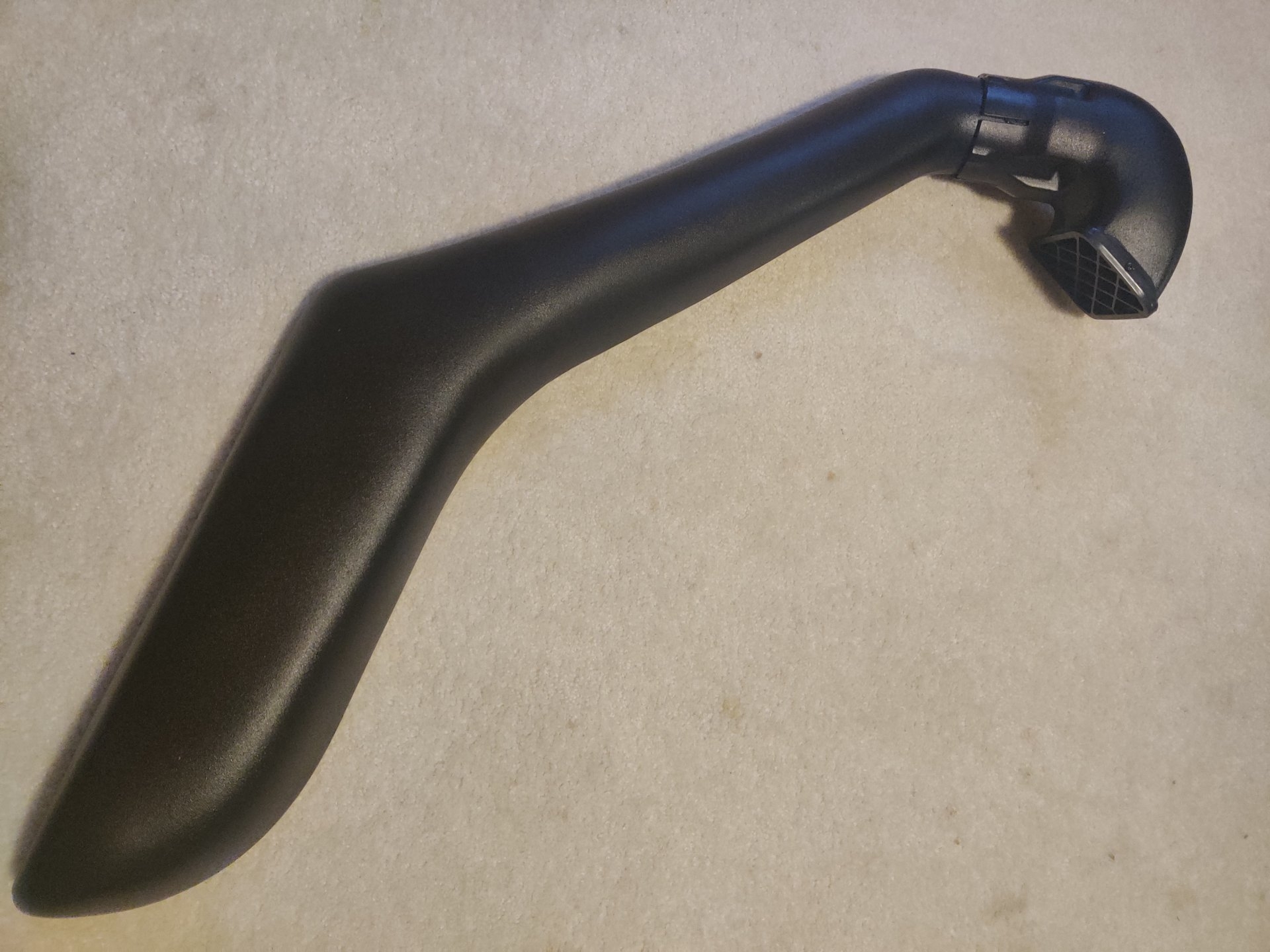

4. Install the external portion of the snorkel and tighten down all the bolts internally. I left off the A-pillar bracket and plan on using some type of mounting tape instead of drilling into the pillar.
5. Last is the tricky part... you need to find a way to fit the hose clamps and rubber gaskets into the tiny compartment and seal them all together. This will likely involve some trimming of the pipes. You may have to uninstall and reinstall the snorkel a few times to get it right. Be patient... I ended up taking about 0.5-1.0in off each part and cutting one of the rubber gaskets in half laterally to make it fit. This is the part that is a real pain. I hose clamped one side then forced the whole thing into place then clamped the other side. If anyone sees this and wants a better description, let me know and I will see if I can explain better.
6. reinstall everything and replace all the snaps and bolts for good measure. Here is the end result:

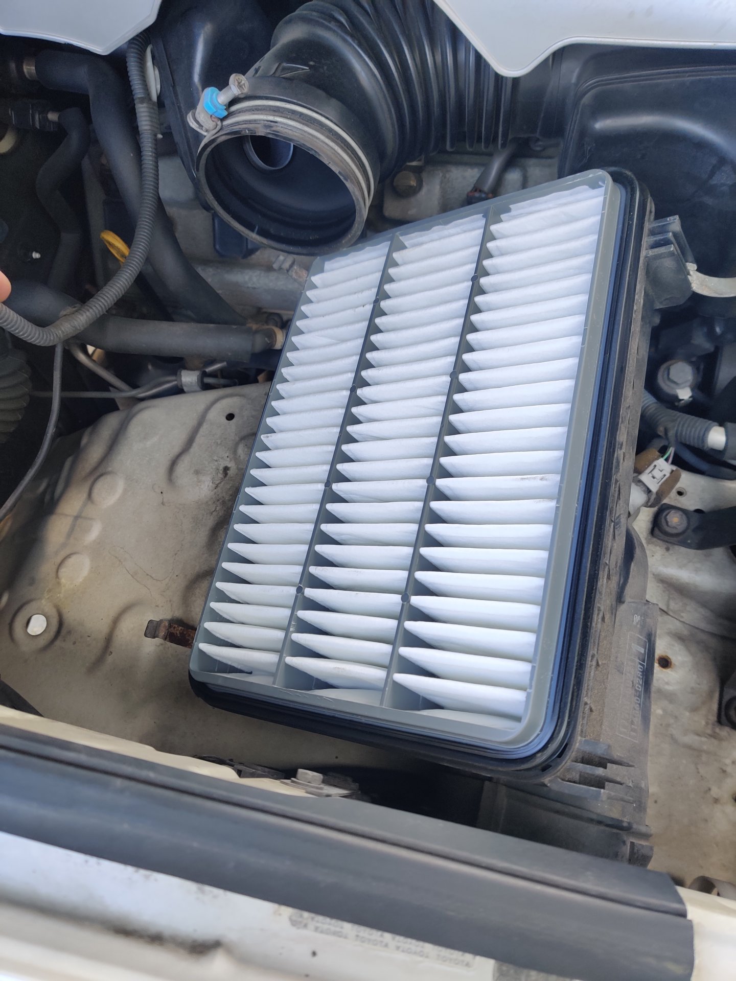

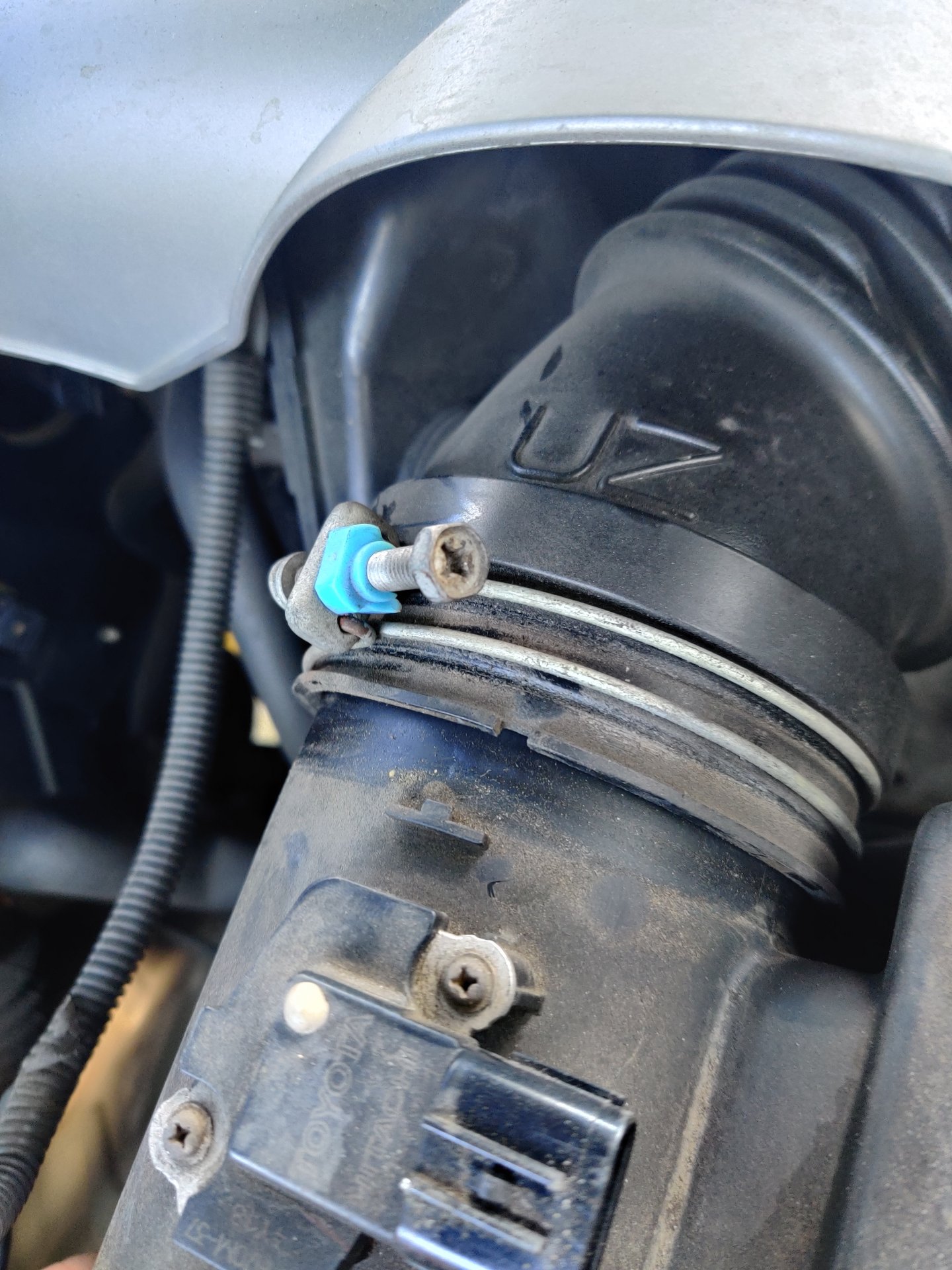

View attachment 2672889 View attachment 2672898View attachment 2672899View attachment 2672900
View attachment 2672903View attachment 2672904

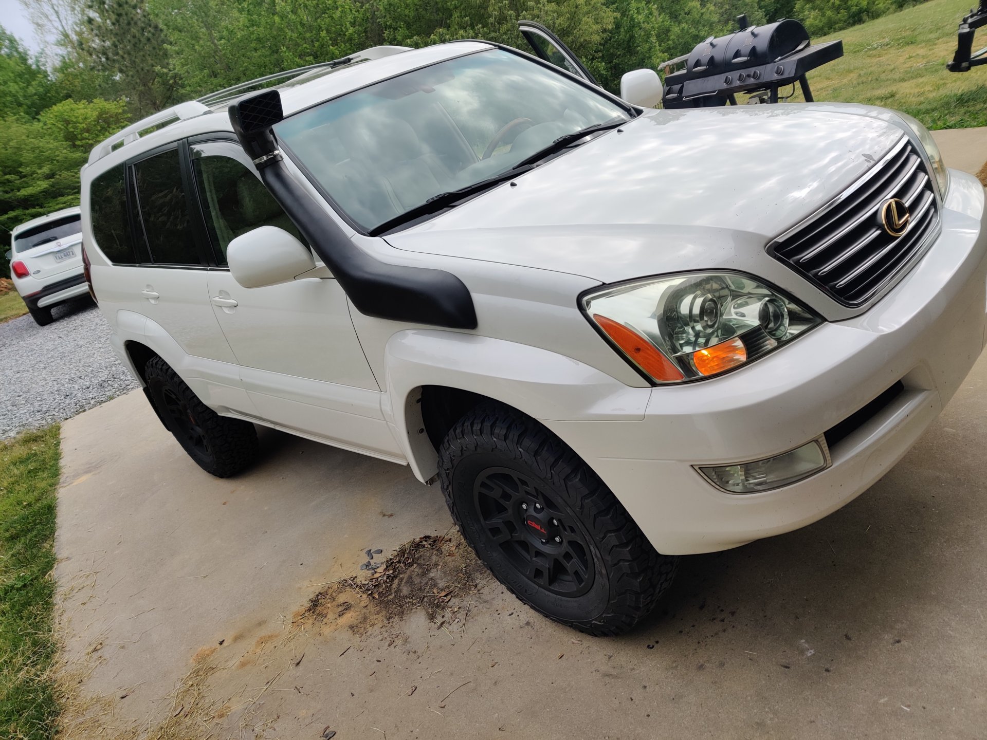

Love it. I really want to do a snorkel for both our 470 and 460. I’d also use some 3M VHB or similar adhesive rather than drilling the a-pillar.
