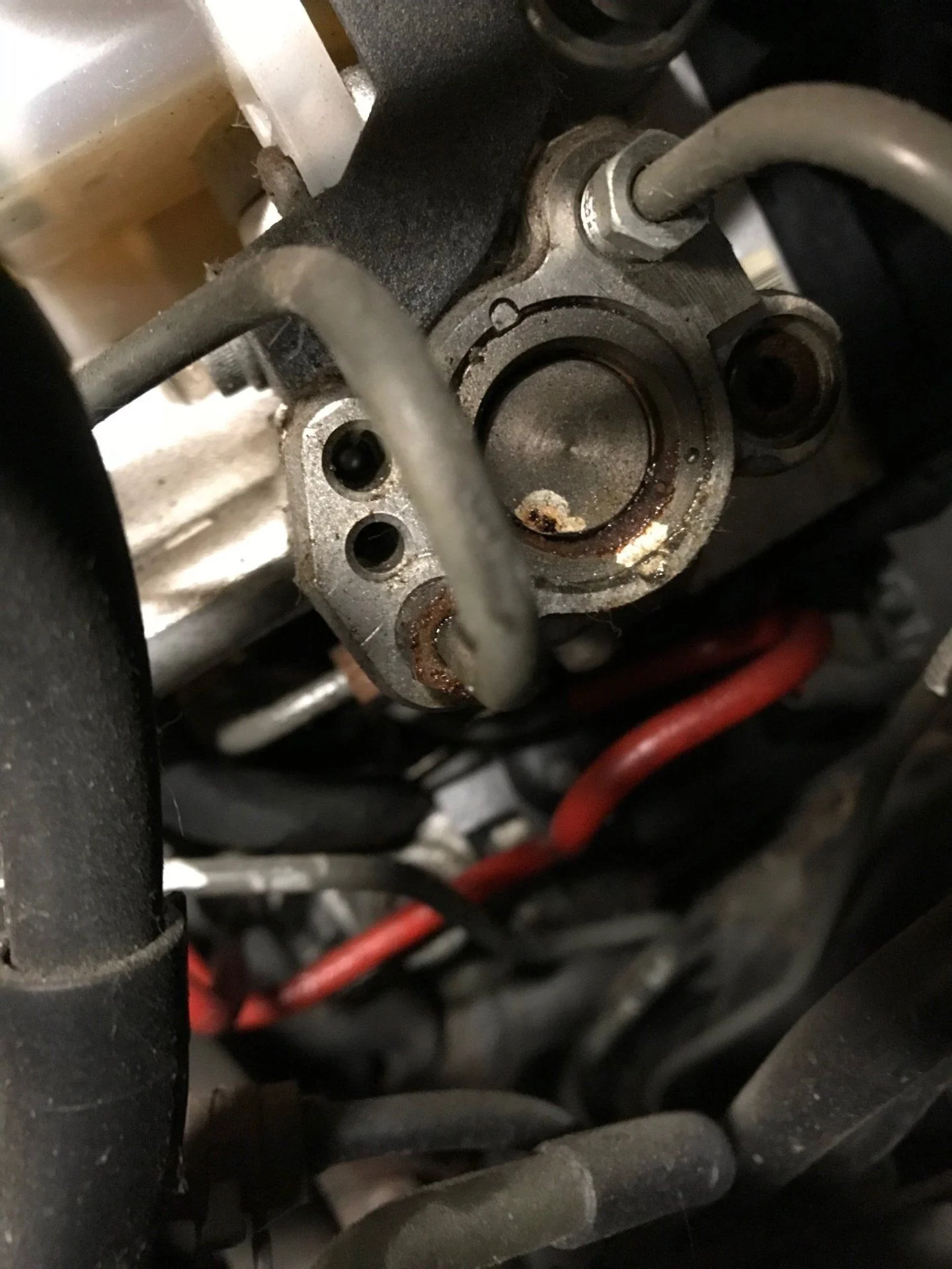

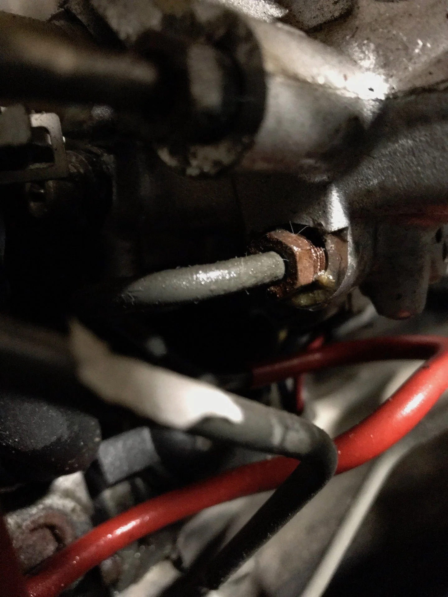

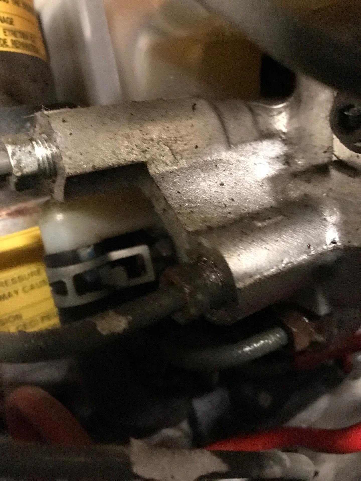

before the alarm started going off i could see the MS leaking pretty bad. its hard to know exactly were its coming from but i do know its coming out of the ms not under the dash. so i know that either has to be replaced or rebuilt with the piston kit. i was hoping that that was the culprit and not the pump and booster. is it possible to start with that and then see if its just that? Thanks for the help btw!
here are some pictures of the MS and leaks
Don't think it is the grommets for the brake fluid reservoir, which would be easy.
Looks like you need a new master cylinder. The MC rebuild kit would only address leaks on dash side, behind the brake pedal.
MC Sub-assembly would address MC leaks, w/booster would freshen the whole thing.
The pricing is insane, the MC sub-assembly is around $1200 and with the booster its $2200.
