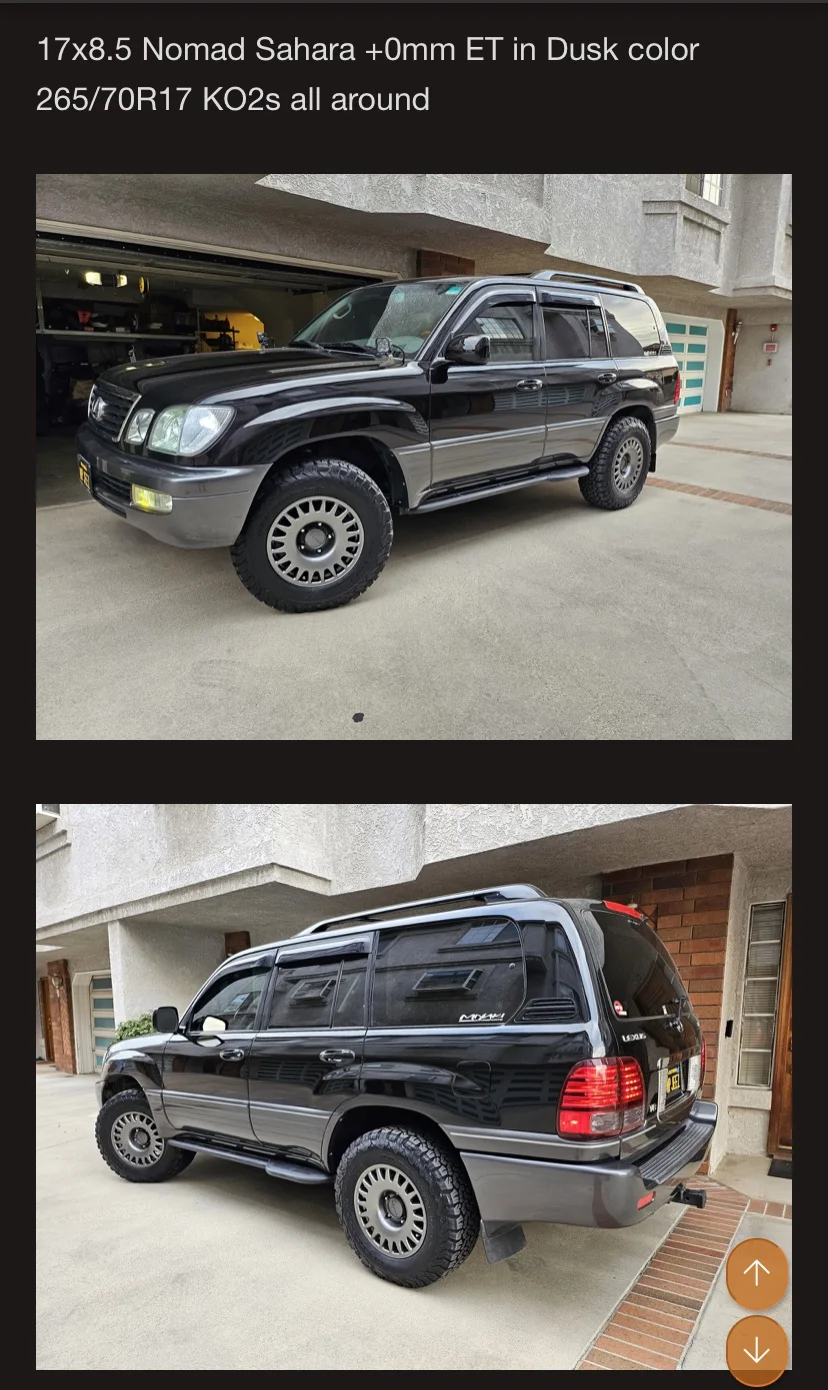

6) Jonesing for the Nomad Sahara's (photoshopped) even though the 0 degree offset might be a bit much for my taste.
Not mine, screenshot it from the photos thread a while back. Just trying to help you visualize
