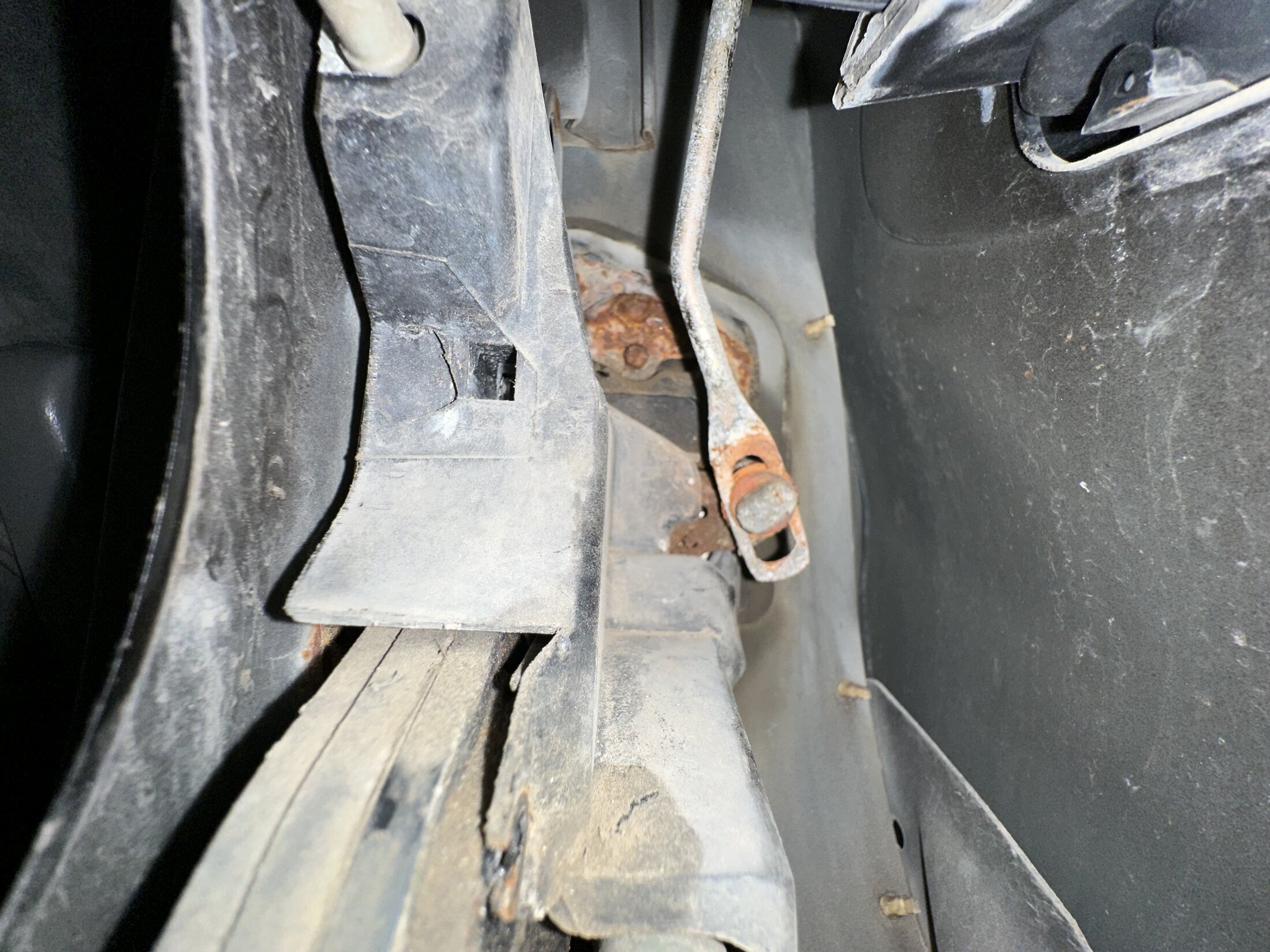

drivers rear door will not open on 04' Lexus LX470. Finally removed the door card(not fun) and now everything seems in order except the door will not open. Is there anything I can do to get the door unlocked and opened so I can find what the problem is?

Apparently that spring somehow limited the stroke on the mechanism to unlock the door. I removed the switch panel and screws under it and the release handle. It also removed the color coded pins on the sides of the door card(broke one). I then pried the door card up from the bottom using a flat metal bar along the bottom to prevent damage. I could only get it up about 5/8 inch. I then went to the top to attempt to get the top loose. There is a piece of metal mid way that holds the panel to the door frame which I had to be very careful in prying so as to not break the glass. Once I got the door panel where I had room to get my arm in the door cavity I took the rod loose door handle and push down on the lever and magically the door opened. That’s when I took the actuator apart and found the spring end out of place
