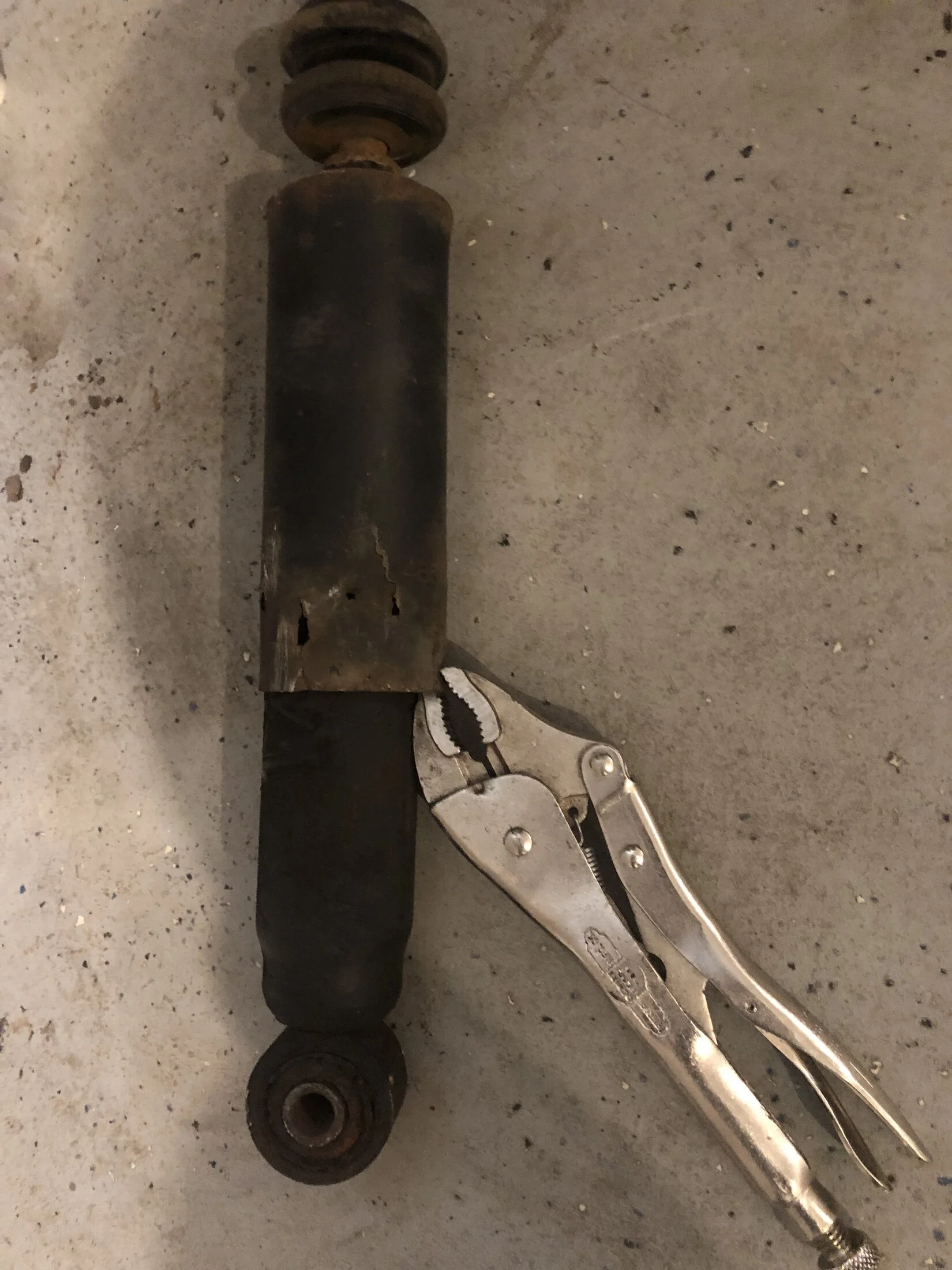

I had the same struggle with the fronts as well. Used heat gun and PB blaster on the top nut. Used a vice grip attached to upper shock tube and rotated the 22 mm until the vice grip found something to keep from rotating. Be sure you are protecting the ABS sensors from damage.
