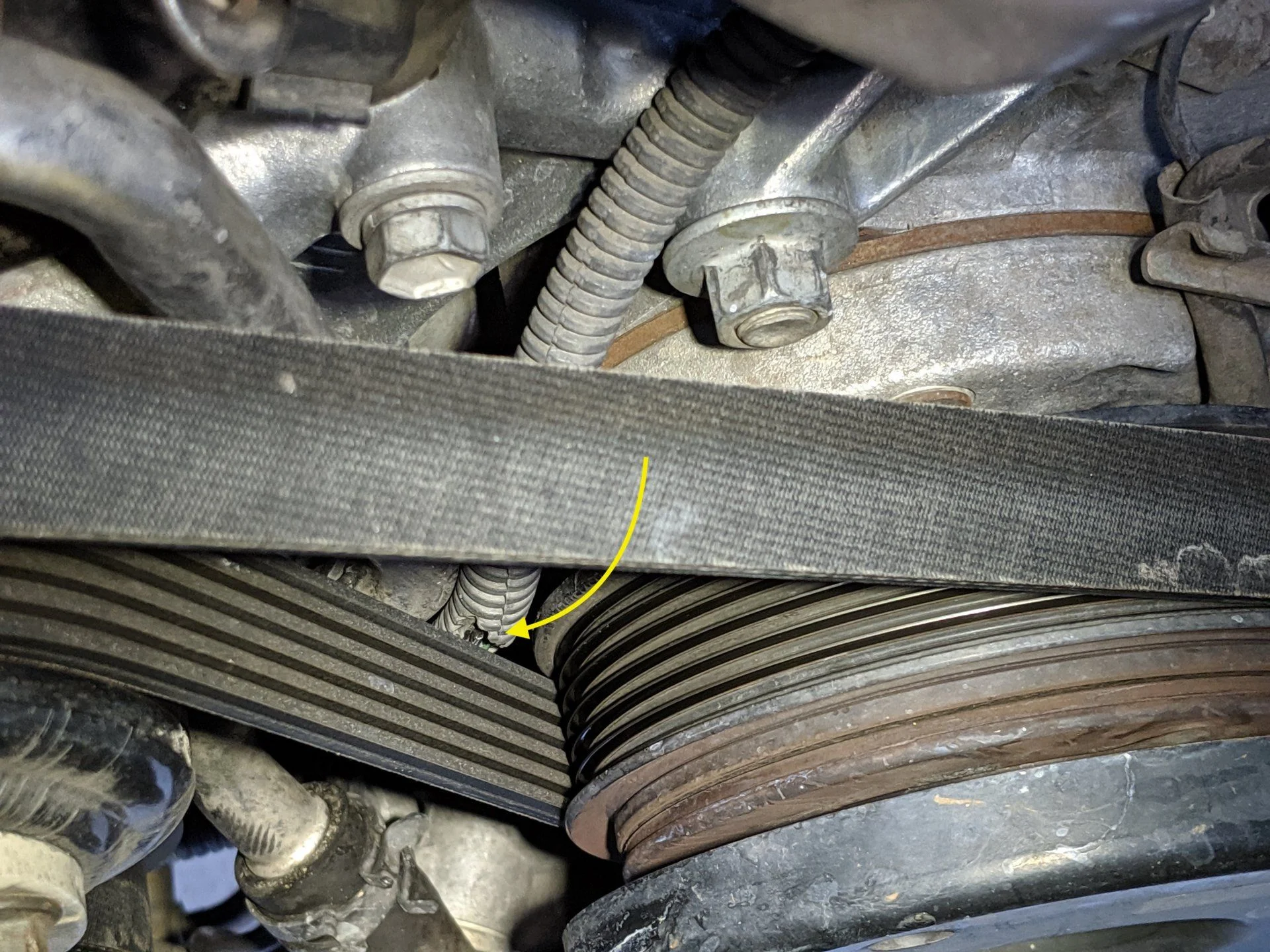

UPDATE: It looks like the problem was caused by the sensor wire getting rubbed through by the serpentine belt, see pic below.

Where is that wire supposed to be so that it will stay away from the belt?
Thank you. I think I got it taken care of. That wire in the pic had been worn through and was causing a very intermittent crank sensor signal that wasn't throwing codes but still caused a misfire. The wiring itself wasn't damaged, only the insulation, so I patched it up with layers of liquid electrical tape, regular electrical tape, foil tape (for shielding!), and wire loom. I routed it behind the oil pipe and now it seems out of the way of the belt. All is good!
