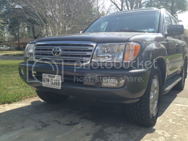

So it's been about 6 months now...and I'm still loving it!
I drive about 1,000 miles each month and it has been great. Not even a single issue has come up. Just did the initial maintenance and repairs to get it back to spec, so to speak. So much info here to tell you how to get a good experience out of this vehicle. I do plan to do some more major service later this year, T.Belt, WP, etc.
Best money spent was on the steering rack bushings + alignment. Ride is solid, quiet, smooth.
I'm still very happy with the decision.
