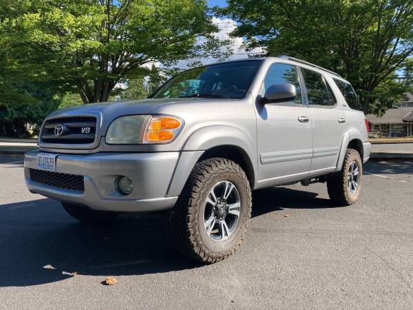

My original idea was to go down to 16x7” Tacoma wheels, 265/75’s and somewhere around zero offset to get the tires out to the edge of the fenders. Try to make a small tire look big. But then I came across a set of 17” TRD Sport wheels with really nice E rated 285/70 KO2’s on them for too cheap to pass up. So now the plan became, How low and narrow can I get 33’s?
With an aim towards simplicity I went with 5100’s on the front, 2nd notch for 1” lift. OME 10mm spacers on the rear- I like a small amount of rake. The wheels are +30 so I wanted to try a 1” (25.4mm) spacer to get the offset to +5. All 20mm of added tire width goes to the outside. Luckily I found a set of new, never used Bora 1” spacers semi locally for a steal, and I didn’t have to wait 7 weeks to get them.

Overall, I dig it! I snapped a rear sway bar end link so the ass is a bit wobbily right now (and it can’t keep coolant in it, that’s another story). I really like how it looks with the fenders filled up. I am getting a touch of rub on the frame rail though, not enough to worry about or should I go 1.25”?

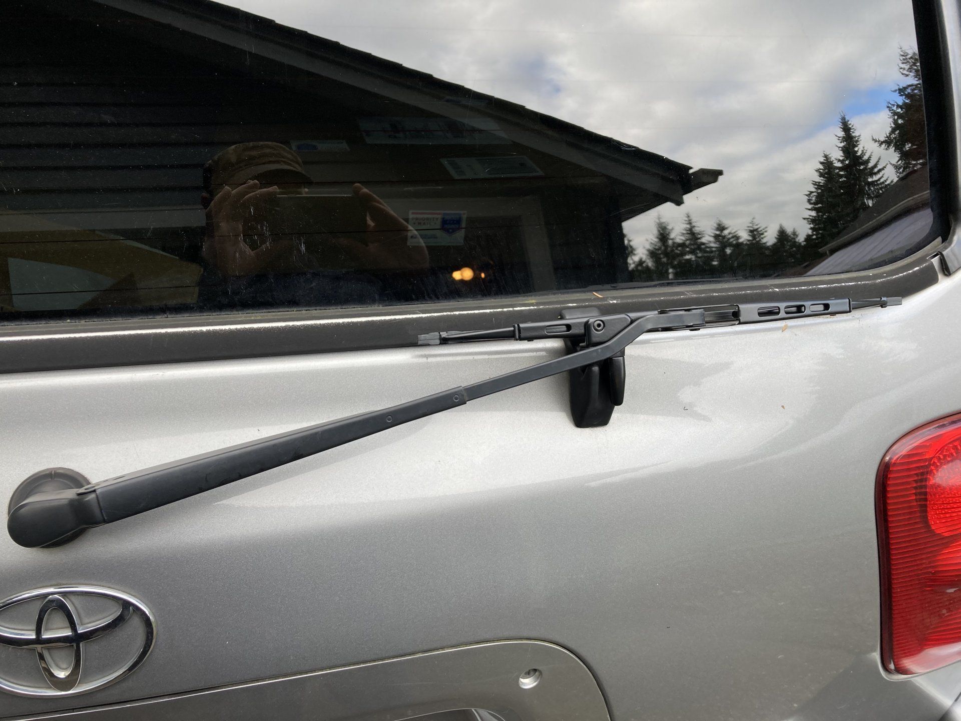

Rear window wiper had been replaced with a generic RainX item that didn’t work well and didn’t go back in its home.
Got an OEM blade from McGeorge and everything works as it should 👍🏼

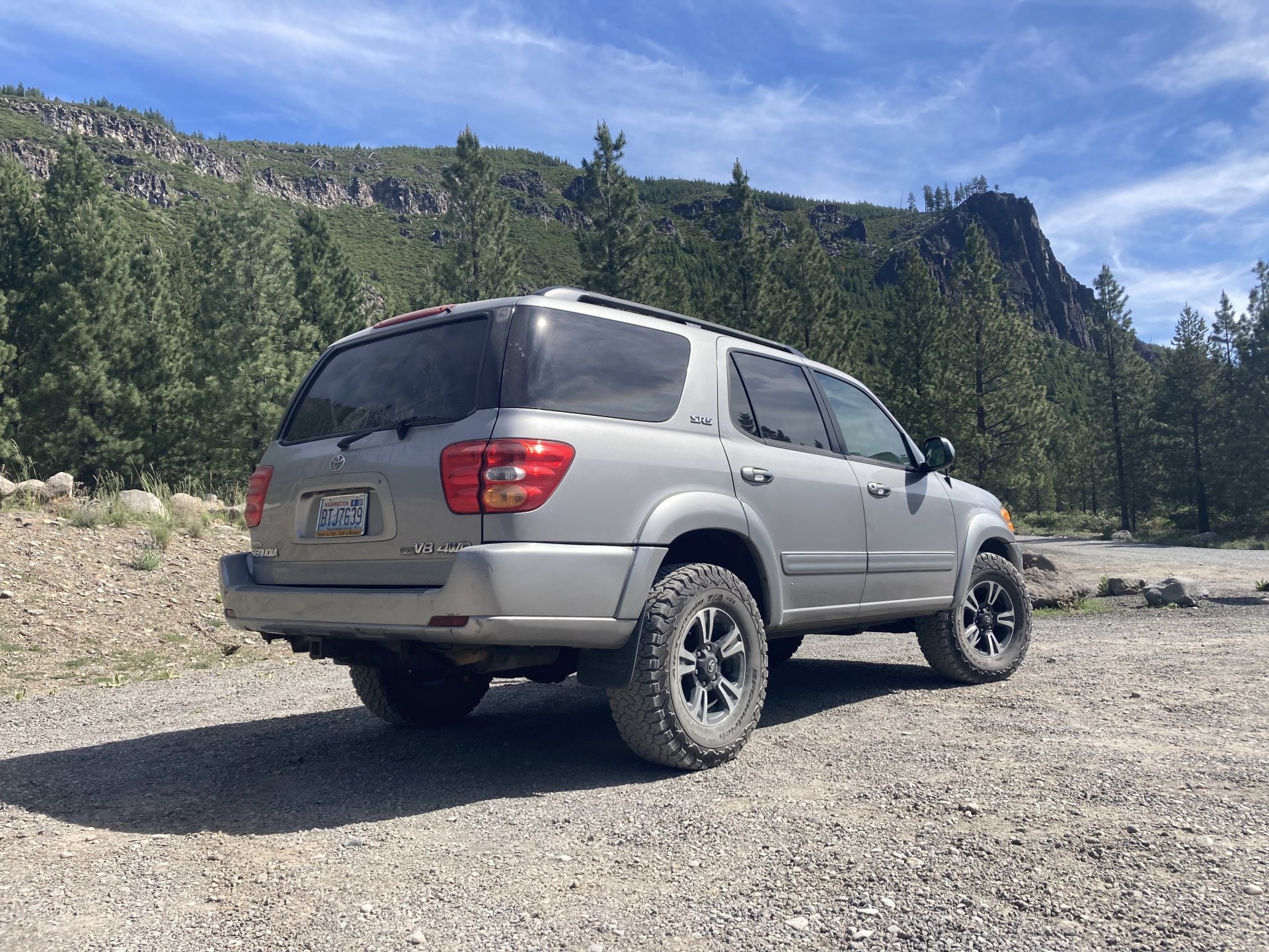

I got busy with life and didn’t update this thread. Truck is now finished and I achieved my goal of doing the Gambler 500 in it last month. The truck performed perfectly, couldn’t be happier!
And now listed for sale:
