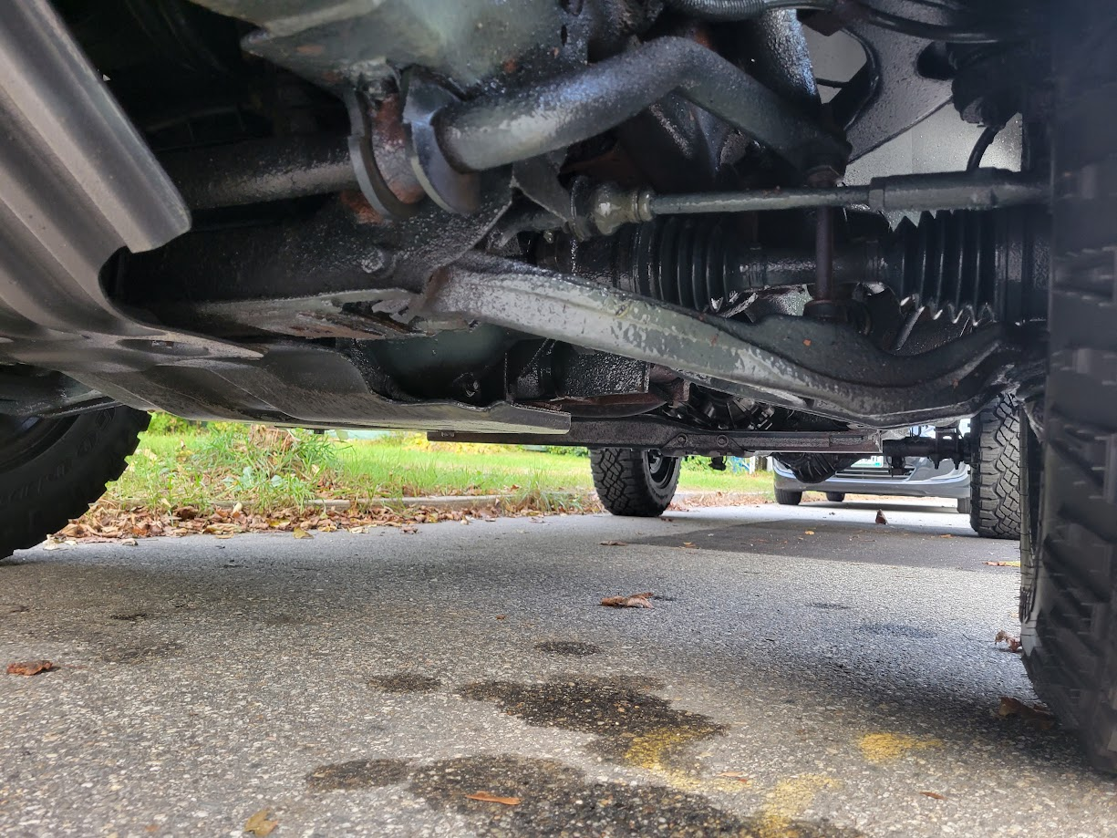

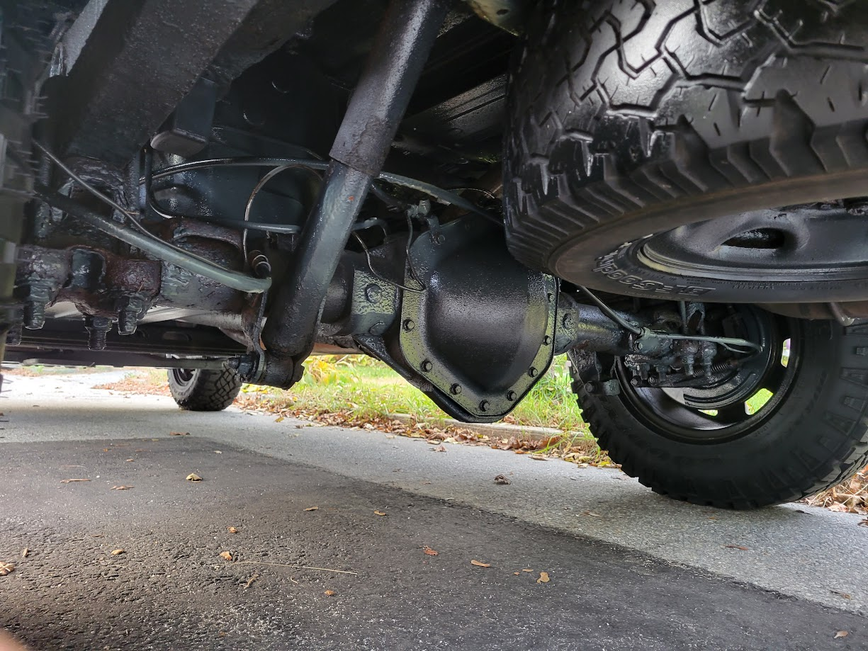

I highly recommend Fluid Film or Woolwax, with Woolwax being better but more expensive. These are lanolin based waxy oils. They are non-toxic and safe on all rubber/plastic components.
In 2020 I purchased a 2003 GMC 2500 with some pretty severe frame rust. I needle scaled the whole frame and took pounds and pounds of rust off, but I never came close to getting it all. It was NASTY.
What worked was applying Fluid Film over the next few years. By the second year, almost all the rust had fallen off on its own and the frame was clean black metal again. Also removing any kind of hardware got much easier, as the wax had acted like a penetrating oil.

These pics are right after a fresh coat of Woolwax. There's still some visible rust, but it definitely doesn't look like a 20+ year old Maine truck anymore.
