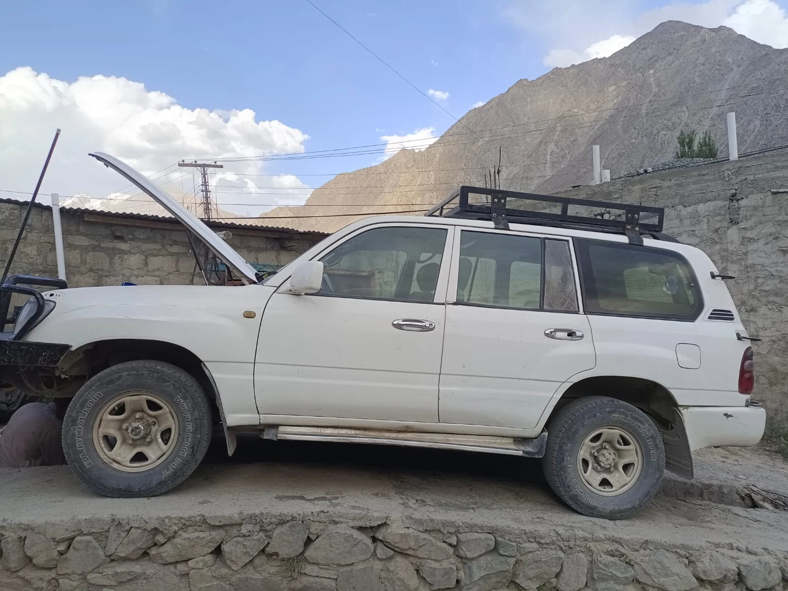

Apologies for reviving an old post but I found my UN Poverty Pack HZJ105 LHD in Pakistan. It's a year wait to import to US but I got storage!
I recommend Shield Storage in Langley BC. It would be nice for Missus White to have a companion. Prices are reasonable and it is indoor storage. PM for contact details.
