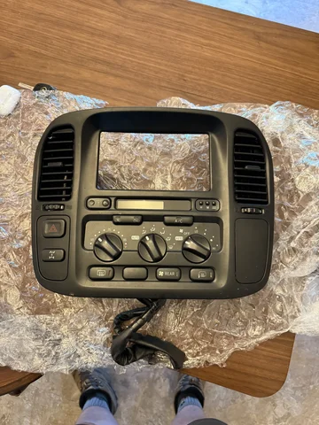

I’m gearing up to do the swap right now. I actually just got my LC control panel in the mail today. I’ve got almost everything except for a new head unit. I think I’m gonna go through the ML amp for the time being, but I am tempted to just go for it and bypass the ML amp completely and run new speakers/sub.

Yep, rip out all the factory stuff and upgrade amp, add a dsp, and some decent drivers and you'll be in for a treat vs what you had.
On the headunit thing, I had your basic pioneer that fit in the double din opening for the last 5+ years but I just bought one of the android units (mekede dudu7, dumb name whatever) bc with my starlink or hotspotting from my phone now I can run android apps natively on a bigger screen (like OnX) and not have to mount a iPad on the dash. Plus I've just gotten used to maps and split screen on bigger screens in my wife's car and my current little 7" screen feels almost useless for that use case.

I’m pretty certain I’m gonna go with a Sony AX4000. I don’t really know much about car audio but I’m pretty sure there’s an amp built into that head unit. Wouldn’t I be able to run new speakers off of that? Also what is a DSP? I’m not really a big screen guy, I’d run a single din if I didn’t like CarPlay so much lol.
