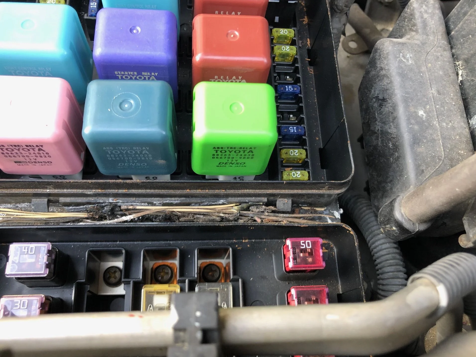

Thanks to everyone for chiming in. Update: I double checked all associated fuses, all checked out ok. I found the ABS-VSC relay, but had difficulty pulling it. It's very tight in there, looks like there is some sort of clip holding it in? Can I pry that loose with a little screwdriver? I'll try to pull it and test it today just to make sure. I gave it the traditional love tap to make sure it was not stuck, lights still on. I'll add pics of relay.

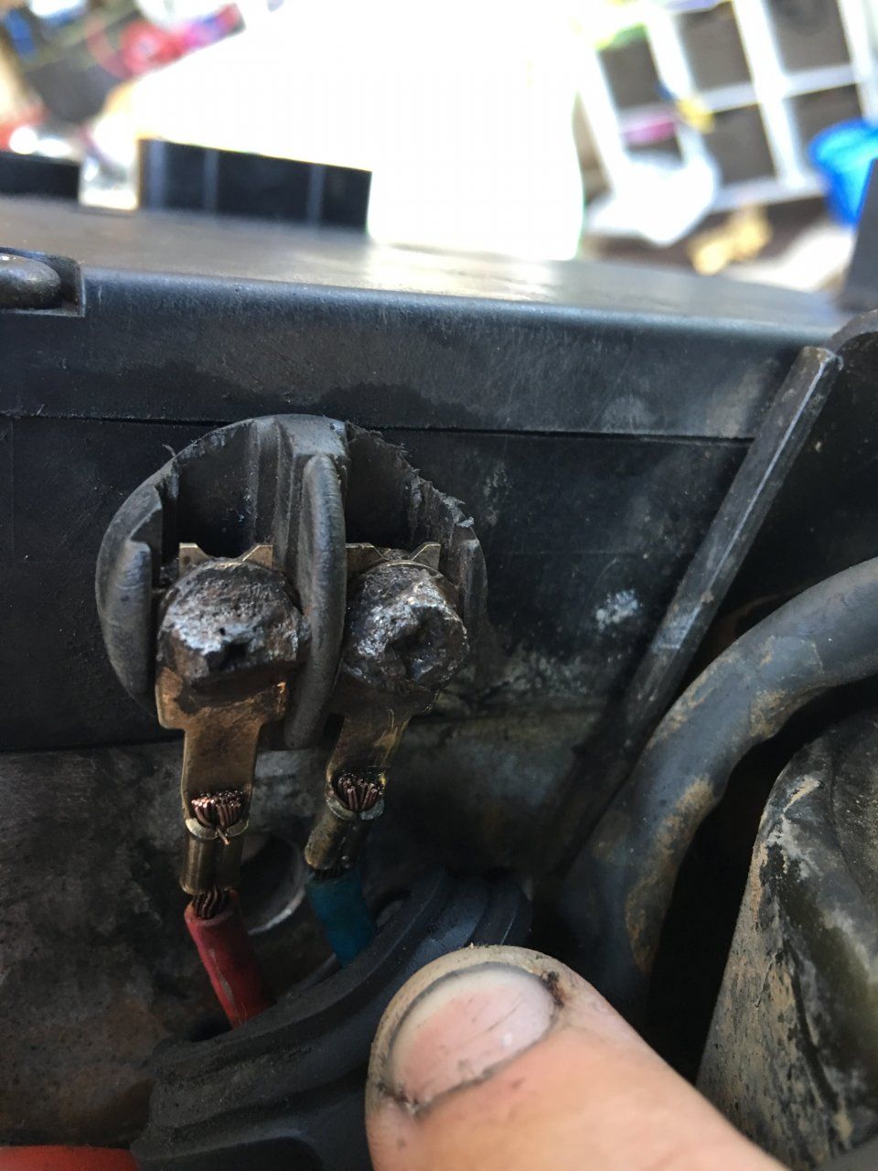

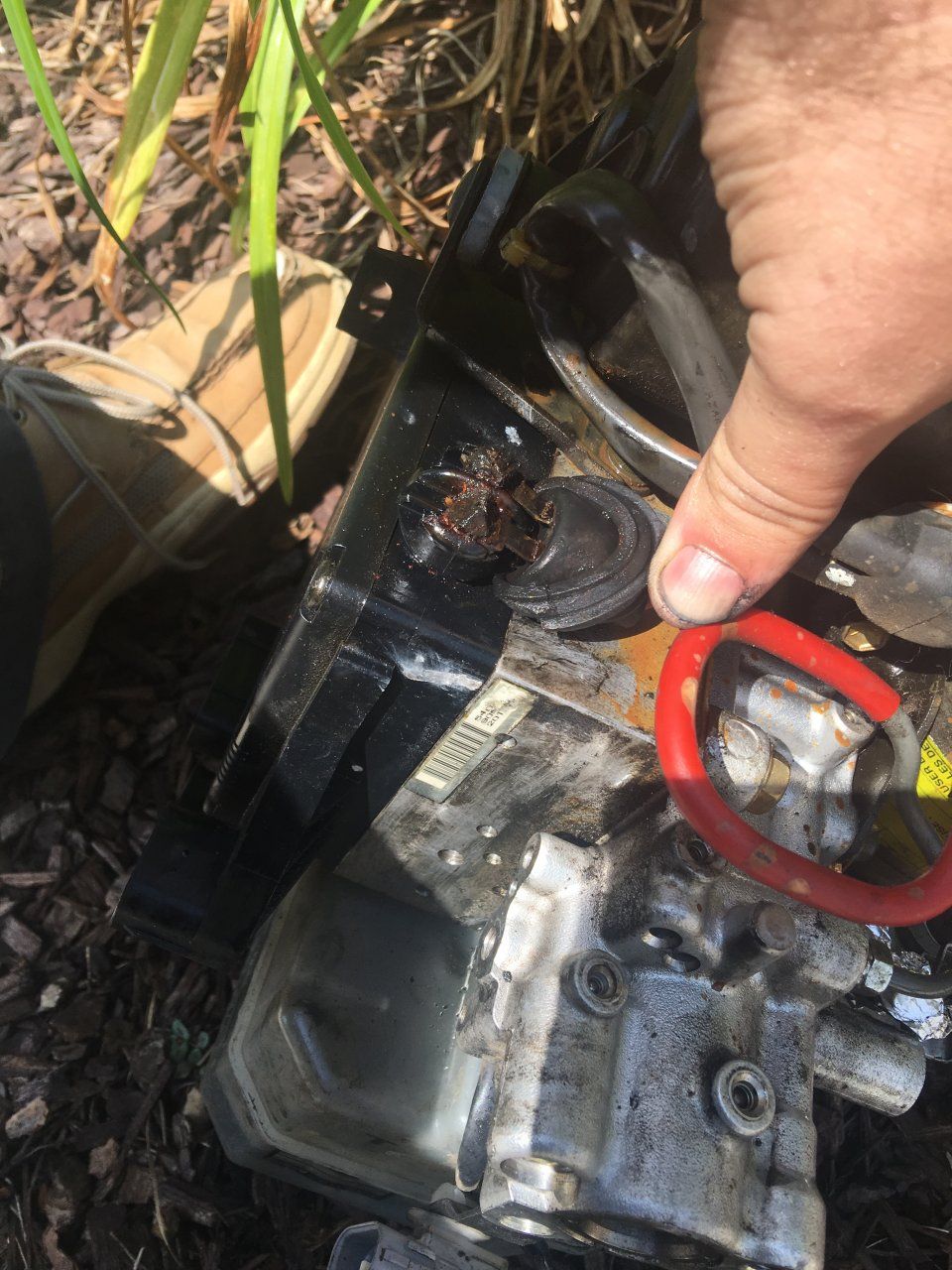

Yesterday I talked to someone at Cruiserparts.net (thanks for the tip, can't remember name) who said these units almost never fail, and for me to pull the rubber boots off to check the terminals. He said that they often get moisture inside and corrode. I found these pics at this thread:
ABS Modulator - (Master cylinder, Pump/Motor, Accumulator, Resivoir, Solenoid module)
Will do my best to check these, but they are extremely difficult to get to. I may pull the ABS module and see if it makes it easier to get to it. I'm guessing that it might take pulling the whole assembly. If I can't get to them, and the relay checks out, I will go to the Toyota dealership for diagnostics.

I forgot, but the green relay lower right is the ABS VSC relay. And, to be clear, this pics of the pulled assembly are not mine, from another thread.

There are pliers made for pulling relays that make it a bit easier. Otherwise just wiggle back and forth carefully and they should eventually come free, patience!
Ok, pulled all associated wires from ABS module and inspected (others than those with rubber boot that are screw type terminals, impossible to get to as far as I can tell without removing ABS module). Those were ok. Reseated them all, lights still on. I managed to pull the relay, pair of pliers helped. Can anyone help with a diagram for the green 6 pin ABS module? Actually there are two. I can post numbers from them later. Thx again.
