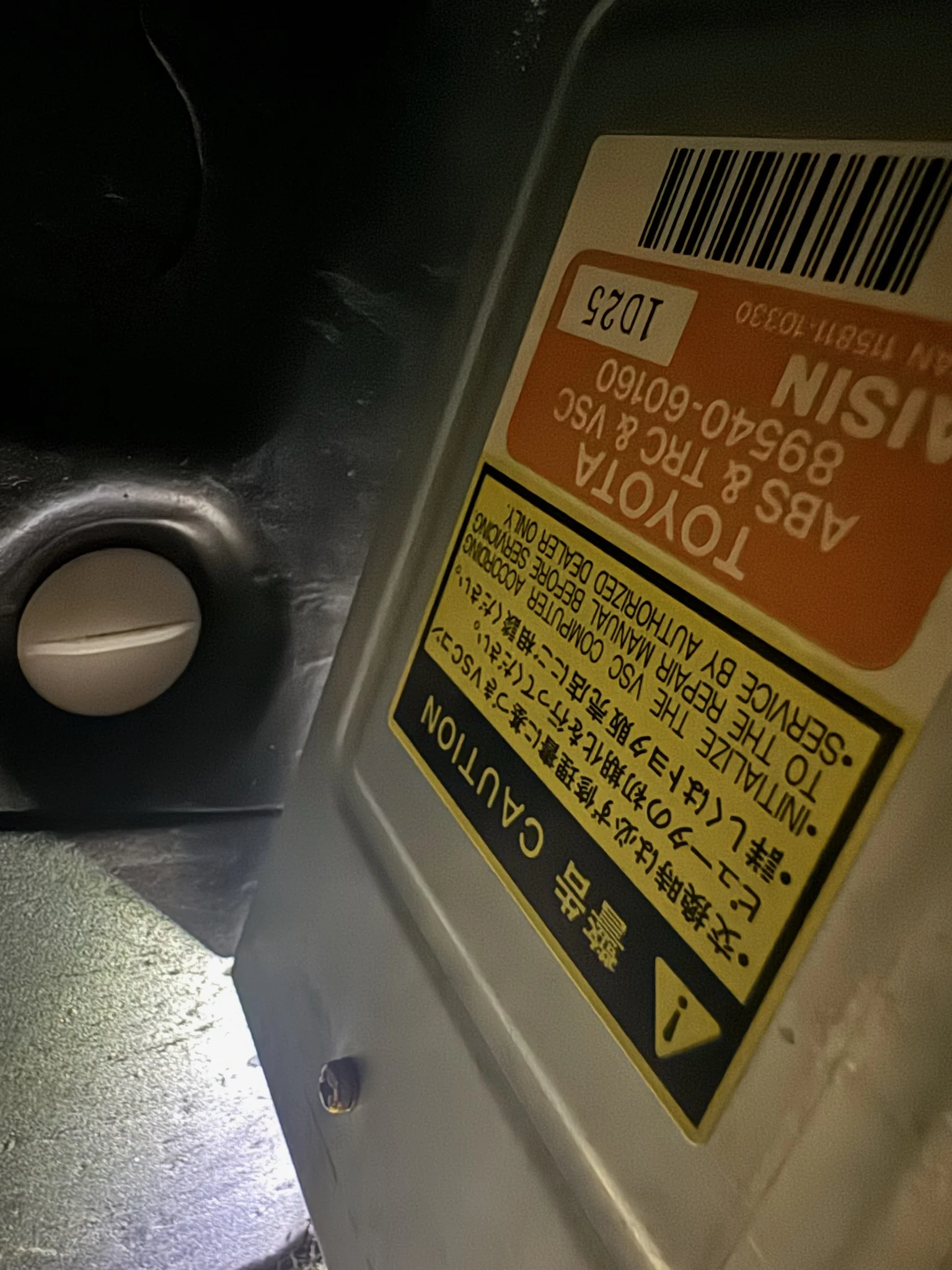

Chiming in here as this thread was very helpful me. I have a 2001 J100 with 334k miles and after a routine oil change (in which vehicle was lifted and one of some of the wheels were rotated for inspection - but out of sync with each other) the AbS, VSC, and Active Traction lamps on dash all illuminated. We also experienced the same non-communication with ABS computer when connecting to the OBD2 port (whereas all other vehicles systems were communicating).
After some electronic backtracking and consults with reputable landcruiser shops, and reading this thread, we determined it was most likely a ABS/VSC module that had gone bad.
I got a used one on eBay (reputable seller and the unit appeared to be in good condition) and replaced it, and voila...after a short drive around the block, all the dash lights went off!
Search for part number 89540-60160 and be sure you have a long ratchet extension and flexible hip, back and shoulder (it's a pain to reach up under the brake pedal and R&R this module) :)
