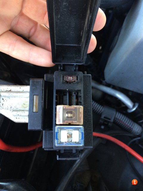

Ok so i was poking around checking fuses and what not and noticed that the box next to the positive battery terminal should have in order from top to bottom 7.5 (ALT-S), 100a (Main), 140a (ALT)and another 100a (J/V No.2) The fuse I am "Missing" is the Main fuse... now a long time ago I was told if its not broken don't touch it but its bugging me! My questions should it be missing? Should I throw in 100a fuse in the empty spot? Thanks in advance for the advice! See pictures for better idea of what I am talking about.
Completely normal for that fuse to be missing, at least in US trucks. I think (but not sure) it may be for diesel glow plugs. Nothing shows in my LX wiring diagram book. You'll also note a number of missing fuses in the underhood fuse box...also normal.

Well usually when fuses are left blank it's blank on the cover also ... And it sounds important haha "MAIN" apparently not as important as I think since everything seems fine! Haha ya think it would hurt anything putting a 100a fuse in there? Maybe give me "better gas mileage" or "50 more hp!" LoL or cause it to combust into flames and turn to ashes! ( ya never know unless ya try!) lol

It's the power supply for the inlet heater on mine....or was until I ripped that out. Now it powers my driving lights and a few other accessories.
