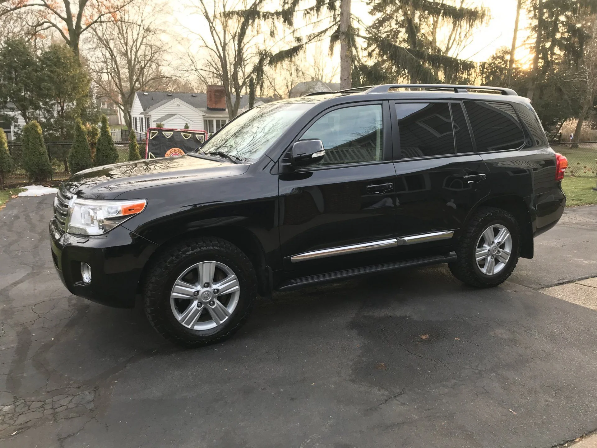

EGR GUY - I am considering the same setup for my 2018 LC. The BFG KO2's seem to be a popular choice. The debate I am currently having is whether to change out the wheels or go with stock set up. I definitely want to avoid any rub or alterations to the set up, or a significant ride quality change. I have also seen some comments on the KO2's that is giving me some pause. Can you comment about the every day driving with the KO2's, how they do in the rain, etc.? I have seen some posts that claim some hydroplaning issues. Any pics of the stock set up you can share with the KO2's?
In stock size they ride great on the OE wheels. A little firmer than the OE Dunlop’s But that to be expected with the D rating. I’ve not had any issues in snow or rain at all with them either and haven’t experienced any hydroplaning.
