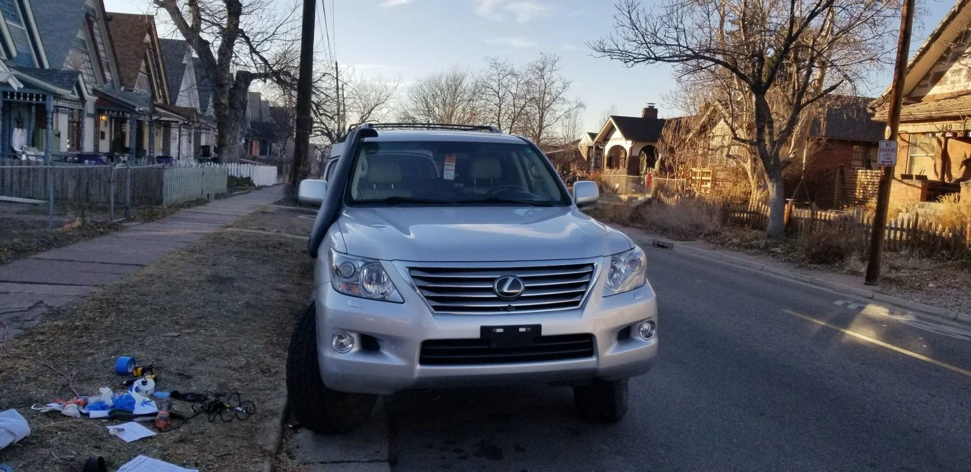

I convinced my best friend who also lives in Denver a 200 would be a good idea, so he bought a 2011 LX recently. He’s not a big poster on forums, but I wanted to share his truck since it’s going to be an awesome build. I won’t spoil the plans, but he has a Cummins Ram 3500 with bumpers and 35s for a DD (LX will become DD I believe) and a second gen SAS 4runner on 40s that he built himself.
First things up were Icon Six Speed Wheels with the new 285/75/17 Cooper AT3 XLTs, and a TJM snorkel. LOTS more cool stuff to come, and the parts are being amassed right now.
