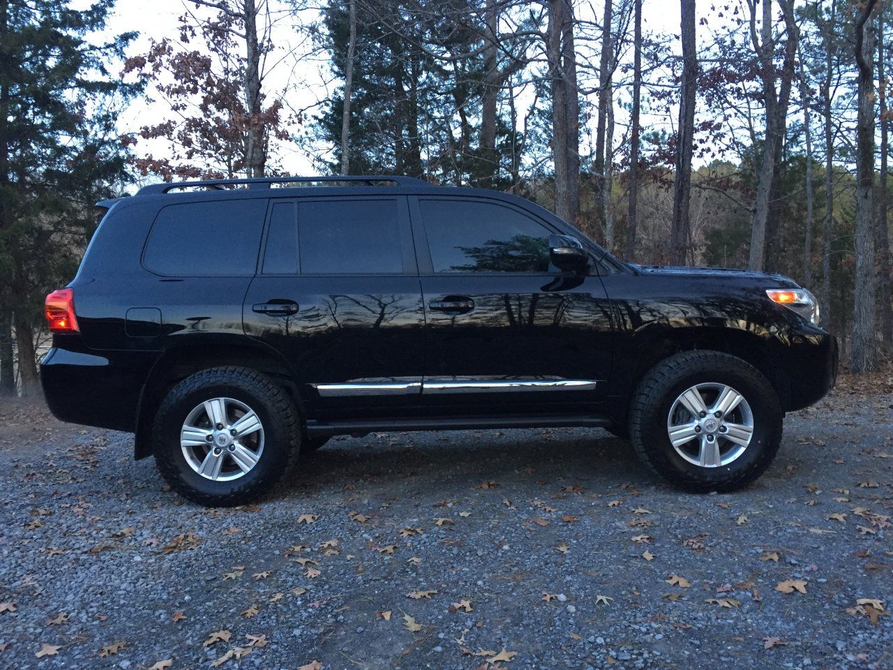

De 20'd the LX. Now need to decide what tires to go with to replace the crappy ones the wheels came with.
Just about can't go wrong with 285/70/17 KO2's. Great on dirt...on rocks...in Snow...quiet on-road...light...inexpensive...good wear...nice looking...and strong side-wall. Not a mud tire, but good at just about everything else.

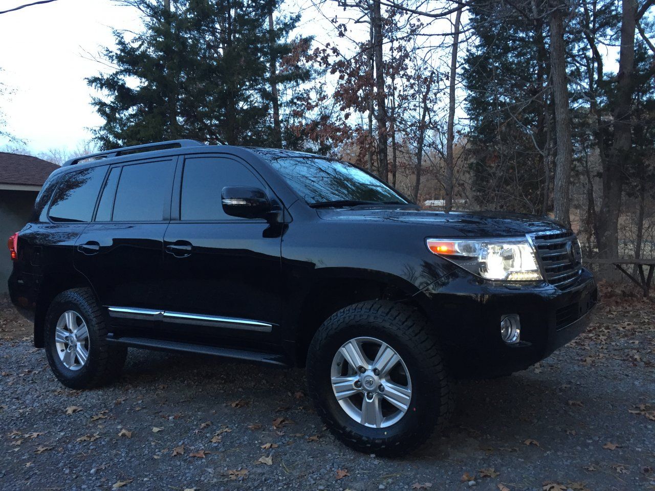

Truck looks awesome! Is that stock suspension and what size wheels/tires are those? Thanks
Thanks! The suspension on my car is stock with the factory AHC at Hi setting. The wheels are 18 x 9 +0 offset Volk TE37's. The tires are 285/65/18 BFG K02's. I had to remove my front mud flaps and trim a little bit of plastic away to the inner side of my running boards and to the wheel liner to eliminate tire rub.
