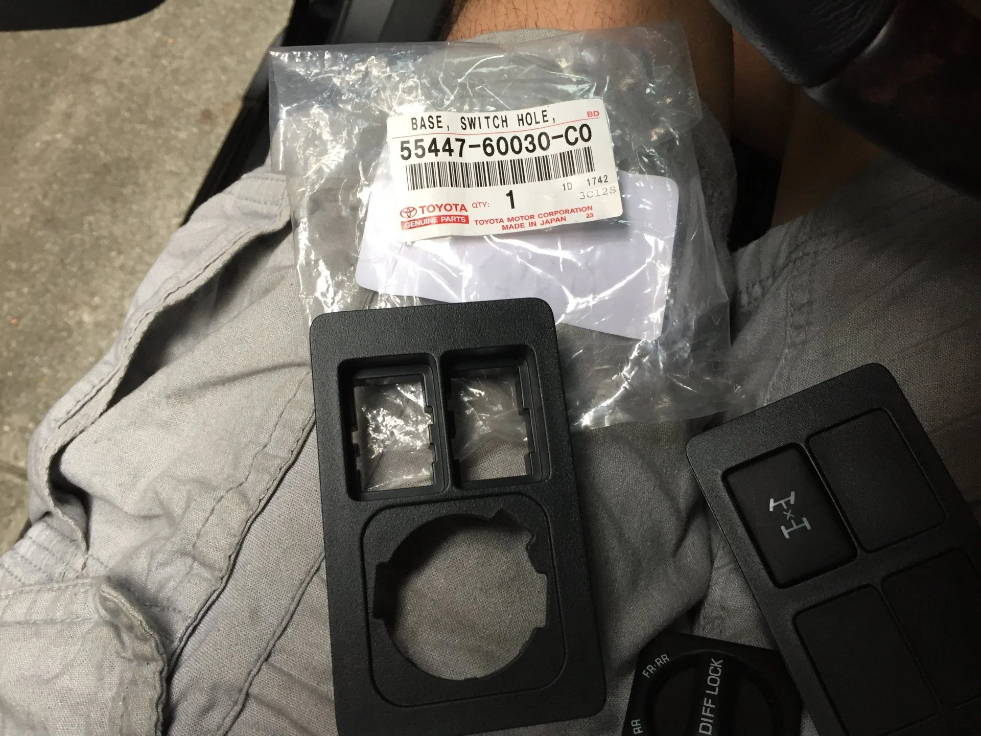

WhT is the part number for the 200 FR RR switch itself?
Have to use the 80 series one. You need the clip and wires x3, then bezel. I can only find the bezel threw Dubai on eBay. Just did this for my 2011 front and rear ARBs
