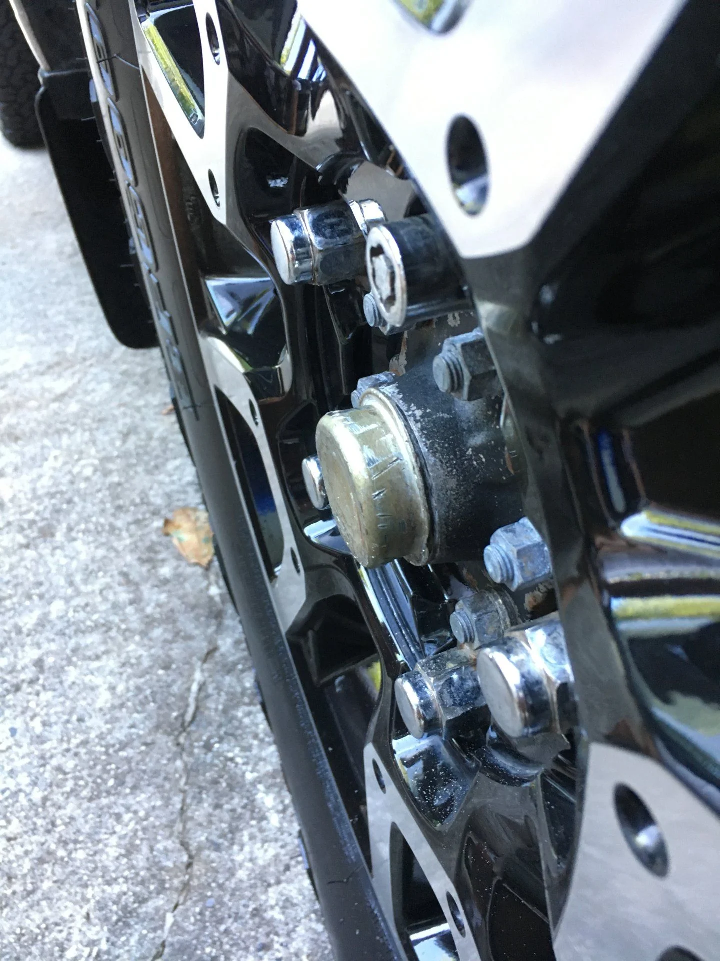

The only issue I am aware of is the front center caps will not fit without some modifications. On my post above #242, the front center caps fit just fine after flattening out the dust cap and grinding out a little of the inside of the cap.
How did you flatten out the dust cap, just picked up a set these wheels and some TRD caps?
Thanks

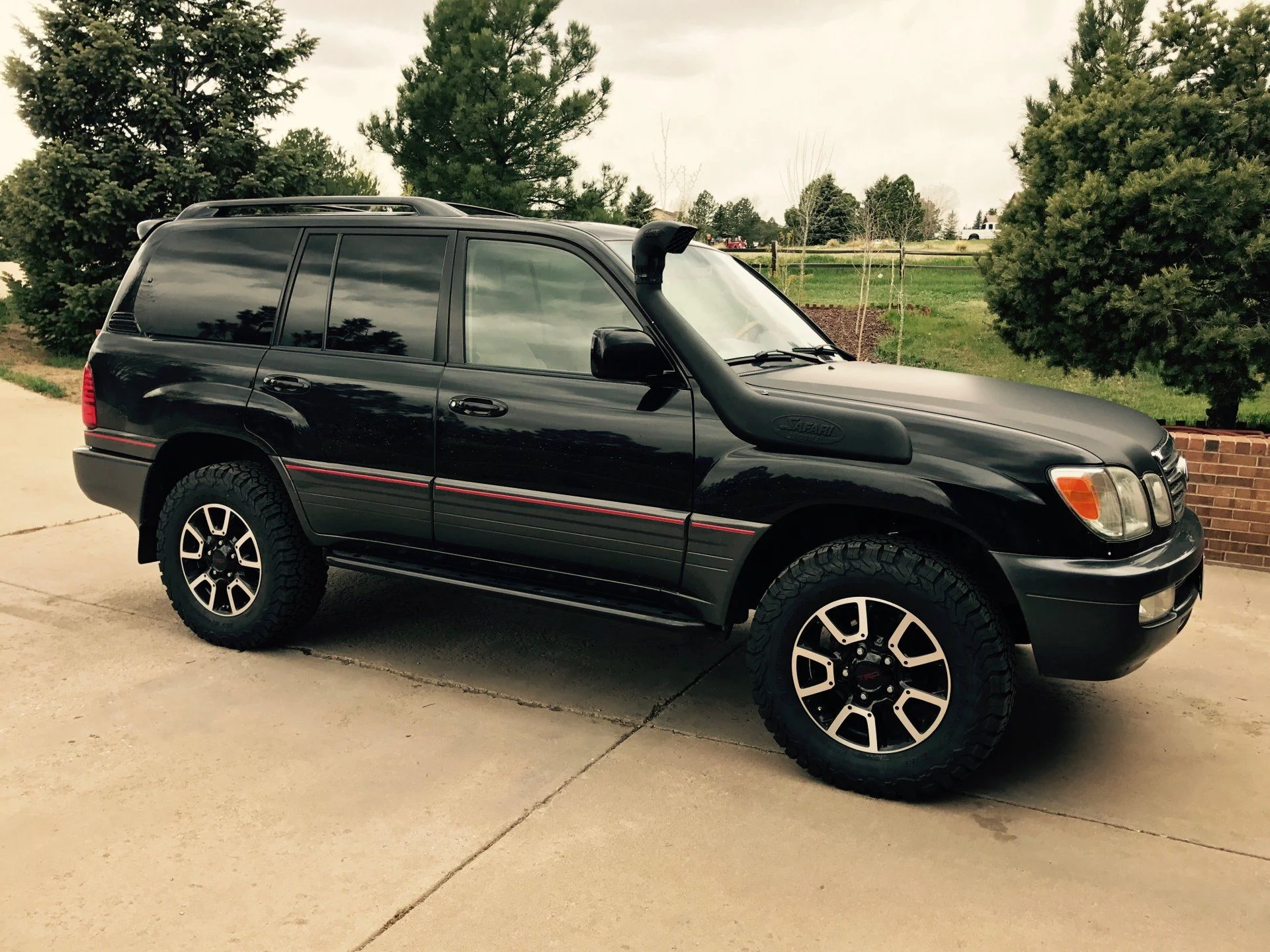

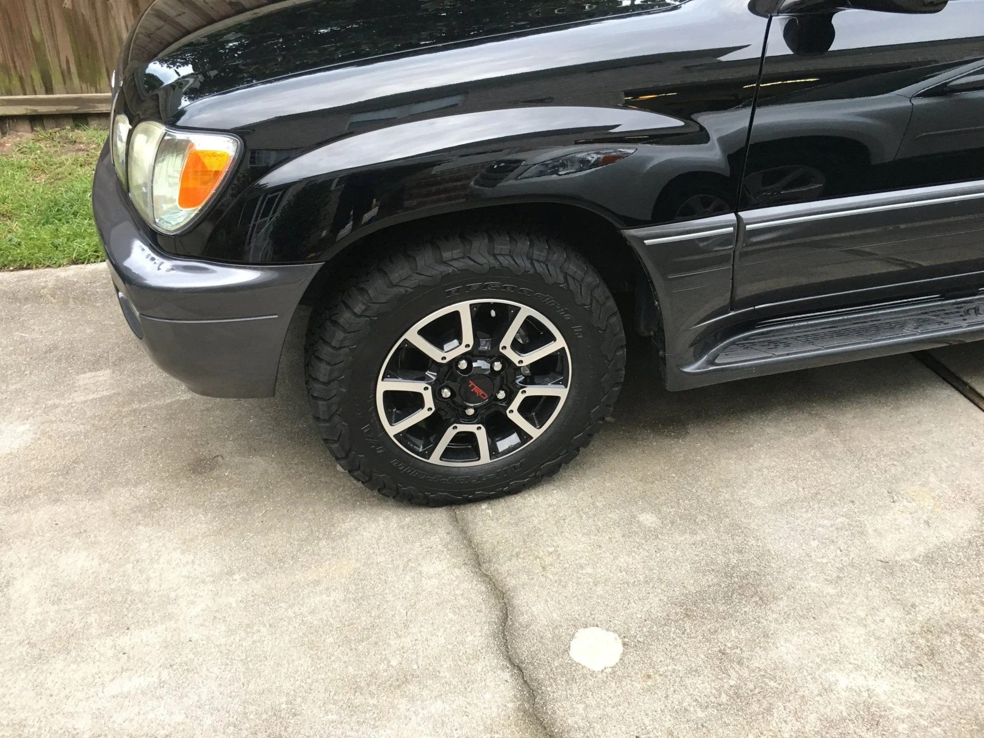

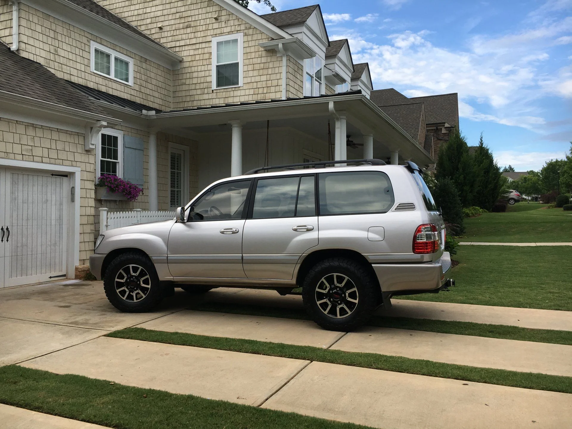

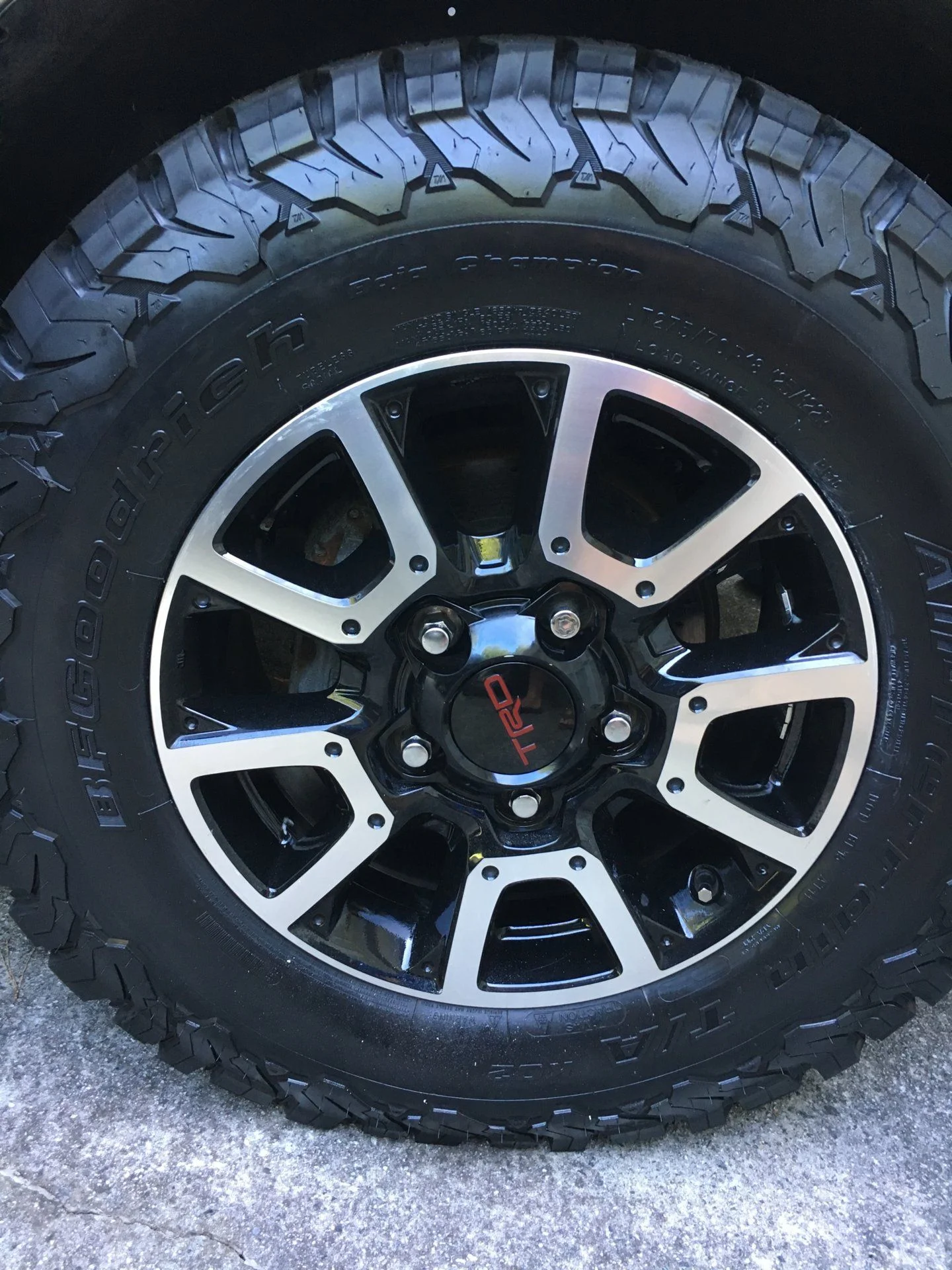

Put these takeoffs from a Tundra TRD Off Road on some BFG 275/70/18s a few weeks ago. Really like the look. Flirted with getting them powder coated black, but the brushed metal look works with my color scheme.

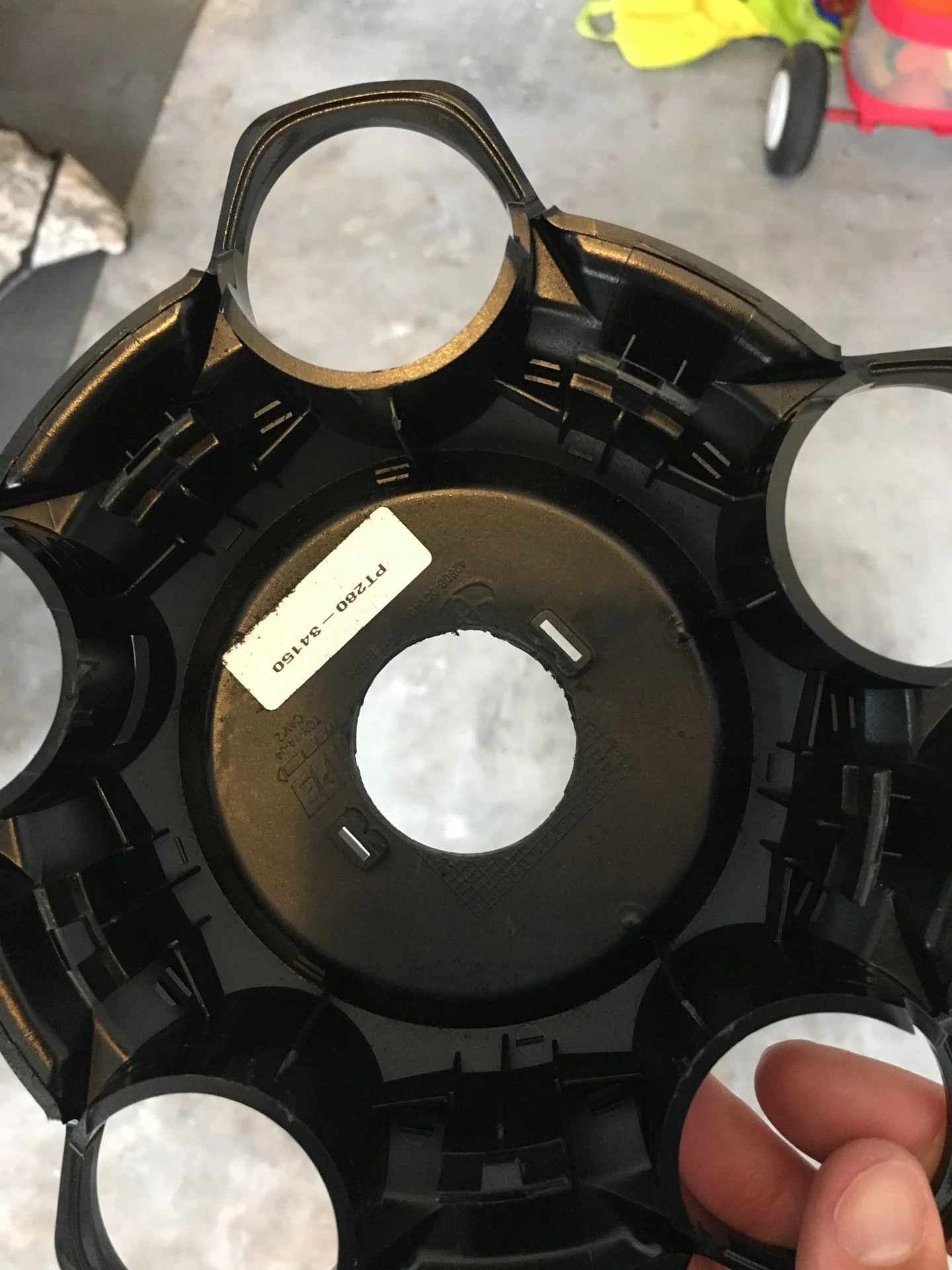

Also documented the center cap mod that others on here have done for the front two wheels. I removed the center logo from the center cap and used a hole saw to cut a hole the size of the greazd cap in the center cap. I then removed the grease cap and beat its top down flat (but be careful it doesn't lose its roundness because it still needs to fit back on). I had to grind down the sides of one grease cap as well slightly to get it to fit through the newly cut hole in the center cap. Finished product looks great.
Put these takeoffs from a Tundra TRD Off Road on some BFG 270/70/18s a few weeks ago. Really like the look. Flirted with getting them powder coated black, but the brushed metal look works with my color scheme.
Geez that looks good
Thanks

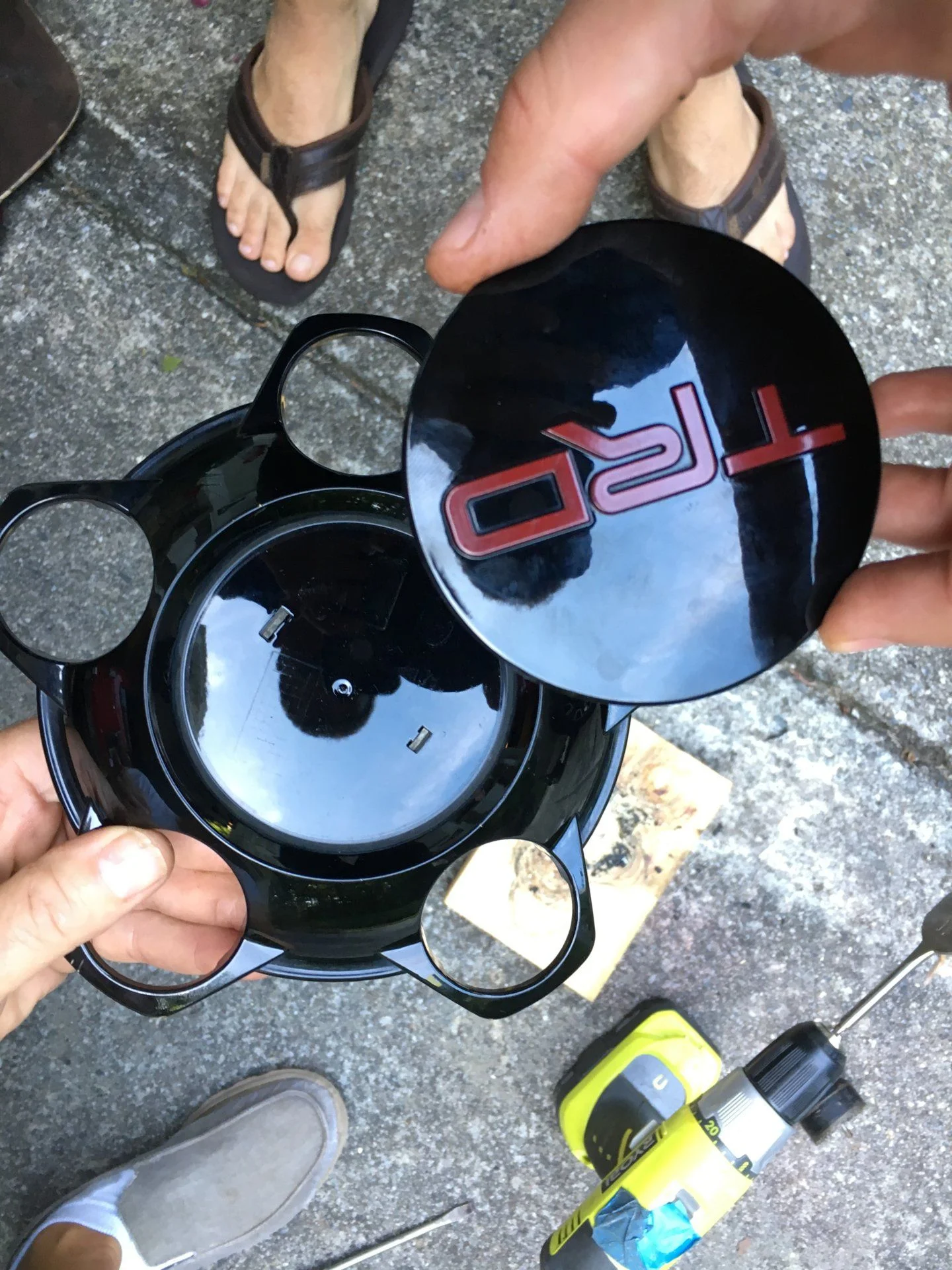

Dust caps were flattened with a small hammer. I really like the way @Roswell Cruiser did the his TRD caps with the drill. I used a small grinder and it took a lot longer.
Thanks for all the info. I used Roswell's idea and it worked great, still used the dremel for some minor adjustments. Here are some photos.

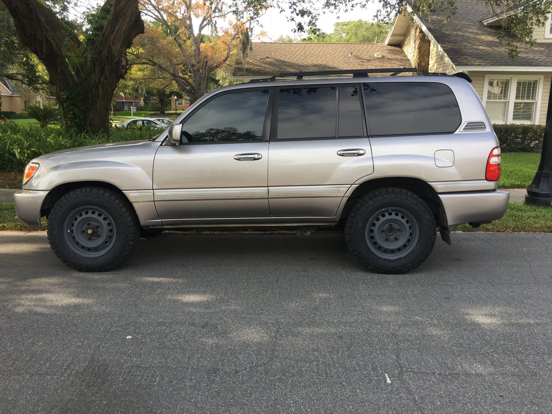

Did you have any tire rub when you put these on? Or did you have to do anything to get it to not to? I'm looking at a set of P275/65/R18s
275/75/18 General AT2
1.25" lift
Nope, no mods needed. They fit perfect. The spare will even fit as well. I'd go for the 275/70/18s personally vs the 65, because I like a taller sidewall.

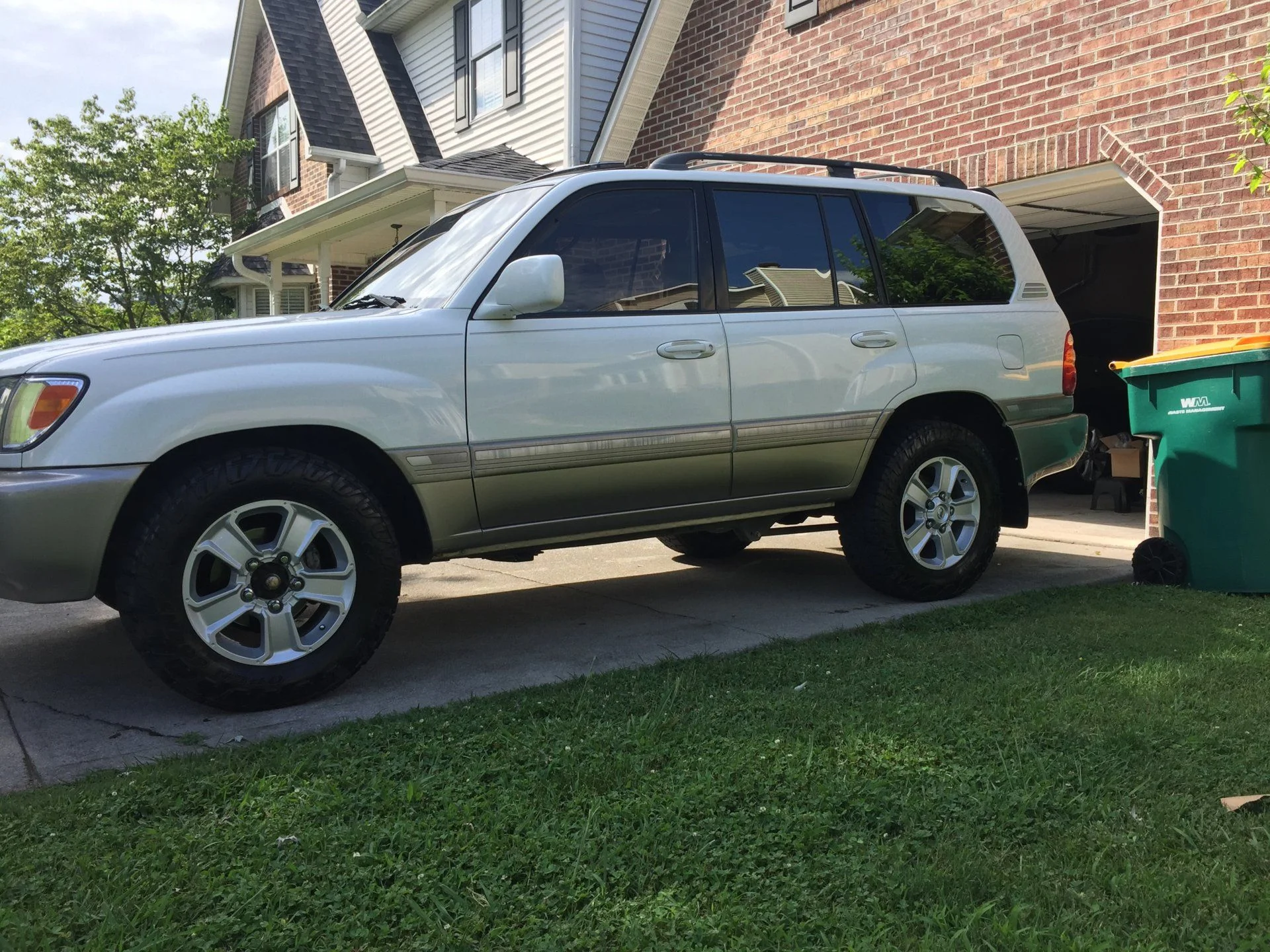

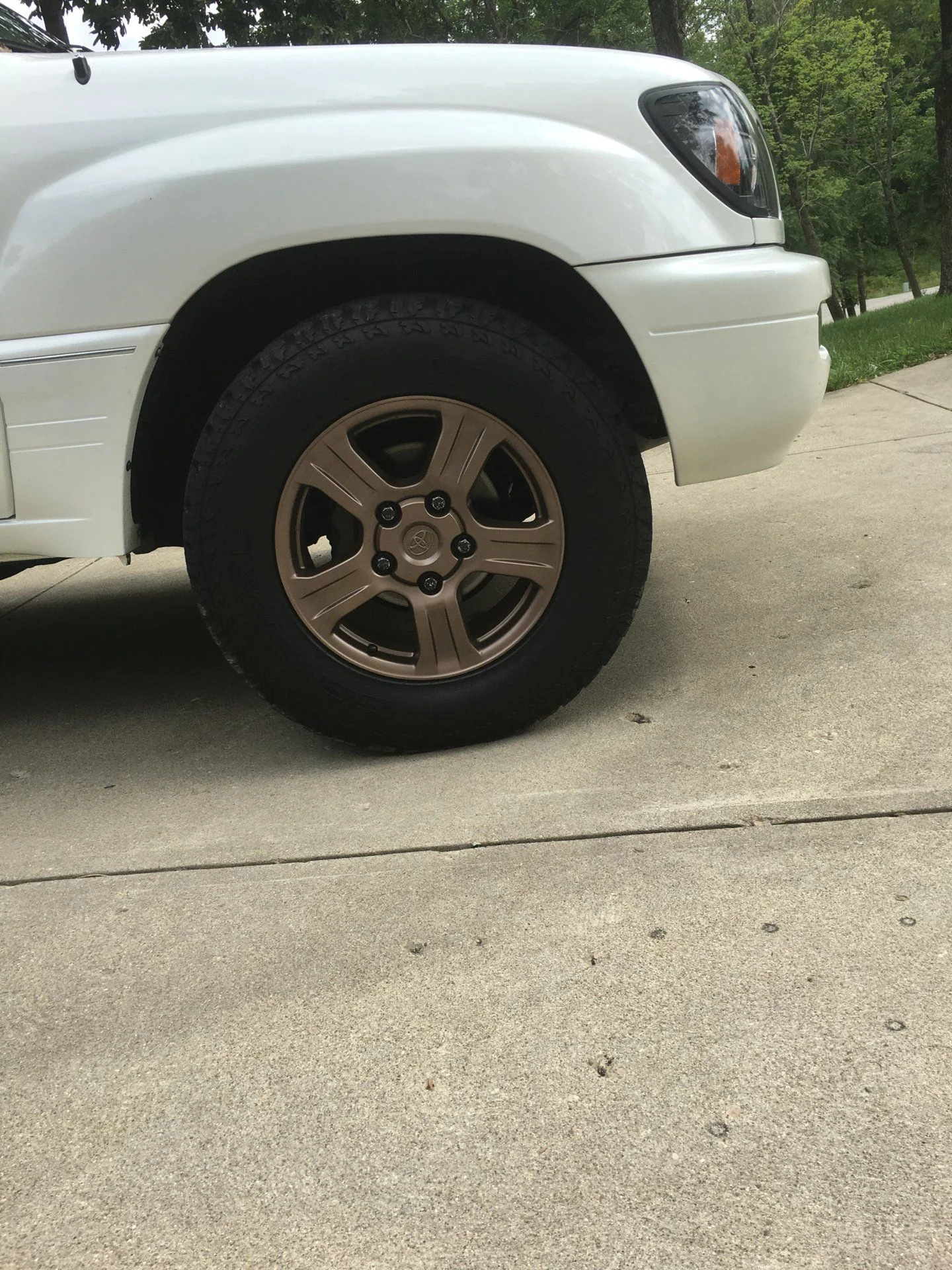

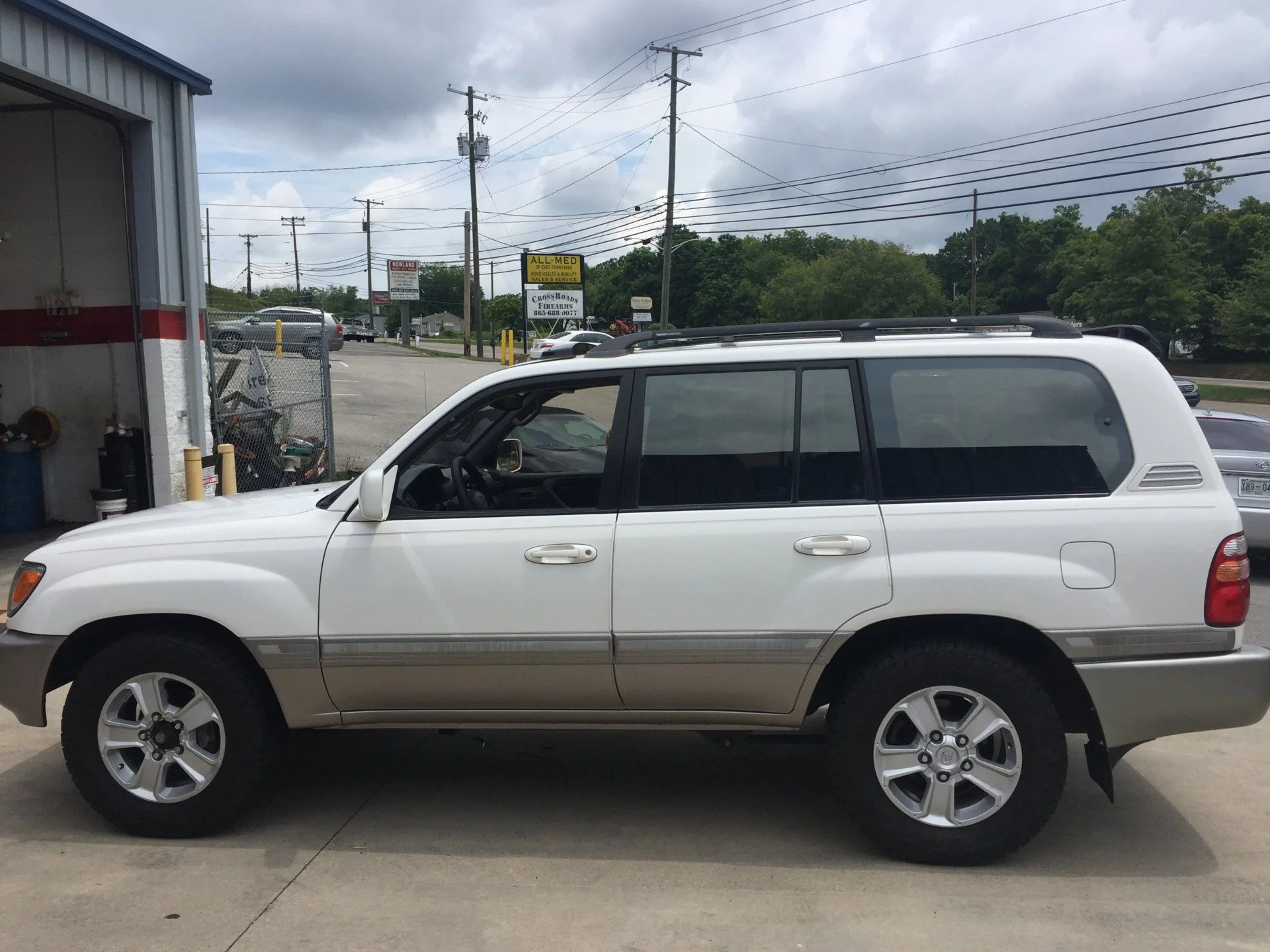

Joined the Rock Warrior club today. The stock style Michelin tires that came on it were about shot and I was able to find this set of sub-1000 mile wheel/tire Tundra take offs for less than 1/2 the price of just getting new tires. They even have the TPMS sensors. Guy just wanted them out of his super nice, climate controlled garage. I was glad to help him out! I also removed the side steps. I like the look.
Before:
After:
Before:
After:

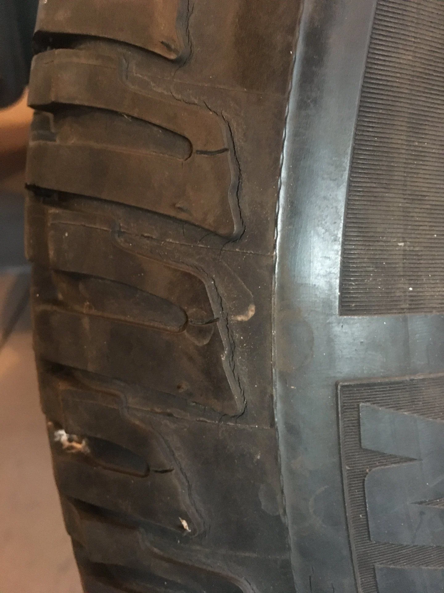

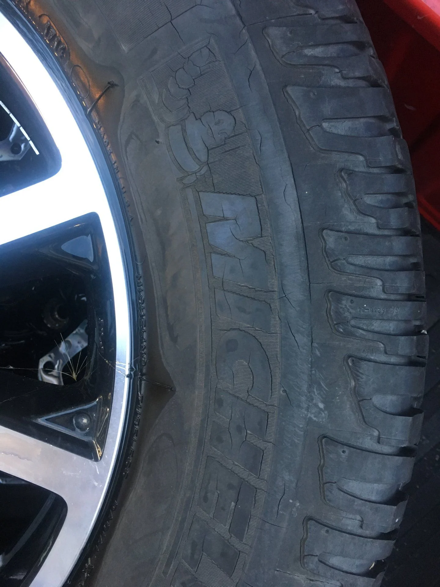

So I picked these up on CL last night for $700. Unfortunately upon further inspection in the garage this morning, they seem to be dry rotting. They came off a '15 Tundra, and were made in the 42nd week of 2014. I'm going to call the guy today to see if he'll be reasonable with me. He was in the military so they sat in the garage for a couple years while he was away.
Looking at them, are they too bad to drive on? And is this normal/would Michelin help me out?
