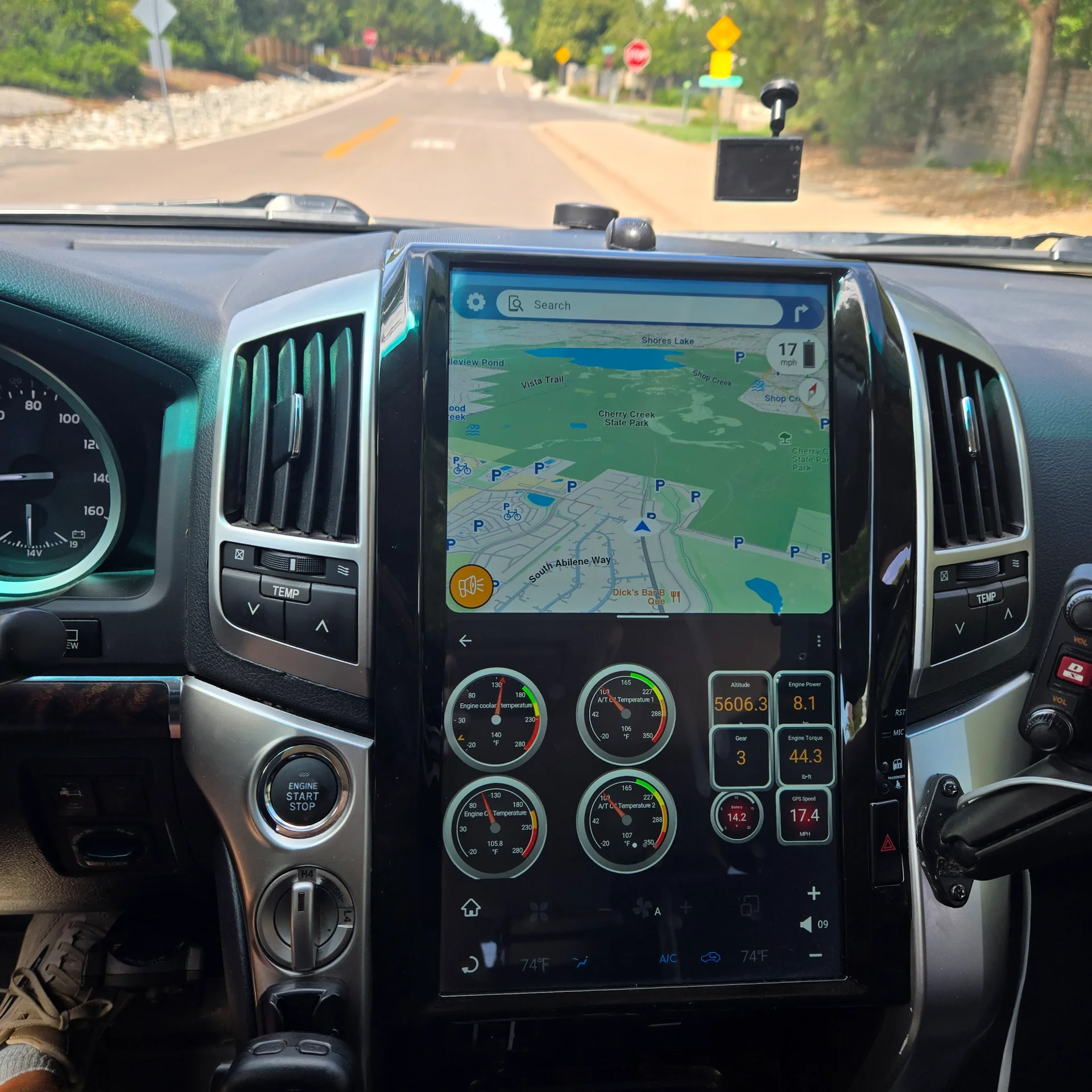

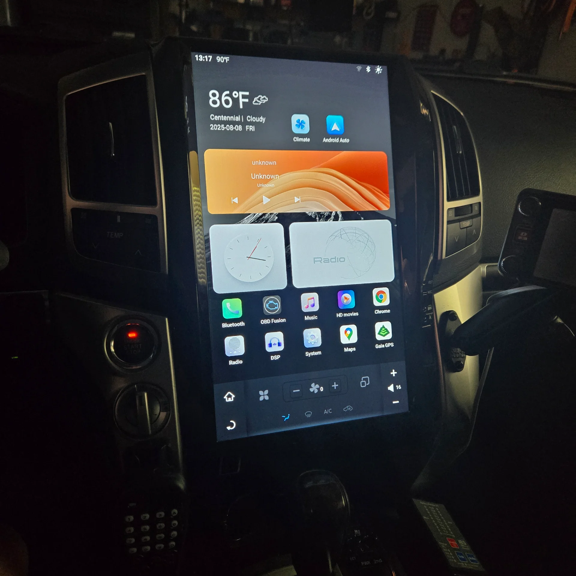

Here is what I did. Working great after a year. Android Auto has been great

It is a different solution by year. he has a 2015 which would be applicable to the same thing I did. This has been awesome in my 2014

I honestly don.t see any compromises with mine. It may be a personal thing. I do have to turn on the androidauto, but once its one it behaves perfectly. I can use my phone as a hot spot and the android tablet does whatever I need. No 3.5mm connection required. Again, it does come down to personal preference though.
