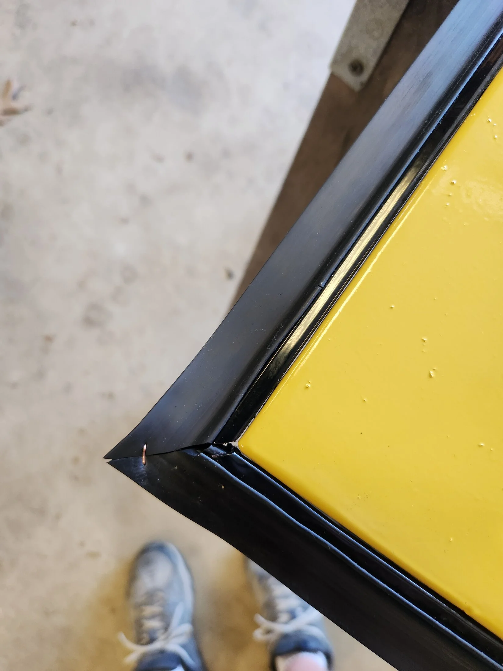

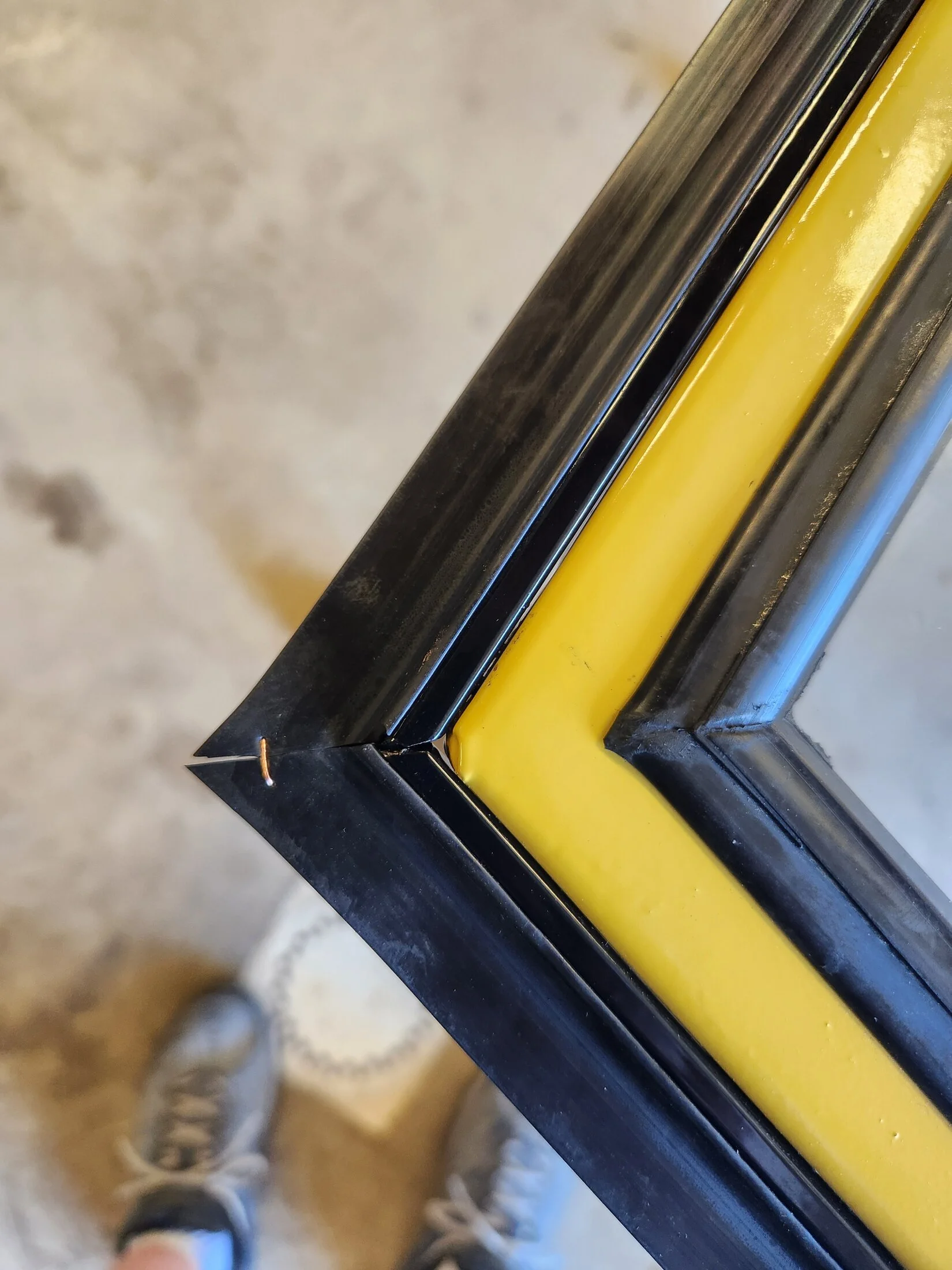

Finished the perimeter weatherstrip on the doors and utilized what I saw on the corners of FST doors dad had that were original and had rubber left on them.
Used a strand of wire from a heavy electrical wire and twisted it and pinched it flat.

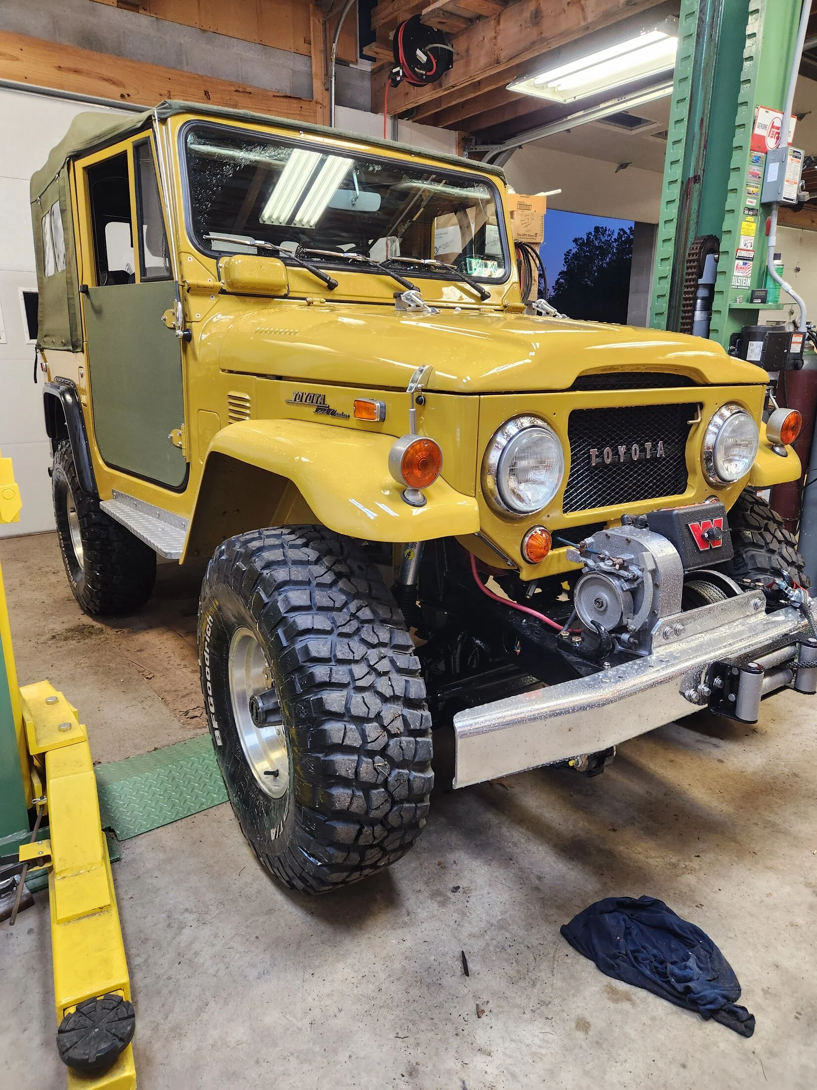

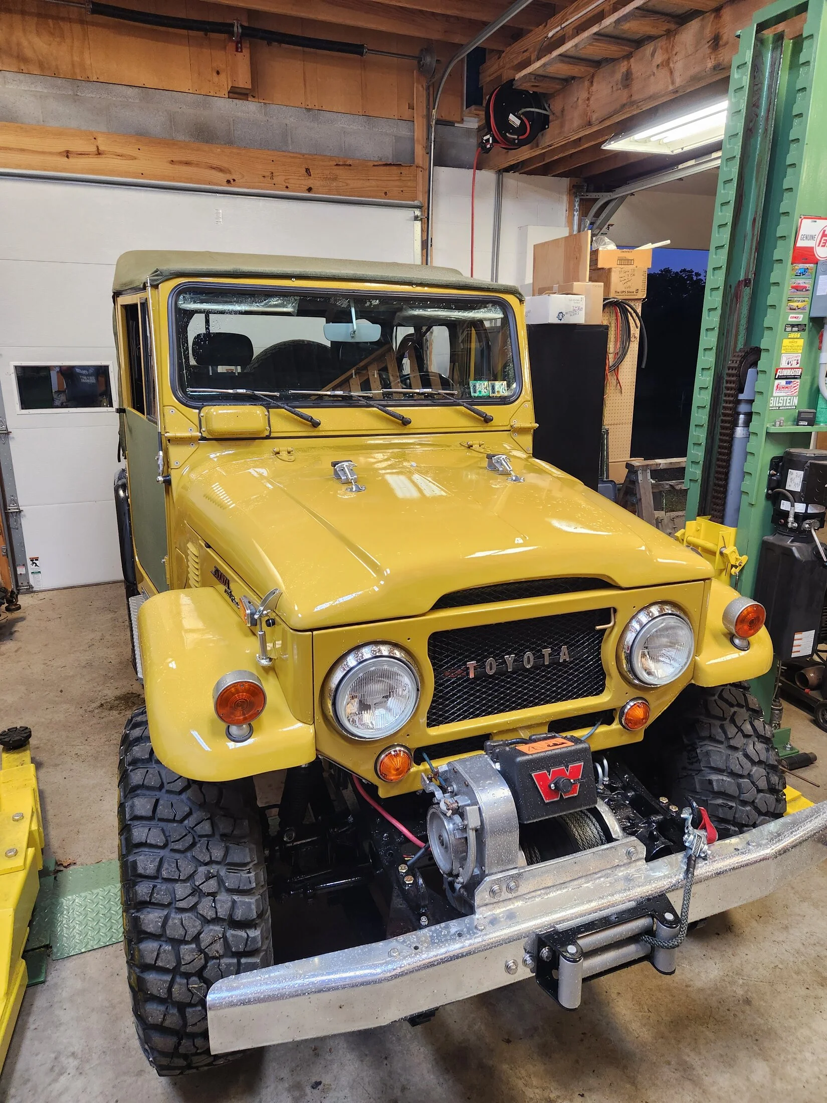

After driving the cruiser for the past year as I see in the last post here I have put some miles on it. Drives great, but still have a few things to finish up.
The AC was finally charged at the beginning of the month and have been enjoying the comfort of Air Conditioning. What a nice addition to the comfort! Would definitely put another Vintage Air in a FJ40!
Runs at a comfortable temp even with the softtop on, would be even better with a hard top! (still need to work on that so I can paint it.
