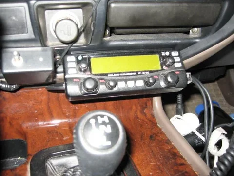

Here you can see the radio "control head" under the aash tray.

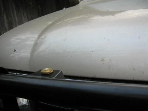

Here is the NMO mount for the Comet dual band black 37" antanna.

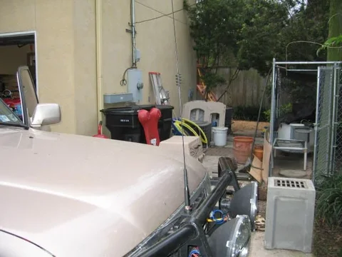

Here is the antanna mounted on the ARB
Next will be an external speaker, the existing speaker and radio are under the driver's seat.
