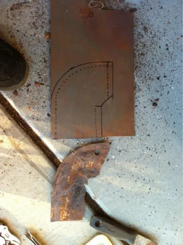

Use more cuts to make a smoother curve. The picture is not the exact type of bend but gives you the idea. Either that, or weld a piece at a 90 deg. angle to your curve instead of bending each tab. Great job. Im glad to see you plugging away at that beast. Looking good!
