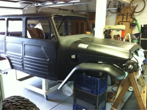

All the panels and parts are really straight, not a whole lot of rust repair needed.
bought some body tools and gave it a whirl....wow its hard and I suck. Spent about an hour banging on this dent. Not done obviously, but getting closer.
I'll get better eventually.

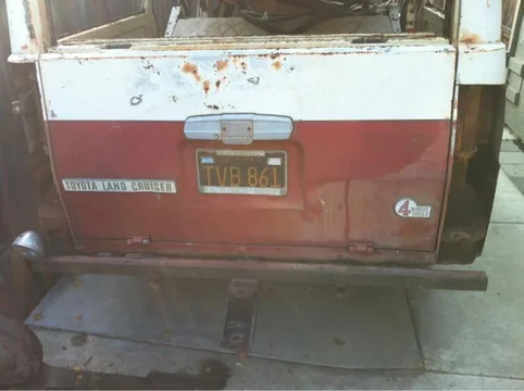

Thanks for the input!
I might incorporate something with a little more ass...im suprised the the weight of that tailgate is actually supported in the stock form.

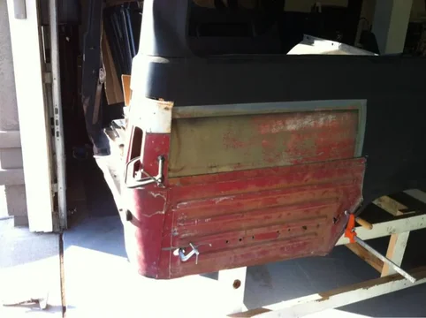

The other challenge you will have is when you cut off that lower Qtr bottom, you are going to find an incredible amount of rust and extremely detailed pieces of metal. I rebuilt mine exactly as the factory did, but had to hand fabricate every piece. You have to cut the Qrt panel above the block off level you see sticking out the end in your picture.
The donor LV was pretty bad behind that panel. But at the same time I had a hell of a time getting the panel separated from the support. Nothing a sawsall couldn't fix.
Couldn't find all the spot welds ...too much rust, so had to improvise.
