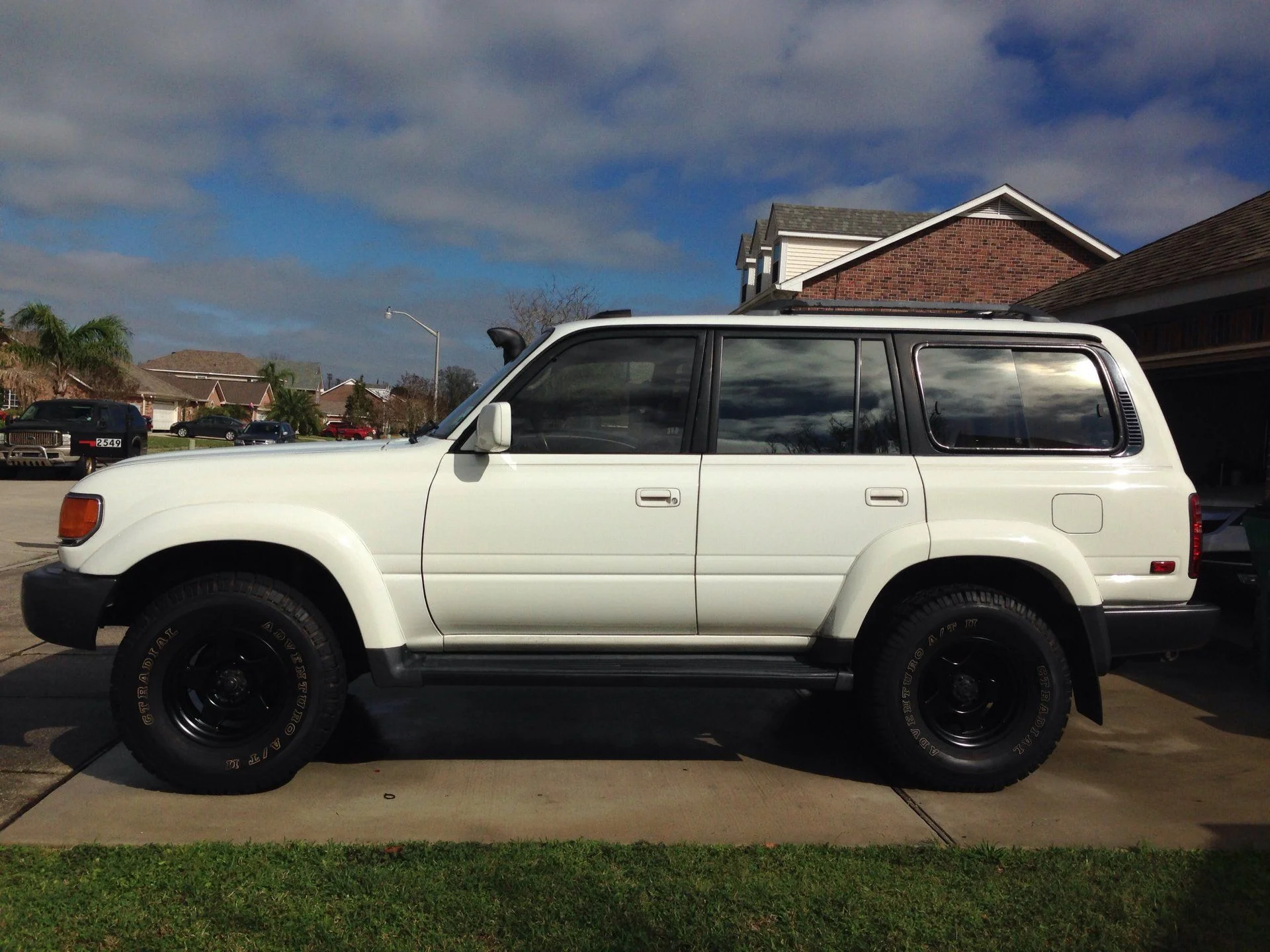

I'm contemplating about adding a rear metal bumper with tire carrier. I'm currently using ome 861/862 stock height replacement springs with MAF 30mm spacers. Future plans will include a slee shortbus, winch, and dual batteries which will lower the front a little. OmE 861 is a heavy spring, so it'll handle the additional weight, but the rear is 862 medium. I measured the height from the center hub, so from ground to bottom of the fender is 37". Does anyone have a 2" lift springs they can measure for me? Currently have 285/75R16. The only 2" heavy springs I found so far is ironman. OME starts at 2.5". I'm trying to keep the height same as what I have now in order to park it inside my garage.

Thanks for the advice. My goal is 37" from ground to fender with a metal bumper/tire carrier. I'm wondering if anyone is running this setup in the rear?
A more accurate way to measure that most do is from center of hub to bottom of flare.
A majority of stock lift land at approx. 20" on all corners for tired stock springs.
My 862s plus 30mm gave me a 21.5"
