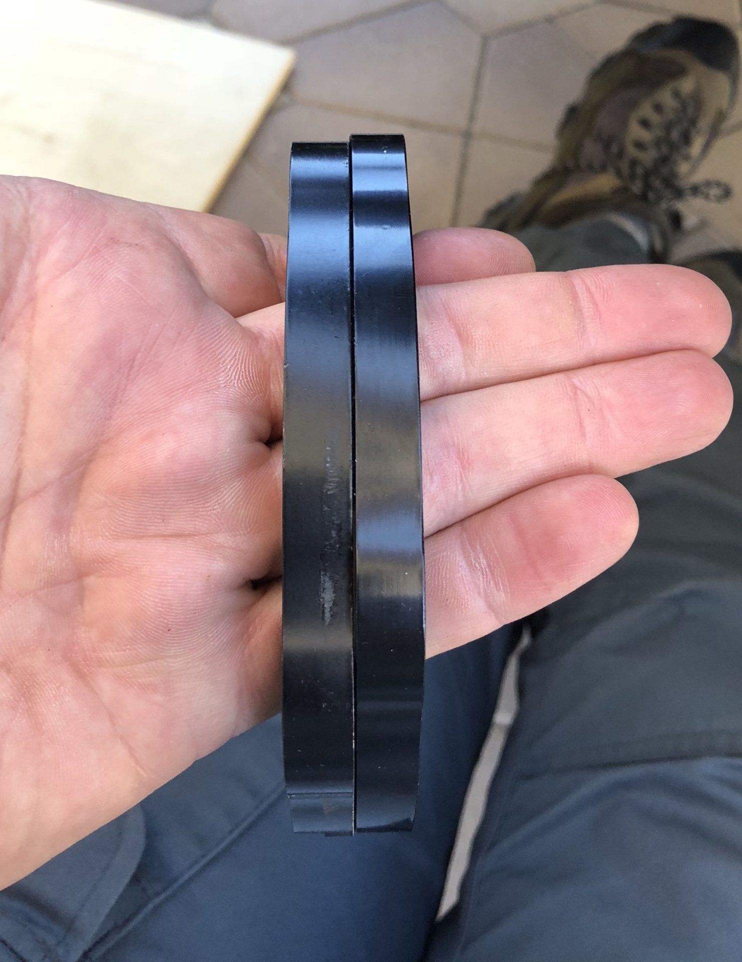

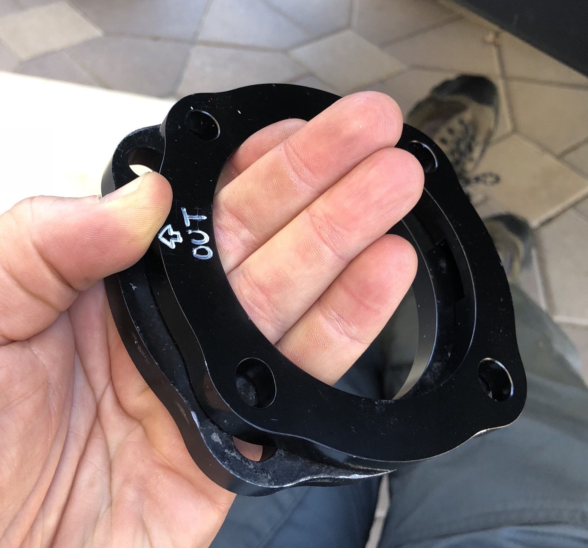

Can you post a pic of the spacers themselves?
The spacers are 1 in and 1/4 thick, from the research I did, these would lift the front end of the vehicle 2 inches to give a true level look.
At the moment the battery on my phone is dead, but I'll post a picture of the spacers as soon as I can.

Ah.
I thought you meant the spacer itself was 2"...
...which would get you quite a bit more than 2" lift. :)
