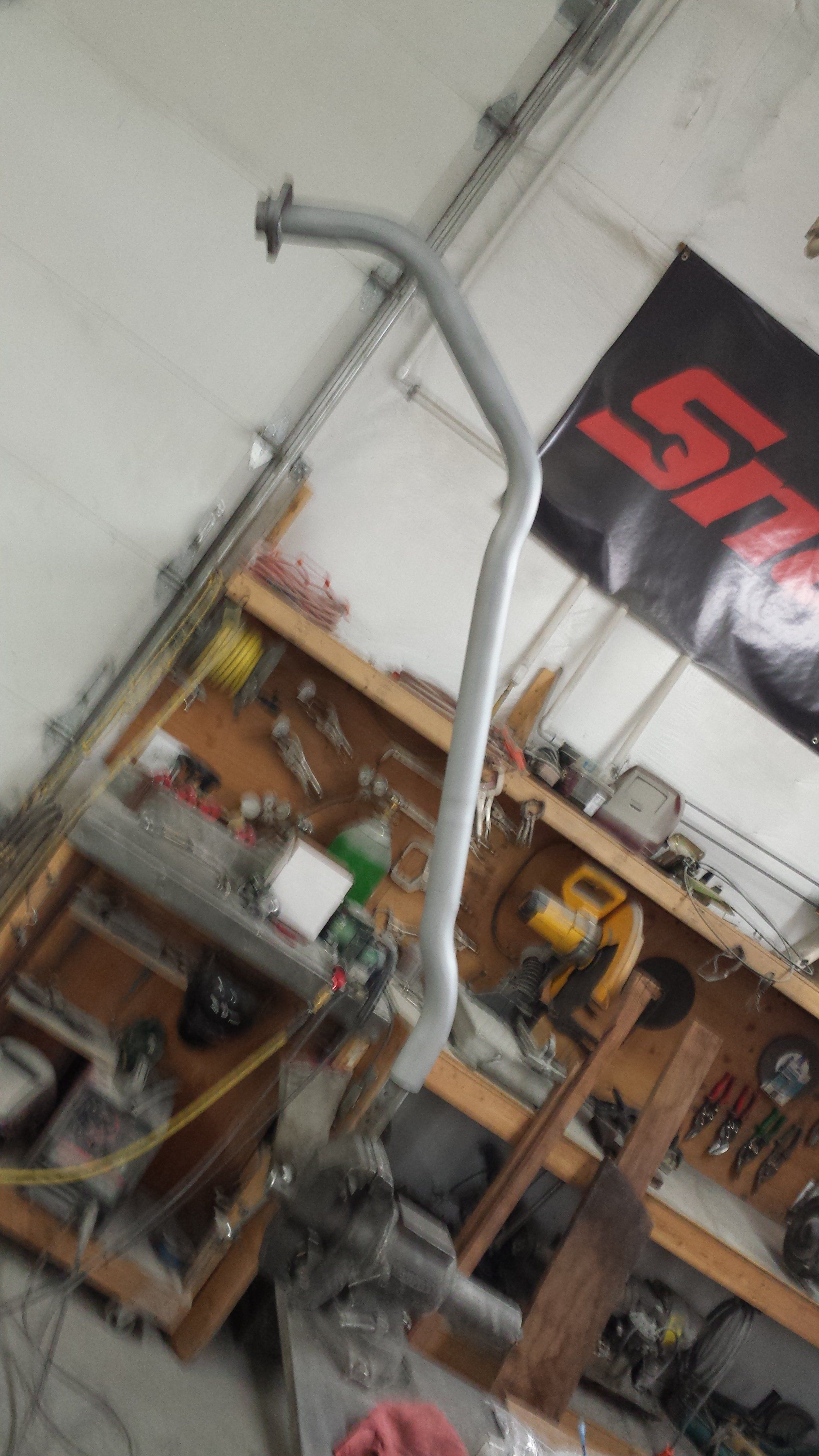

Just an idea that worked for me...since the 76 flange is NLA, I attached a 78 exhaust flange to the 2 hole manifold with the Stock O ring. Then I fabricated a 2 pipe flat flange and attached it to that exhaust flange using the 78 2 hole 3 bolt gasket. Next, the two down pipes were joined into a 2 into 1 y pipe and attached to the single exhaust pipe. I know this sounds confusing but it was really easy. Please excuse the welding in the pics. I’m just finishing up rebuilding the motor so that’s why it’s disassembled but I’ve been running this for the past year with no leaks.

Here are two pictures that should help you out.
The sketch is a little light (only had a red pen :confused:) but note the 2 1/8" at top is O.D., as well as 2 5/8" to the outside of the flange.
It looks to me like a 2 inch pipe was expanded to 2 1/8" at the inlet end illustrated below.
The flange was slipped on and seal welded to the pipe.
