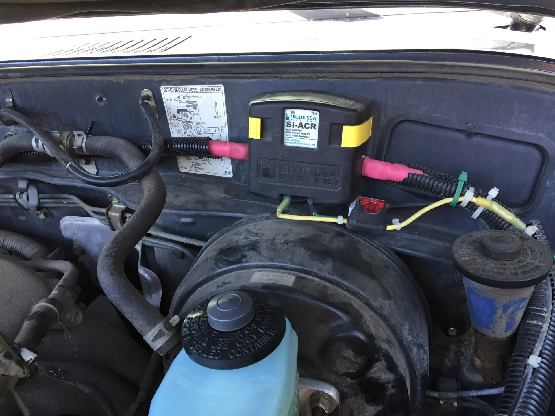

@Cruiserdrew thank you, this clears it up 100%. I read the install manual of the 7610, specifically the wiring diagram looks very straightforward.
Can I bother you for a picture of one of your dual battery setups with the 7610. Specifically the position you mounted it, wire gauge, fuse blocks and grounding. I'm going to scan all the other pictures of other setups as well.
Thanks again.
Noah
Here is my most basic install. The wires from each battery (+) to the ACR are 2 gauge, fused with 150 amp fuses at the battery. The small visible fused wire you see is a ground. And the tiny green wire is the LED that lights up inside the cab when the relay is closed. This lets you tell at a glance if the system is functioning normally.
The other side of this is the 2 batteries grounded together and each to the engine. I feed the interior panel directly off the #2 battery.
You can make your install fancier with bypass switches and the like but you don't need too.
