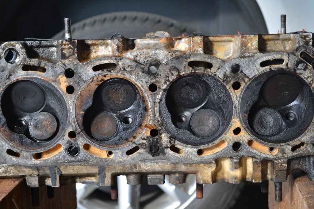

So pulled the head, no obvious visual indicators of a problem. head gasket is intact. What to do? I will post pics in a bit.
I would play with the valves one more time. Since that one exhaust valve was stuck, there could be some debris/carbon build up causing it to not seat fully, or a bent valve...or two.
Going ahead and having the head re-worked. Local shop comes recommended and seem reasonable. They told me they use a soda blast rather than sand blasting to clean things up. They claim this process is better on the small passages in cylinder heads. Thoughts?
I would tend to agree , they also need to flip the head over assessed check around the valves really good. Also don't know if they said anything but get it magnofluxed
Sent from my C771 using IH8MUD
Headed in the right direction

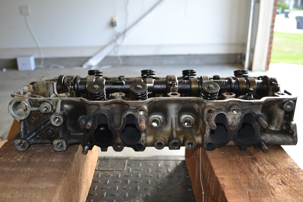

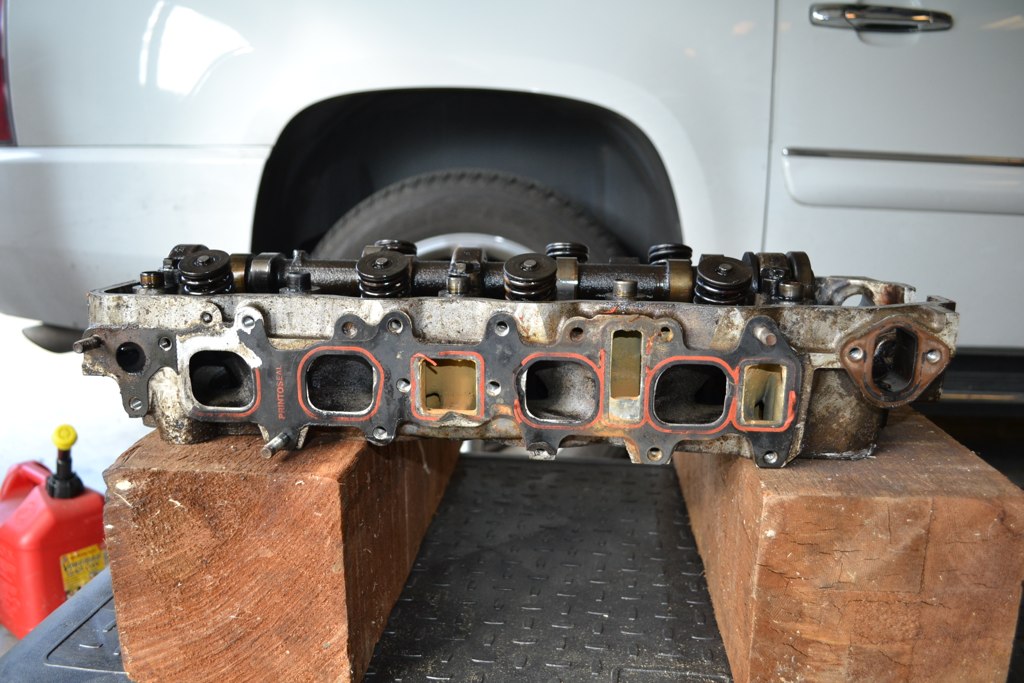

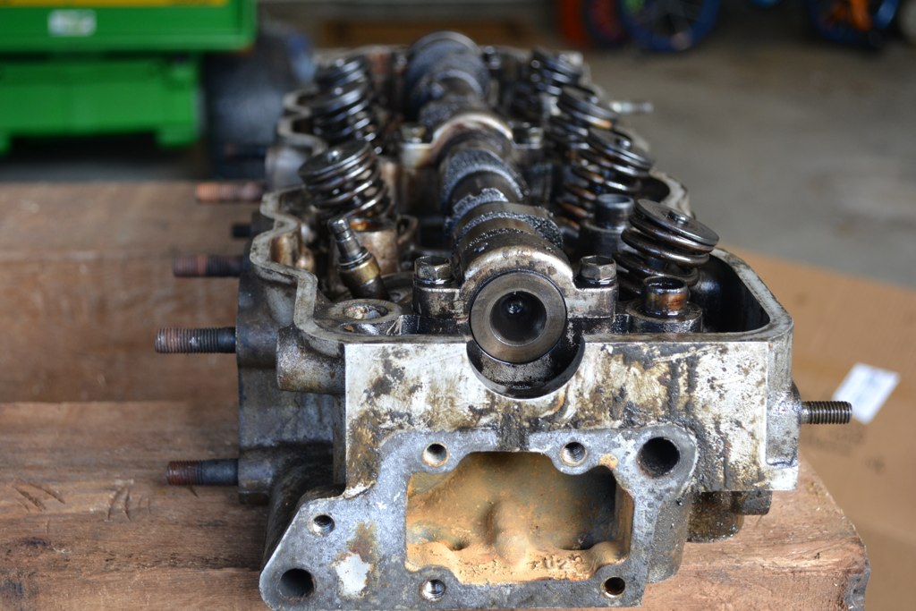

Before:
The #4 cylinder exhaust valve is not seated in this picture because i removed it and it is just sitting in the guide with no spring. it was not like this before i pulled it.
