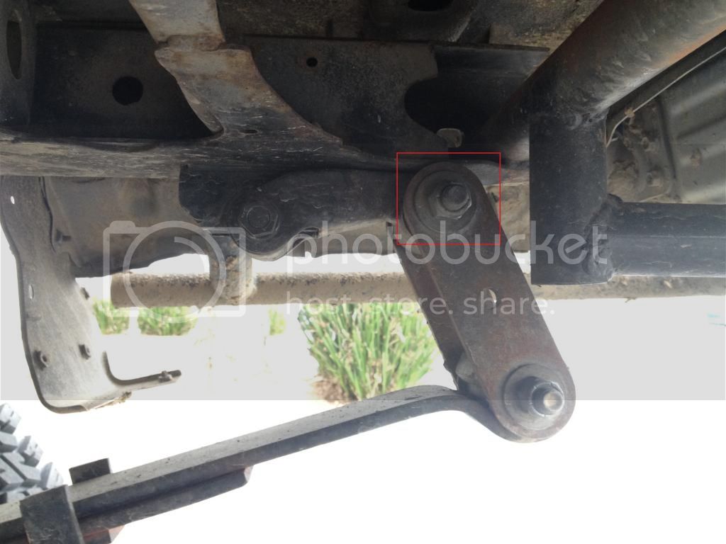

Here's a picture of my truck:
Was thinking of mounting the currently shackle on the red square and removing the 1st shackle.
Seems like if you remove the blocks and that other spacer that I see, the e-brake cable should fit over the spring, like it's supposed to.
