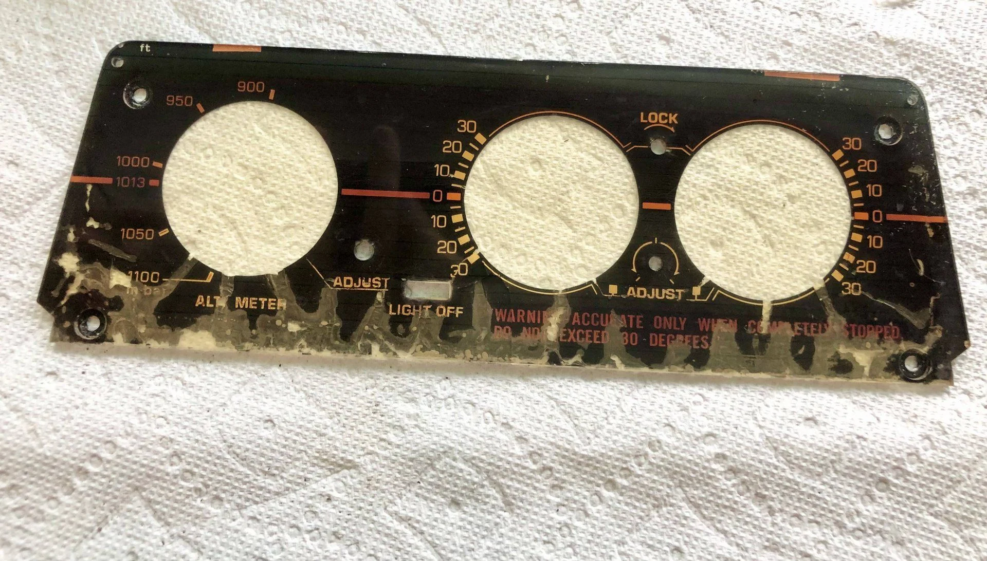

1st gen 4runner inclinometer. Any repair the faceplate?
Aug 18, 2014
194
1,209
Los Angeles
I have an inclinometer for my 1st gen 4runner and want to restore or replace the faceplate. The printed sticker on the backside of the plate is peeling from the plastic.
Thinking I might be able to inject a glue into the veins that’s peeling away but that could lead to a bigger mess.
I might be answering my own question here but I’m leaning towards copying the graphics and having it printed out.
In that case, would anyone be interested in that?

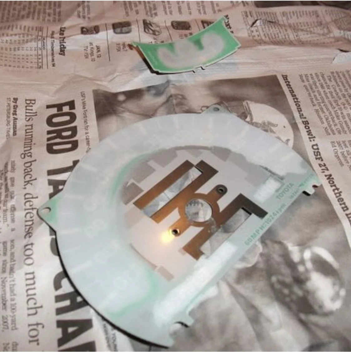

I give up, how does the silkscreen come off? Heat?

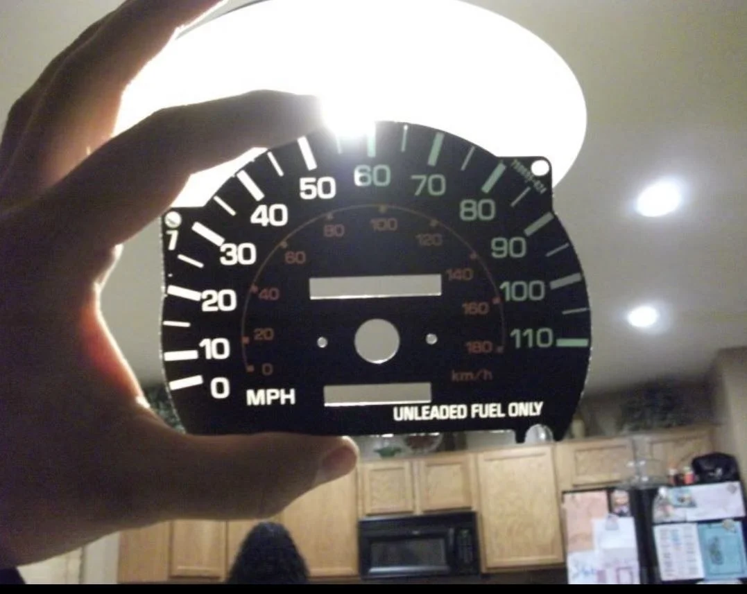

Alcohol, Acetone or Thinner. If you use acetone or thinner you need to be very careful not to melt the plastic. Some of the Toyota gauges have a green layer on them. I wanted my gauges to be white in my Pickup so i actually sanded off the green
Here is what some of the faces look like
