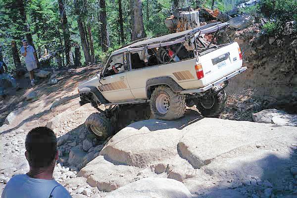

They are dead sexy!!! :D And look sweet on 33s! :D Or like this:
