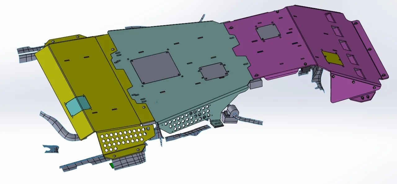

Skid Plate Update 5/28/21
Here's the start of the front skids. Going to be going with either 1/4" 5052 or 7075, or 3/16" Steel.
I decided to include a front oil drip hole, but it's removable, or it can just be omitted. I like the idea of having that extra little bit of protection in case you get snagged there. Originally I was stuck on getting it countersunk, but came to the conclusion that this will just increase the cost for more an aesthetic reason than objective. Some rounded headed hex drive bolts will do just fine.
Skid Plate Update - 05.28.21
Made the transmission skid plate that is also a cat cover. I chose to remove those diagonal support brackets for the transmission in this version. Unsure if this is the best idea, but it may be best to do that. Also made a oil skid plate to match with the new front skid.
Skid Plate Update - 06.03.21
Per some suggestions by Jim Smola on Sequoia 4WD, I added some holes in the front for airflow from the front to rear
I also change the mounting method and bends.
This is perhaps the most exciting thing in recent times, as I'm reworking the whole design by adding flush service holes & internal gussets. I was able to get a rough quote made of 5052 and it's very reasonable (considering I'm not doing the labor).
More photos to come as it updates.

Skid Plates Update - 06.26.21
Big updates to the front skid plate! Added gusesets, air channels, flush oil drip, and more! Much excited for this. Next is the transmission skid.

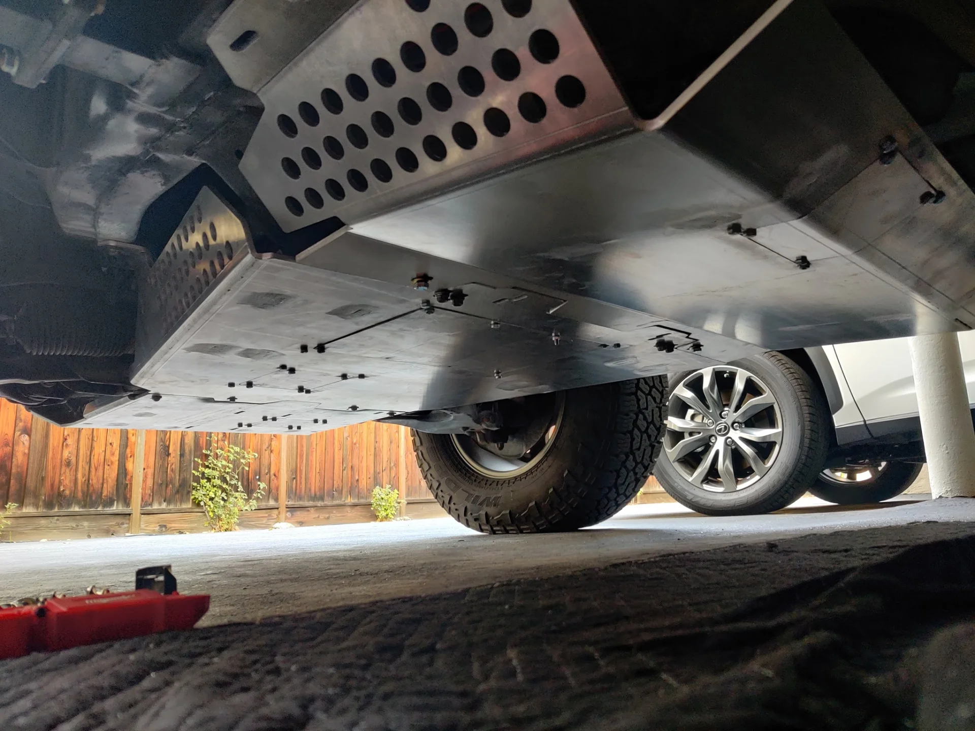

Skids update.
Just a small update, but the skids are complete. Access holes for all the goodies and more. Drilling for nutserts for tcase required. Covers front and rear of the cat.
Making 1 unit out of 1/4" 5052 to verify its good and then moving forward with making a small batch of <5 for some other sequoia enthusiasts to try and recoup my costs and my unit. Very excited.

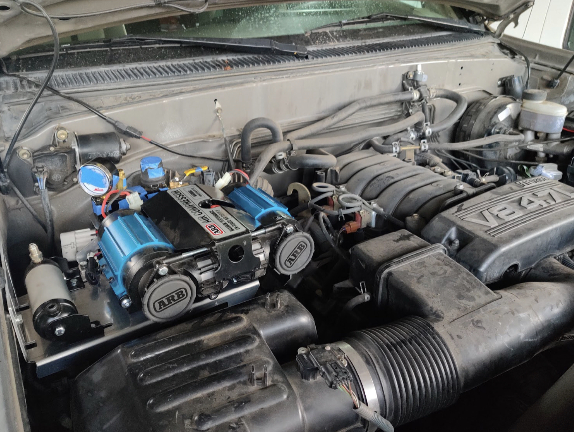

Compressor Update
Ran a small run on an updated compressor bracket. It fits PERFECTLY & install was very easy. Drilling + nutsert required, but it was all worth it.
Made of 1/8“ 5052 Aluminum and weighs less than 2 lbs with brackets.
Very cool features and nice build methodology. Between you and Sal R lots of ideas roll through my head. Just joined the site after seeing your dash mount. PM’d you my interest in a future order. I installed a second battery in your compressor location so I need to find another spot for the compressor. Looking forward to see what else you come up with.
Thank you! Ah yes, i was trying to plan around the battery bracket, but I also had this extra module there. I didn't feel like figuring out how to relocate everything so I just built on top of it. I also didn't want to buy another battery personally, and didn't see myself having a house battery. I'd rather use a portable lithium battery.
Currently I'm thinking of updating the compressor mount with a tilt mechanism so I can access the ps res better but that'll have to wait til I have more time to think it over since it needs to tilt, and lock in place and be budget friendly.
I saw that the GX platform has compressors mounted near driverside firewall but the brake master cyl is there and it's not as pretty / compact like the GX. There's also mounting it sideways or diagonally along with passenger side of the engine but the mount would be very complicated with all the wires and hoses there. I'll try and think it over and see if there's a solution to this.

It would barely clear with the hood closed. Once I added the 1/8 plate and some clearance for the abs module, it wouldn't work. It's shy by about 1 inch.
I could revisit it, but in this scenario the whole air port needs to relocated to an external manifold to work that is low profile.
I'll think it over the weekend. Anything is possible with a few brackets. There's a few bolts that can be used on the firewall for this

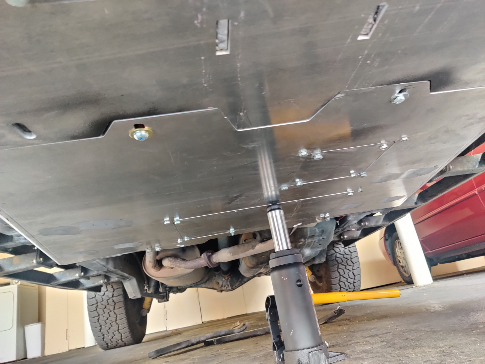

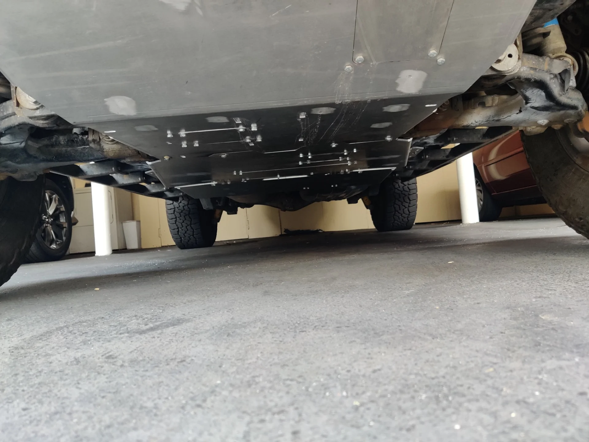

Skid Project Update
Relocated temporarily so I don't have all my tools and couldn't get my skid plates completely finished, but I was able to get a fit install for the front + transmission skid I made.
Fitment is about 95% there, and just a few adjustments need to be made to make it perfect for install. Very excited to get the TCASE plate installed this weekend.

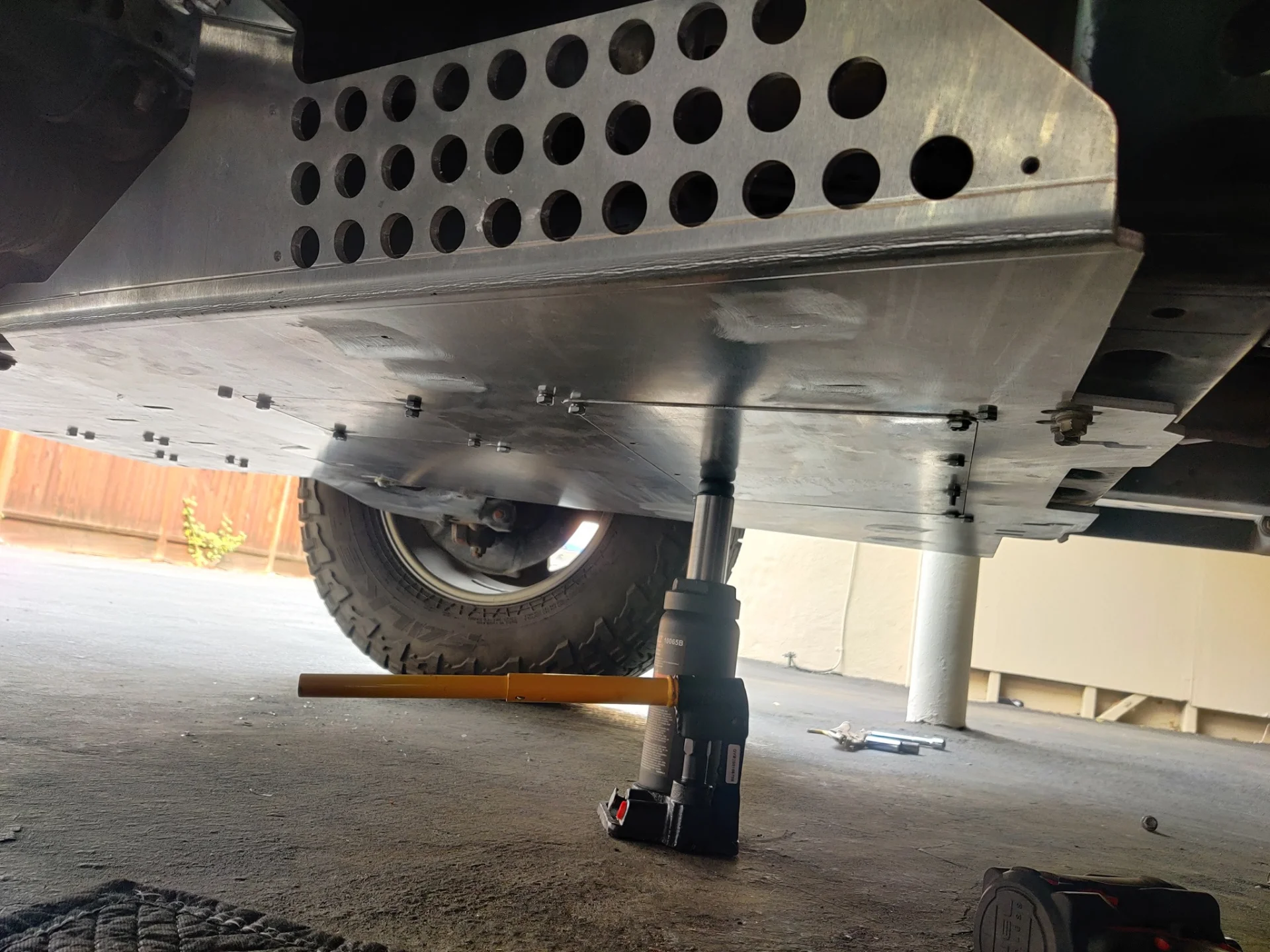

Skid Project Update
Finally finished the install of the last plate (tcase + rear cat). It's like 95% there. There are a lot of changes that need to be done to make it better to install.
Overall, 9 nutserts are required for this install & there are a few optional ones to help with extra fitment.
- 1 nutsert for oil pan skid to mount
- 2 nutserts for transmission / cat skid plate
- 6 nutserts for tcase skid.

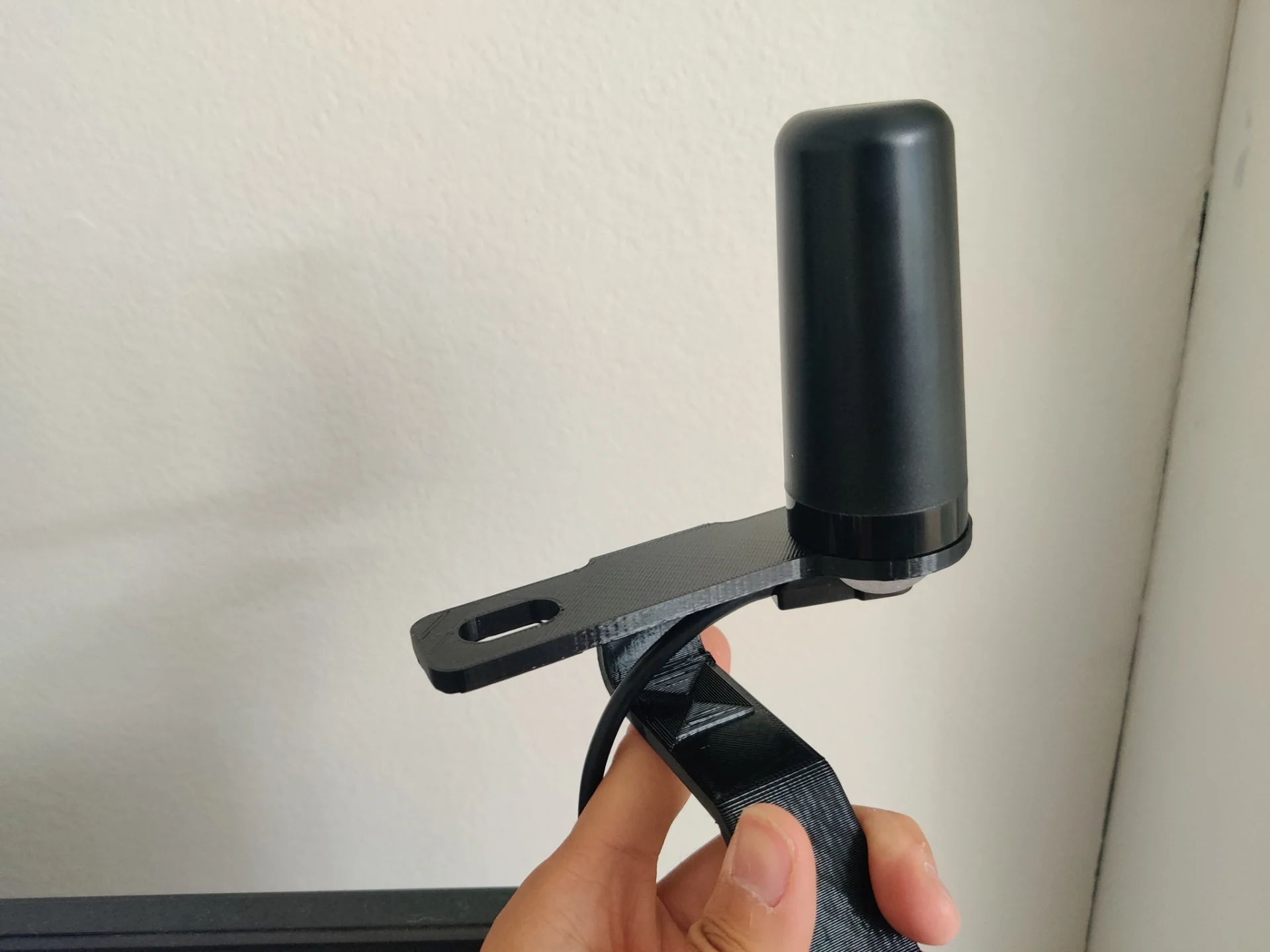

Light Bracket Project
I recently bought a midland shortie antenna, and made a mockup for a light bracket that can be installed on the passenger side. It'll be made from 3/16" 5052.
Did a test fit, but it needs a few updates to it to make it perfect fitment.

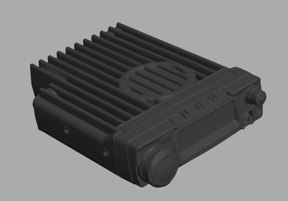

One of which will be the Midland Headunit. Got it scanned and I'm very excited to get started on this project.
