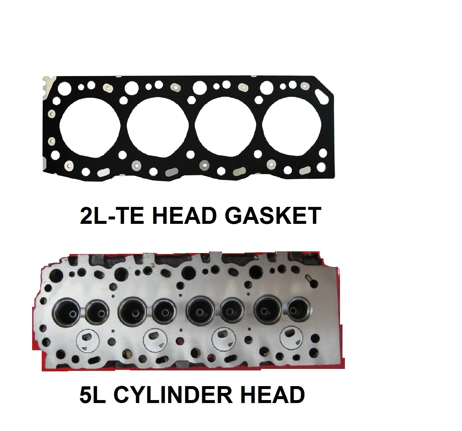

So I was playing computer nerd this morning & did a side by side image comparison between a 2L-TE head gasket & a 5L cylinder head - I'm open for comments -
Looks good!
In theory it should bolt on. I think the issue has to do more with the distance from the crank pulley to the cam pulley. I think the head is taller on the 5L. So it'll need a well thought out timing belt solution. I'd start by looking carefully at the part differences on the megazip drawings?
If I remember correct the 5L has larger valves with different camshaft etc (for more flow).
