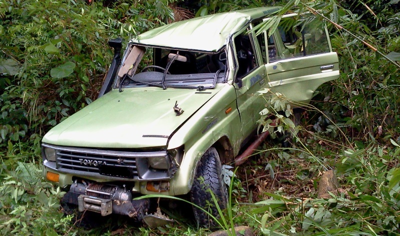

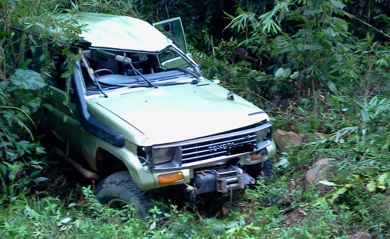

It appeared to start after my employee put the mighty green go anyway hangbag jungle wagon on its roof and back over escorting ATVS at 20kph - I still cannot understand how.
When it rolled the RADIATOR hoses were ripped out of the block.
When they fitted the new body 6 months later and started it it never ran right. Lacked power etc. Damage bill for the rebuild and fitting of bars and winch I got no change from $12,000rm

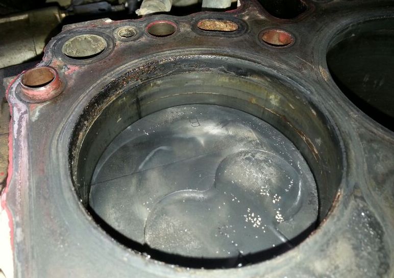

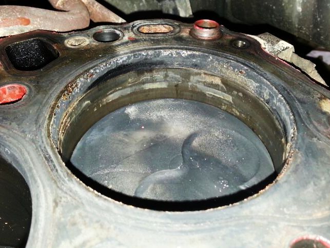

BAD NEWS almost no compression - OFF with the HEAD and the DAMAGE was revealed 2 cracked pistons.
Now its getting a total rebuild $5,500RM an they Say injector pump gone again :( and a INTERCOOLER will be fitted.
