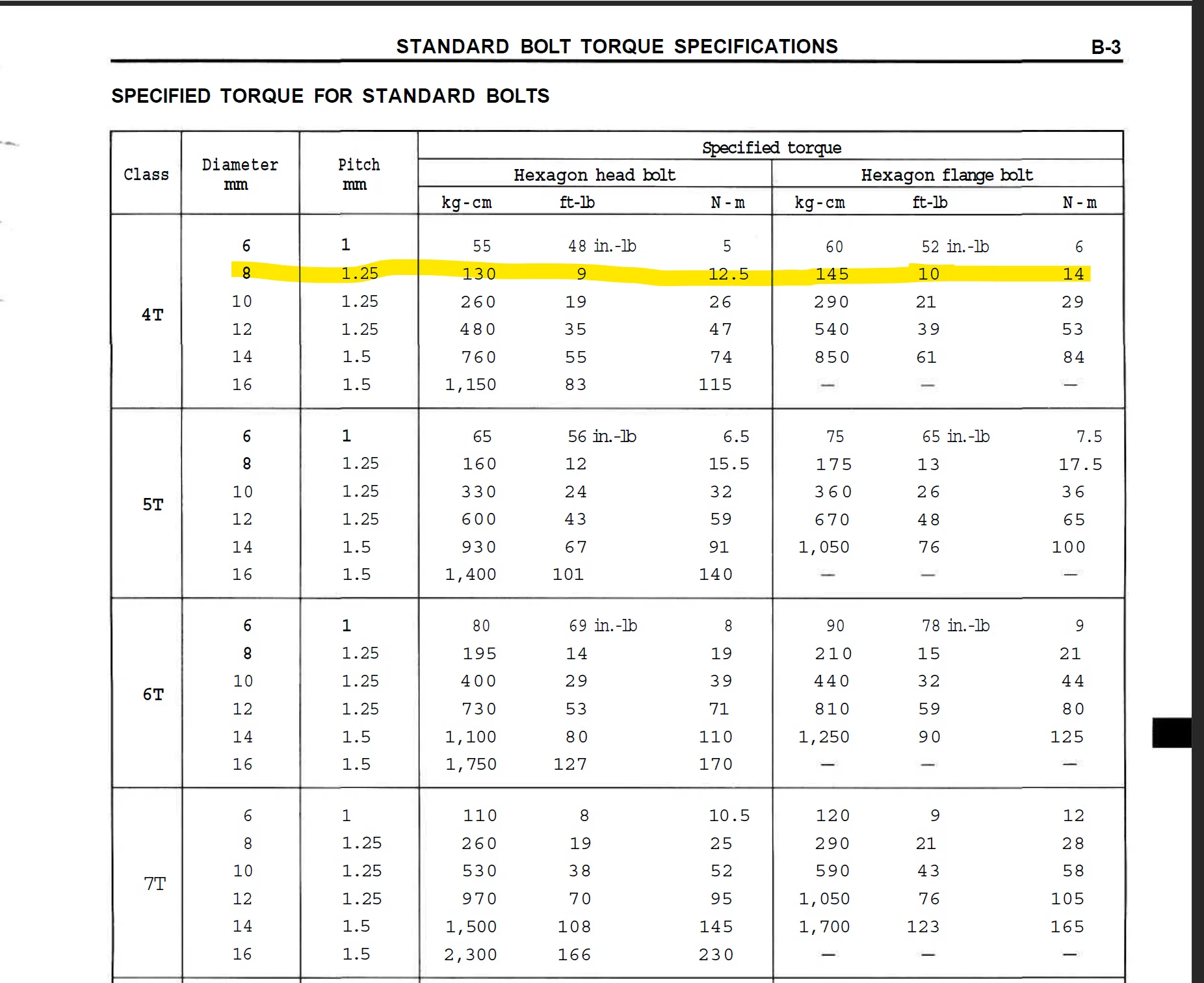

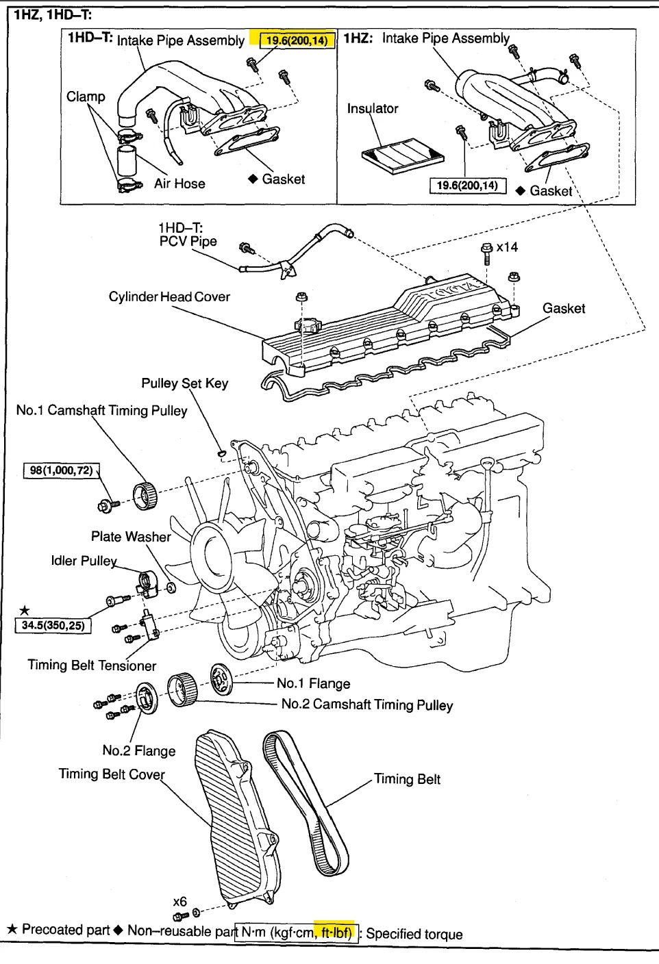

for all other bolts not listed you can refer to the Standard Bolt Torque Specifications in the FSM

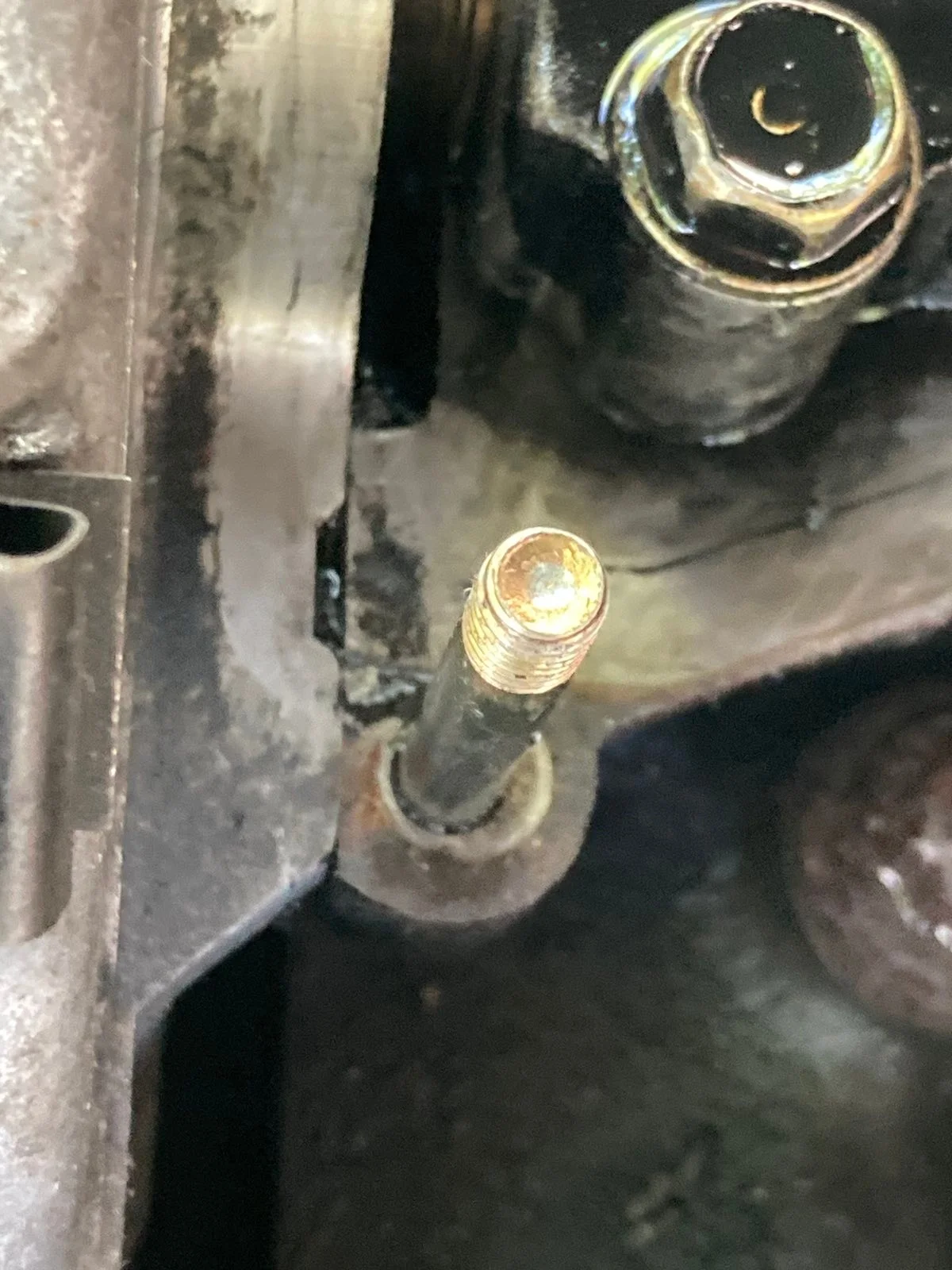

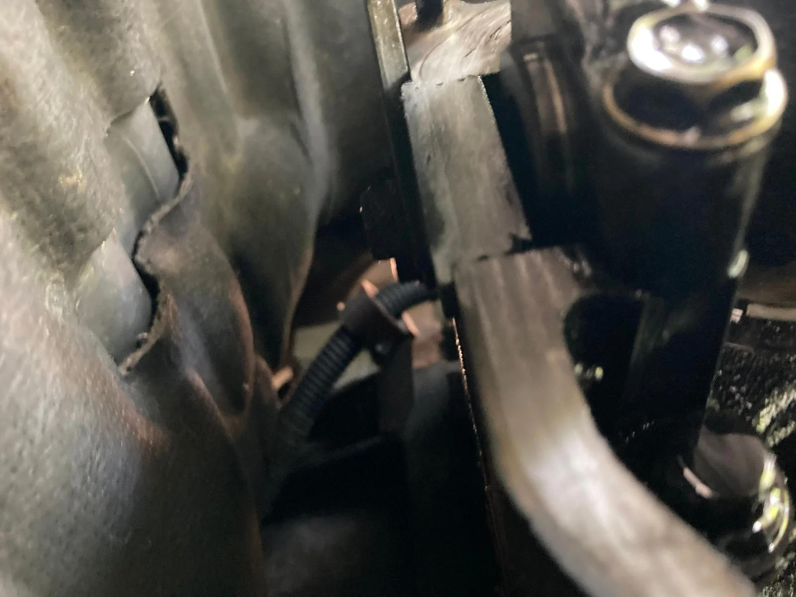

There's a reason why Toyota suggests using "Packing" (pernatex) in 4 locations on the head before reinstalling the valve cover and gasket
Its not always easy to see but dont skip this step
Current Toyota packing p/n 00295-00103
Pics of some of the locations front/back below.
Pics of some of the locations front/back below.View attachment 3361990View attachment 3361991
100% I've seen so many people who skip this step and also do not use enough and have leaks..
