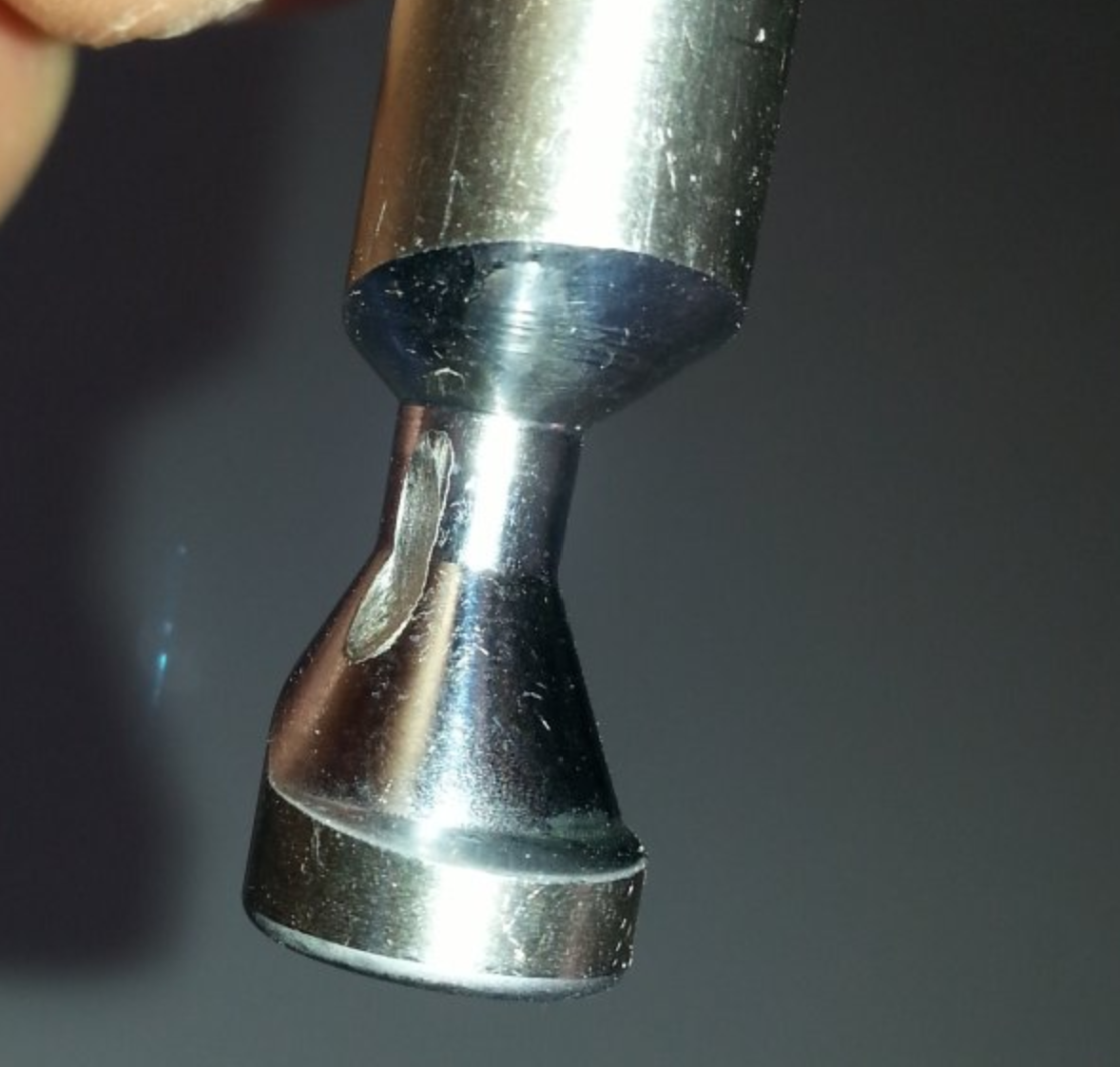

i personally would not grind my pin cant go back if you wanted to...
I went with Trundles because it claims to have been hardened to 52-54 HRC also the liner profile and can't beat the price for $70 nzd way cheaper than zeal power rod in $375Cad yeah no thanks.
I saw a Trundles pin with a groove in it as well. Are any made of chromoly?
the trundles pin is now on Version 3 so hopefully, they have fixed the issue in this revision.. mines a V3 so time will tell
its dry where the pin rides so I've also seen some people use a light coat of grease to help the pin slide

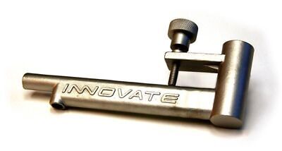

It seems like not too many people make an AFR gauge that goes over 20:1. Even Glow Shift (a diesel company doesn’t make one.
Any recommendations? I found 1 out of Australia and that’s about it.
I’m thinking of getting off of these AFR meters
Vs
Apps look identical.
As per performance electronics:
“The sensor that you can use is a Bosch Wideband A/F Sensor part number 17212. You can use the sensor that comes with the PE-Wideband Kit, however the sensor element will get clogged from the soot in the diesel exhaust. The sensor from the part number I sent you has a different design for a diesel that will not get clogged.”
