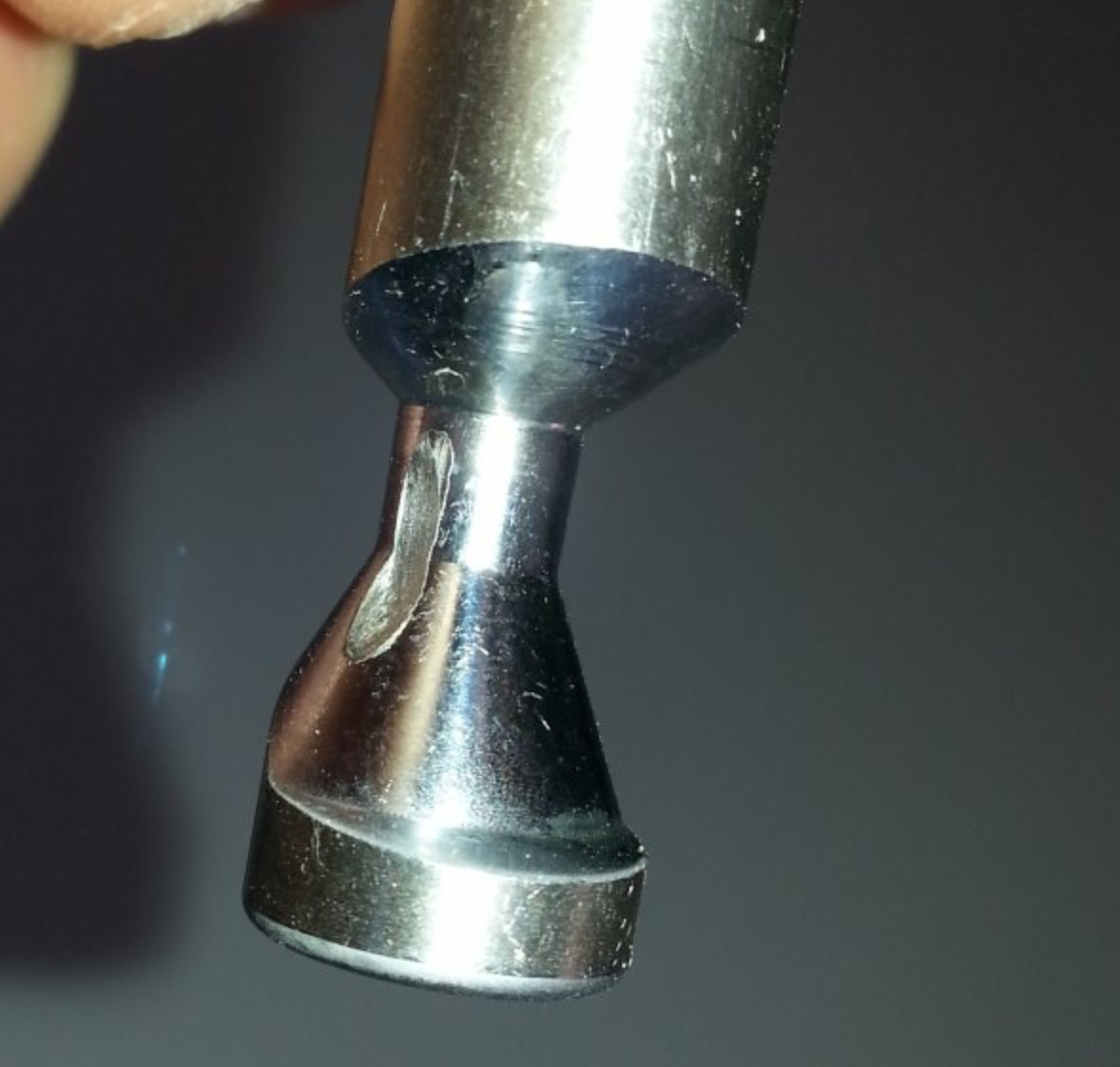

Id stay away from the zeal power rod as its made with softer material and can make a groove over time
So the consensus is to grind the OEM rod? I’ve already marked it with a paint pen to see where the follower is riding.
i personally would not grind my pin cant go back if you wanted to...
I went with Trundles because it claims to have been hardened to 52-54 HRC also the liner profile and can't beat the price for $70 nzd way cheaper than zeal power rod in $375Cad yeah no thanks.
