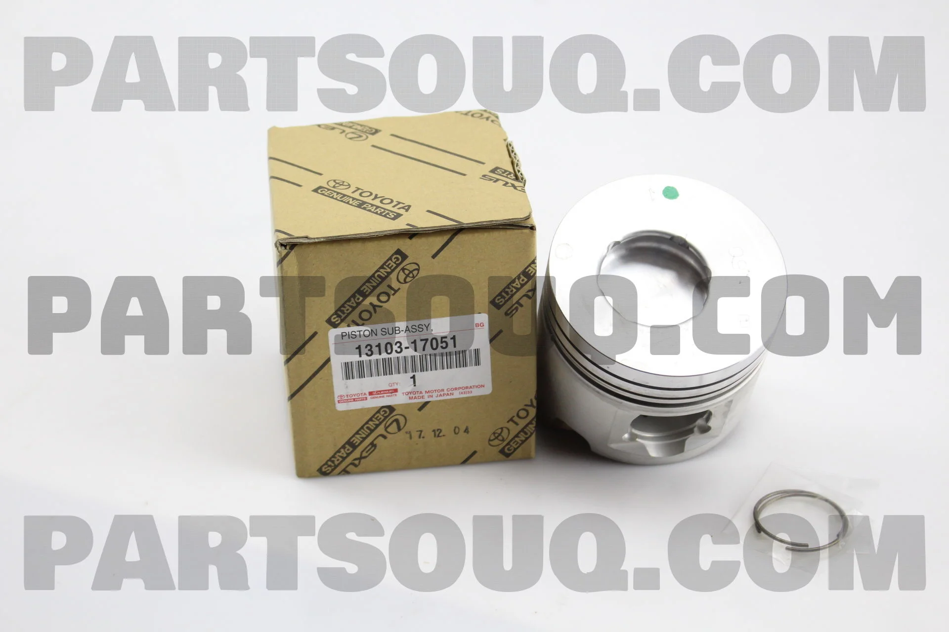

i know this is an old thread. the 90-92 and 93-94 pistons differences are well documented. what about the newest pistons available? from a 2002 Mexican hdj100 w/1hdt I find part number: 13103-17051 (O/S) this is different then the 13103-17040 number that a 93 shows. the piston ring number is also different..
does anybody know what the difference is? there are pictures of these pistons on the web but they look the same. possible they use thinner rings like the 1hdfte?
combustion bowl is the biggest difference
060
051
Other could be ring lands/groove width/casting differences/coatings/metallurgy.

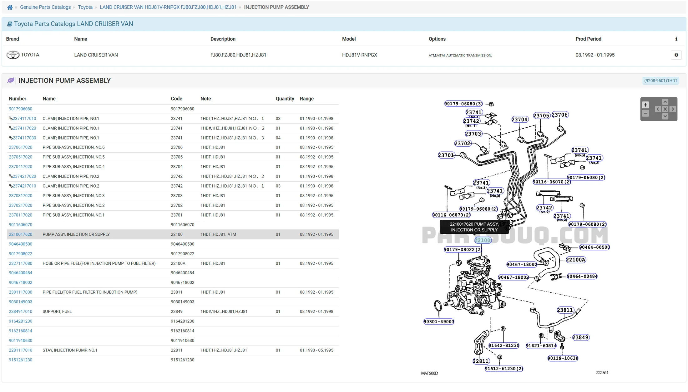

The 100 1HDT has 4 pump options, none of them match the 80 1HDT pump:
That shouldn't stop you from running them, although I'd be curious to see how the pumps differ.
Pump pressure, pulse duration vs injector breaking / opening point..
What I can tell in fact it's 1HD-T injectors are pretty capable of 200+ to the wheels .. while the pump will fall short sooner.

what are the 13103-17060 pistons from? they look like the 90-92 ones but different number.
looking at the pictures of 040 and 051 they look the same to me. I'm just thinking if you were to rebuild a 1hdt what would be that absolute best ones you could use? i would guess that the newest ones would be better. also possible they changed the weight to reduce the harmonic/cavitation issue on the bearings. just guessing here.
